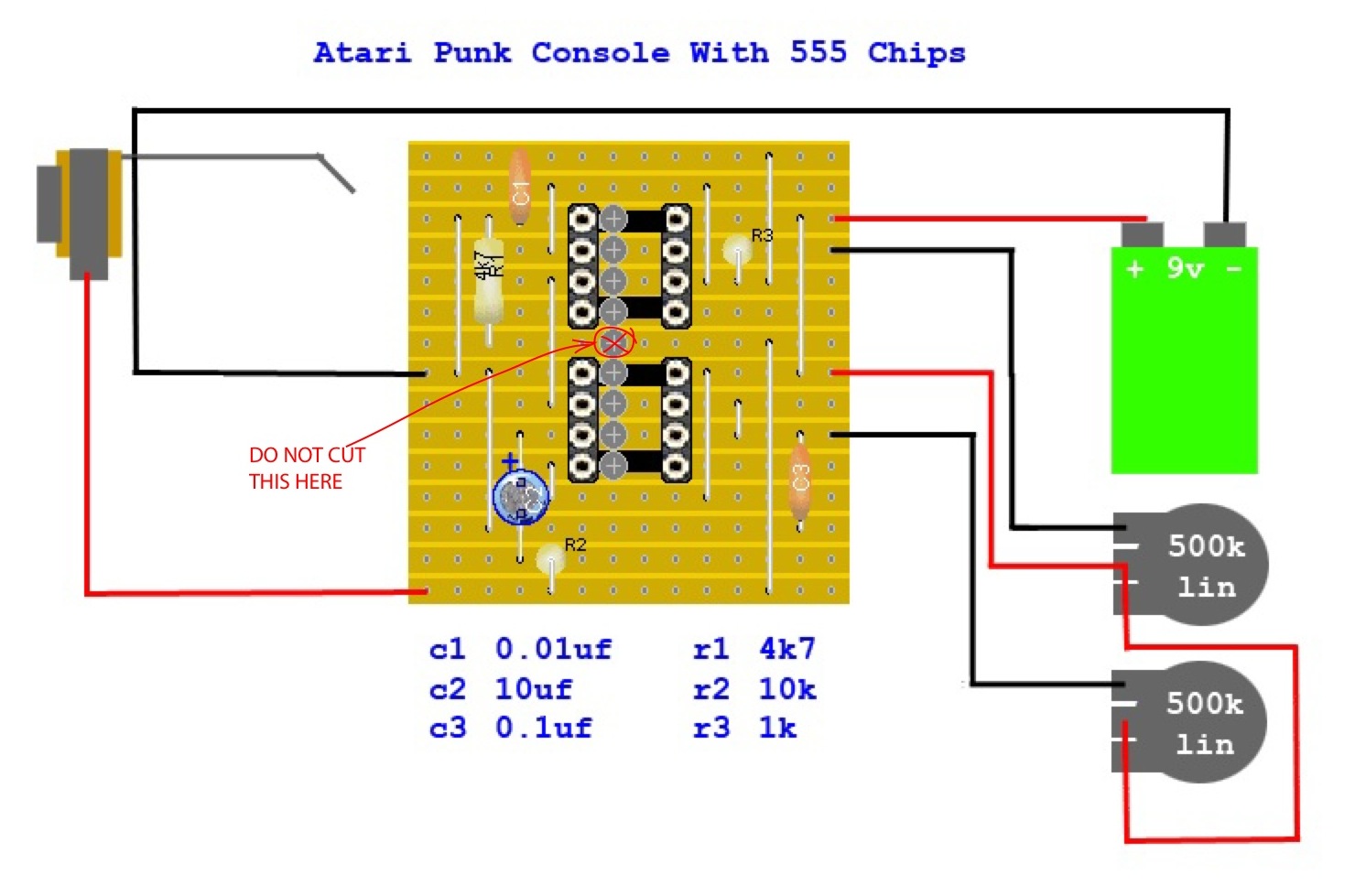

Hello guys!
I'm absolutely new in electronics, but I'm very interested in making DIY musical hardware. So i thought i should start with so called Atari Punk Console. I found this stripboard layout and tutorial
http://www.lushprojects.com/apc/lushprojects-atari-punk-console.pdf
I've followed every step trying to built one, but it doesn't work (LED shines but no sound). Then i found inadequacy --- layout shows 2 resistors, but in the Step 5 it clearly reads: "Put the four resistors on to the..." so maybe there is a mistake...? Could you guys anyone tell me is this layout I used is correct? Maybe you could post or link a correct and 100% working APC stripboard layout? (556 or dual 555 doesn't matter as long as it's working)
I also found these two different layouts:
http://electro-music.com/forum/phpbb-files/apc555_129.gif
http://www.aronnelson.com/gallery/main.php?g2_view=core.DownloadItem&g2_itemId=11028&g2_serialNumber=2
Any one of these are truly correct and fully working?
I would love to make this little noiser working so i could move on into electronics and make a sequencer etc...:)
Thank you in advance!

Hi VanaVara! welcome
I too had problems with this circuit. I never did get a 556 version working. What I did get to work is the second link you posted. There is a mistake on it though. You must NOT cut the stripboard track between the IC's.

PostPosted: Fri Feb 03, 2012 1:55 am    Post subject: Reply with quote  Mark this post and the followings unread
Yay, it's worrrrrking!

PostPosted: Fri Jan 11, 2013 5:16 pm    Post subject: Reply with quote  Mark this post and the followings unread
There also isn't one jumper: (+)9V power to IC1's leg 4. I'll add it and my apc is working.
I don't verified the stripboard below, but I check it some times and I think it's ok.
