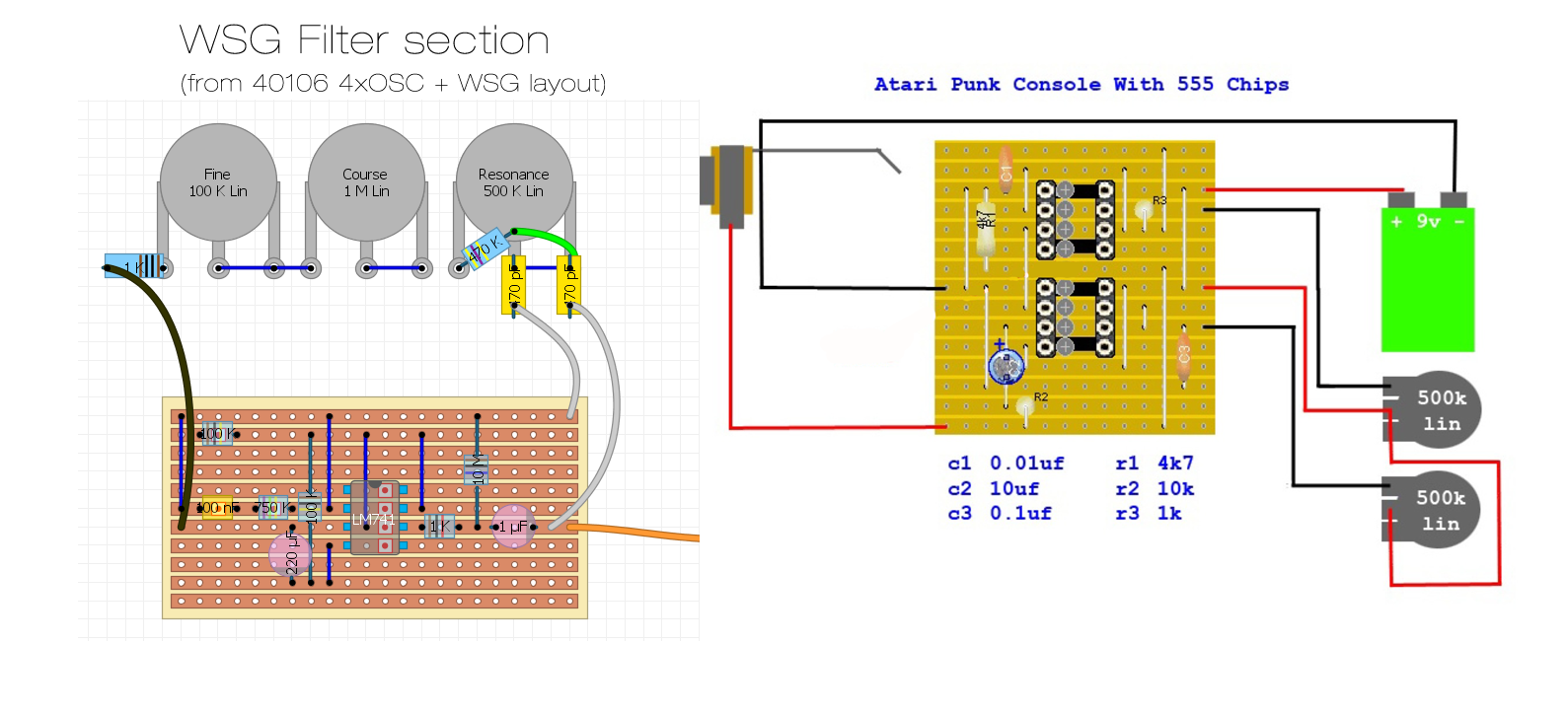

PostPosted: Tue Feb 14, 2012 1:55 pm    Post subject: Reply with quote  Mark this post and the followings unread
Hi again!
As minus suggests - take a look at the Lunetta forum for how to use these.
I took your suggestions and was reading Lunetta forum lately --- and i found few things i would like to build, these are Heterodyne Space Explorer and WSG Filter!
First of all i would like to build WSG Filter for my dual 555 Atari Punk Console to play around, found few layouts of WSG (as standalone and as a part of Space Explorer) and I would like to ask your help --- could you guys draw on the layouts how should i connect my APC with WSG? (see attached below) Does audio from APC goes to WSG instead of audio output? Should they both powered separately? What parts should be discarded? Sorry these are silly questions i know, but i'm very new into electronix...
A Baby 10 is a very simple sequencer. You don't need a kit to make one.
Maybe you guys could draw/link the stripboard layout for this Standalone Baby 8/10 with 555 clock , i'm not good at reading schematics yet... Embarassed
Thank you for your time, guys!
I really appreciate your help

PostPosted: Tue Feb 14, 2012 5:39 pm    Post subject: Reply with quote  Mark this post and the followings unread
nice choice! APC+WSGfilter are pretty much what i did and it sounds great!
no need for a drawing: the output of the APC goes to the INPUT of the filter (blue wire in my layout).
the black wire from the apc's output goes to GND of the filter.
or, you could wire up input and output jacks to the filter to keep the possibility for use with other gear.
Funny, this afternoon i added a 1/4 jack to my box to do just that Smile
i like your thinking with the sequencer: several BUSes to control several voices!

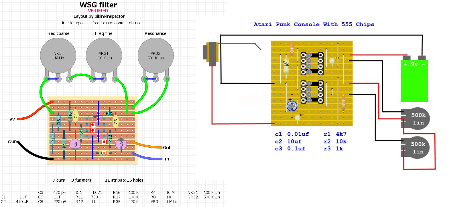

PostPosted: Wed Feb 15, 2012 1:18 am    Post subject: Reply with quote  Mark this post and the followings unread
So where does the GROUND comes from to WSG Output? (in your layout there is only one wire for Output shown)
This is more appealing option but even more complicated to me --- ok so APC doesn't change at all, but what about WSG --- it is powered separately (9V RED and Ground BLACK), but where does the Ground wire comes from to connect to Input and Output jacks --- same way as in APC, directly from battery?
In short, i'm confused about IN and OUT of WSG Filter, because only ONE wire for each is shown...

PostPosted: Wed Feb 15, 2012 8:03 am    Post subject: Reply with quote  Mark this post and the followings unread
hi
usually, in 9V circuits like these, only one wire is drawn. This is because when you wire up a jack, the second wire is always ground. (if not, you will be told)
It doesn't really matter where you take that ground from, it can be the battery or some place on the circuit board.
same goes for connections without jacks, but when you power 2 circuits from the same battery, the grounds ARE already connected (via the battery), so you would just have to wire up the signal wire.
i've added jacks to your drawing using the bottom row of the stripboard. As you can see, there is plenty of room for ground connections.

VanaVara wrote:
Thanx, bikini-inspector! Yesterday I build APC+WSG and it's working like a charm!
Now i would like to integrate LFO to this circiut to modulate APC Twisted Evil
I found this simple LFO layout: http://electro-music.com/forum/topic-30456.html
My question is --- how to connect this LFO to APC? Where does the LFO output goes to?
Check this out : http://www.getlofi.com/?p=3224
The Phoenix Vertigo is my Electronic alias. Check out my songs on soundcloud : http://soundcloud.com/charles-stieg/
bikini-inspector
Joined: Nov 29, 2007
Posts: 16
Location: bremen
PostPosted: Thu Feb 16, 2012 8:30 am    Post subject: Reply with quote  Mark this post and the followings unread
cheers defog, i will check that out, very cool!
but back to topic:
haha, well that sounds very familiar, check out my box http://vimeo.com/26630135
not sure where to connect the LFO on your APC, as i've built the 556 version.
in general, the apc offers 3 options:
modulate pitch
modulate pulse width
gate (this means as long as a voltage is applied to the reset pin, sound plays)
on the 556, the pins are 3 and 11 for CV and pin 4 for gate.
I'd suggest you just build the LFO and just poke the output around on the APC board to find the sweet spots.
and as always: why not connect these spots to extrenal jacks, so once you've built a sequencer, you can easily interface your stuff Wink
VanaVara
Joined: Jan 30, 2012
Posts: 23
Location: Vilnius
PostPosted: Thu Feb 16, 2012 10:23 am    Post subject: Reply with quote  Mark this post and the followings unread
Probably i'll take your suggestion and play around with LFO poking around APC as soon as i build one:)
