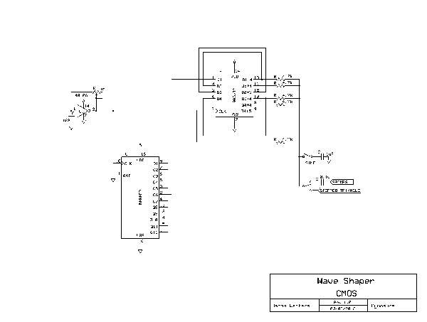

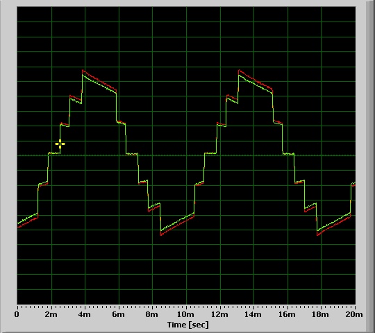

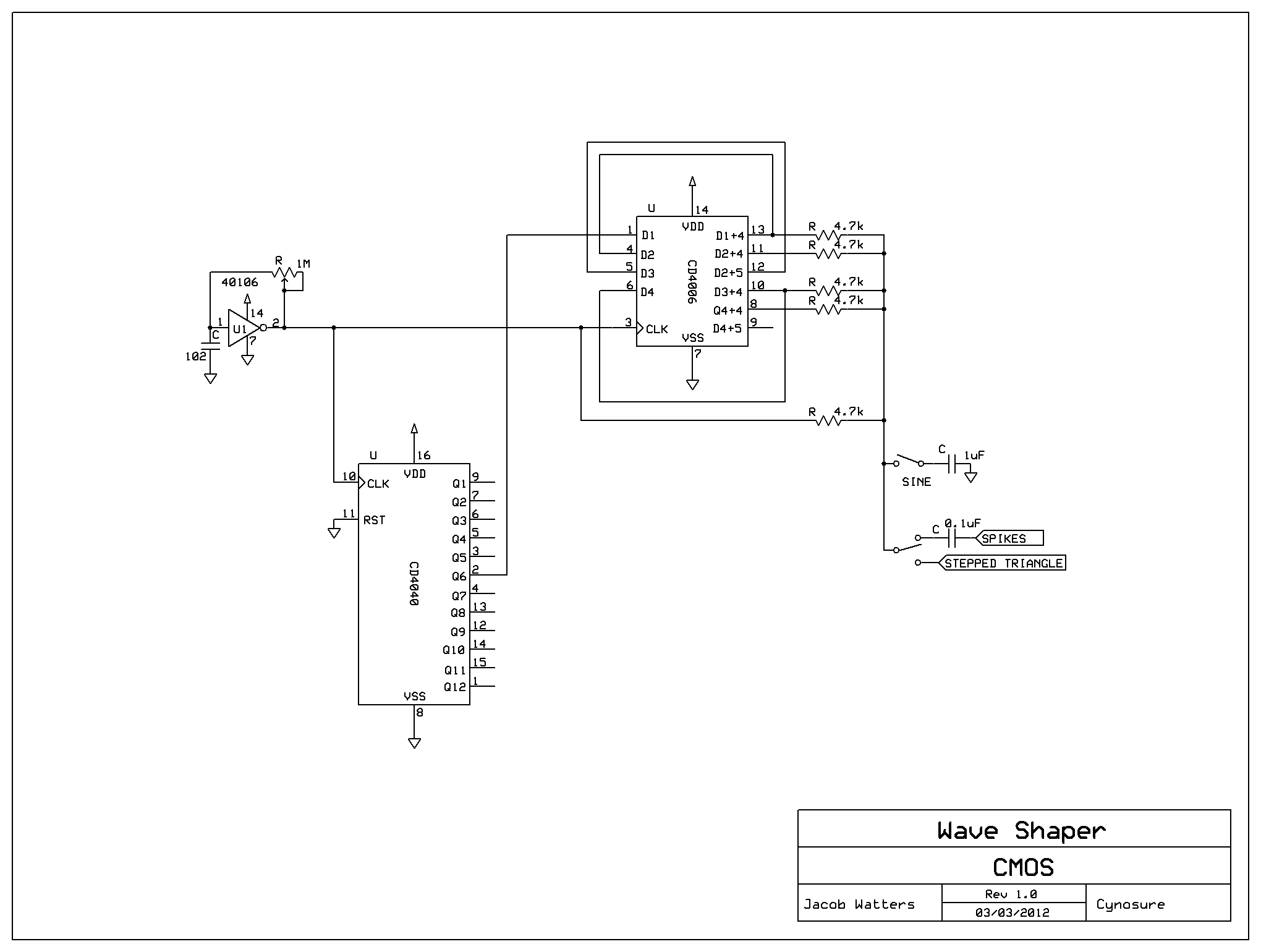

I am sure that there are similar schematics floating around the web and some people might have posted them here already, but I drew this up for myself and figured I would share it just in case someone else could use it.
The source sqaurewave could come from anything, but in my schematic it is a 40106 oscillator. It runs a little high and is used as the clock frequency for the shift register. The same signal is also divided with a 4040 and used as the base input for the shift register. I do this dividing so that the spacing of the steps changes along with the pitch.
I added a couple of option at the output for more shaping. A cap to ground rounds it off into a nice sine wave. Passing the sound through a low value cap acts as a highpass filter that turns each edge of the step into a spike.
You could probably do some really weird wave shaping by using separate low or highpass filters on each output from the 4006. This might almost allow you to draw the desired waveform with a bit of practice.

Cynosure, that looks very nice, especially those spikes Smile. Does it perform with other input signals as well, or is it square in only?

Sodium - It might work with other waveforms if the peaks go over the CMOS threshold, but I think for optimal performance you will want to use a comparator to create a squarewave if you are using a different wave as the source.
Sonic - I was actually thinking about your vco when I was making it. It would be a cool module.
I was playing around with it today adding more or less of the shift register outputs, and changing the mixing resistors for diodes or small caps. You can make some very unique waveforms, but it is kind of difficult to predict how it is going to look and sound until you test it out.

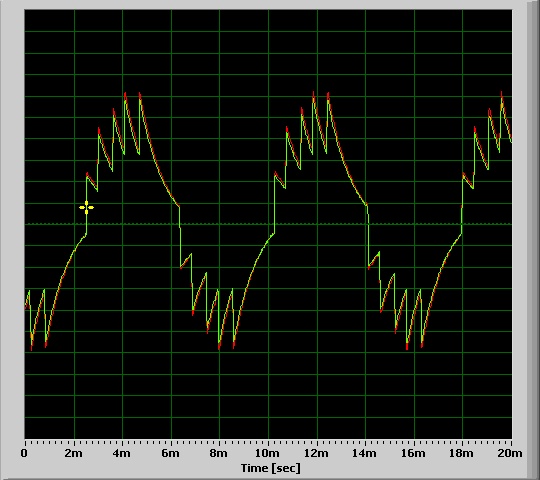

I also just created a similar stepped saw wave. I will make the schematic and post in a couple of days, but it is just a 4017 that has a different valued resistor on each output. Q1 has low resistance, Q9 has a lot of resistance, and Q10 isn't connected.

Isn't it easier to get that saw wave from an R2R ladder and a 4040? Acctually probably about the same effort/parts are required for each.

Maybe, but this is the idea I came up with. If you have another method, then please share.
I think it might be useful to put sliding pots on each output of the 4017 instead of fixed resistors. Then you could literally draw out any 10-bit waveform on the sliding pots.
Then add switchable highpass and lowpass filters to either smooth it out or make spikes.

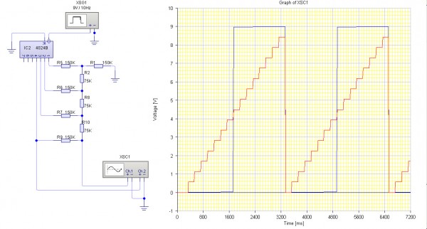

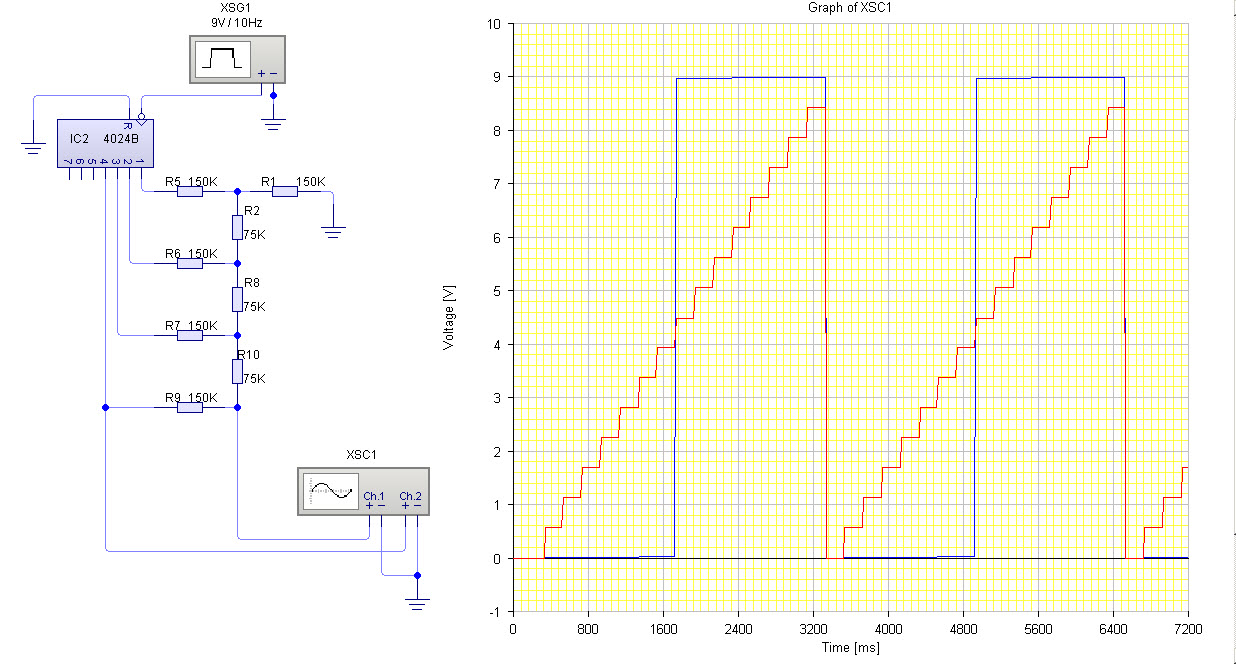

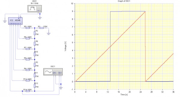

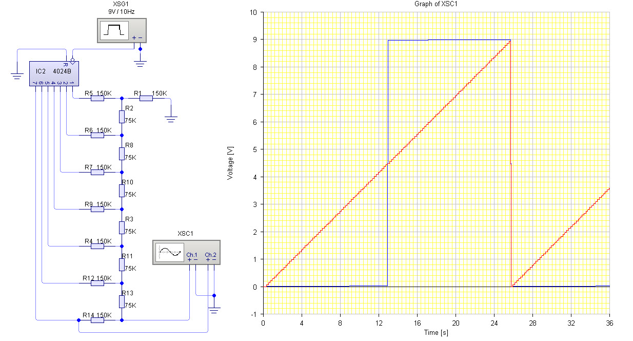

128 steps staircase generator ; an R/2R ladder network and a 4024 .

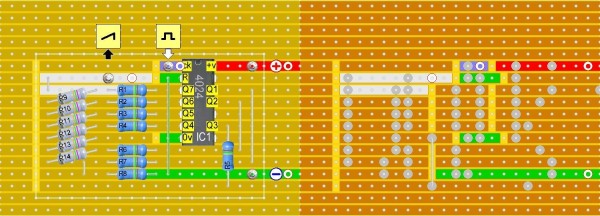

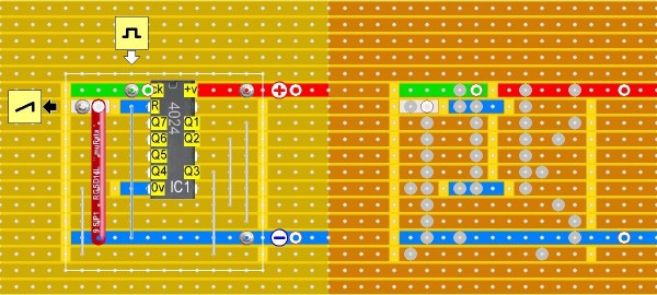

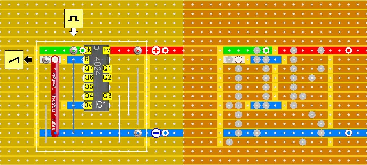

4024 7b ramp oscillator stripboard (veroboard):

Can I substitute different resistor values? 150k and 75k are odd values that i do not have in quantity.
Would 47k and 100k work?

The ratio is important: R/2R. 47K is half of 100K, minus 6%. With an error of 6%, your error term is as large as your fourth bit (1/16th == 0.0625, ~6%). That means that you may as well only build a three-bit R/2R ladder.
See https://en.wikipedia.org/wiki/Resistor_ladder#Accuracy_of_R-2R_resistor_ladders

but 47k and 94k (ie, 2 x 47k in series) would work...[/left]

Consider to use only 100k resistor. 2x100k in parallel = 50k.
Accuracy of R-2R resistor ladders for 7 bits is 1/127=0.79%
Discrete resistor should be 0.5% tolerance.

Ok, so if I were to make it i would need to by resistors with better tolerance anyway, so i can get the same values.

Yeah, this is the way to go. Especially easy if you've got a bin full of 100k 1%'s.
