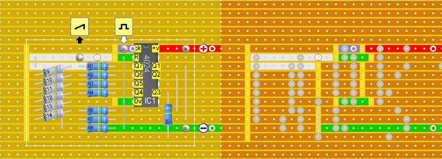

4024 7b ramp oscillator stripboard (veroboard):

Can I substitute different resistor values? 150k and 75k are odd values that i do not have in quantity.
Would 47k and 100k work?
The ratio is important: R/2R. 47K is half of 100K, minus 6%. With an error of 6%, your error term is as large as your fourth bit (1/16th == 0.0625, ~6%). That means that you may as well only build a three-bit R/2R ladder.
See https://en.wikipedia.org/wiki/Resistor_ladder#Accuracy_of_R-2R_resistor_ladders

Location: cleve
PostPosted: Wed Mar 07, 2012 6:07 pm    Post subject: Reply with quote  Mark this post and the followings unread
but 47k and 94k (ie, 2 x 47k in series) would work...[/left]

PostPosted: Thu Mar 08, 2012 3:51 am    Post subject: Reply with quote  Mark this post and the followings unread
Consider to use only 100k resistor. 2x100k in parallel = 50k.
Accuracy of R-2R resistor ladders for 7 bits is 1/127=0.79%
Discrete resistor should be 0.5% tolerance.

PostPosted: Thu Mar 08, 2012 6:42 am    Post subject: Reply with quote  Mark this post and the followings unread
Ok, so if I were to make it i would need to by resistors with better tolerance anyway, so i can get the same values.

PostPosted: Thu Mar 08, 2012 11:13 am    Post subject: Reply with quote  Mark this post and the followings unread
Yeah, this is the way to go. Especially easy if you've got a bin full of 100k 1%'s.
