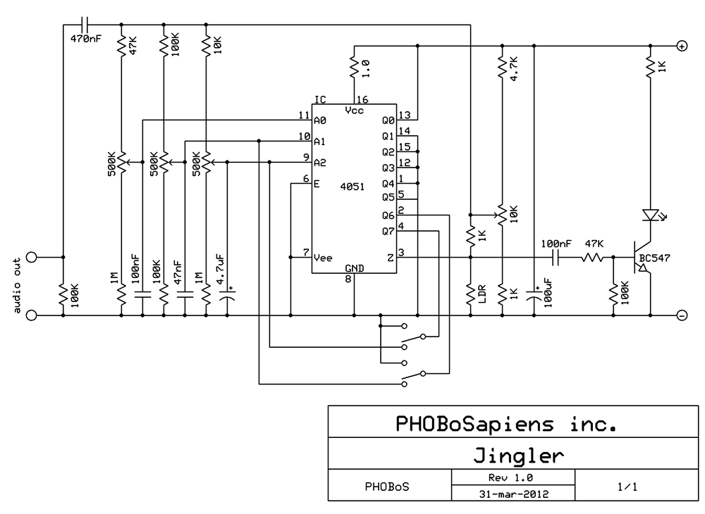

I can think of more complex ways to do this but this works and is easier Smile
http://electro-music.com/forum/post-349052.html#349052I found the thread which inspred this too Very Happy thanks spacebones!
Forgot to add, output is from "X".
Other inputs are not connected, connecting only A means that only Y0 and Y1 are in operation. All other inputs will not be connected to the output.
 Filesize:  35.93 KB

nice idea, played around a bit with it and ended up with a circuit I called the Jingler Wink
I noticed the sound depend a lot on the powersupply, it likes it a bit dirty, so that's why I put in a 1 ohm resistor.
Don't place a decoupling cap over the chip! you can experiment a bit with the values to get some different sounds
but I'll leave it like this. I used a HEF4051 chip myself, I have no idea if it will work and how it will sound with another chip.
might record some sounds later.

That is brilliant Laughing ... I have a circuit named after my username Shocked I feel like a professional now!!! Thankyou!
Can we get some further explanation of the operation of your circuit please?
Mine is simple, A switches between Q1 and Q0, or Y1 and Y0 whatever you want to call them; the first two inputs/outputs. It switches X (the common output) to Q1 when A is 1 and Q0 when A is 0, so I just connected Q0 to 1 (or high) and Q1 to 0 (or low), then X to A. This produces very very very high frequency oscillation, the CR network merely causes a delay as the cap charges/discharges giving you a slower oscillation.
I couldn't get this to work again, probably because my supply was nice and clean Laughing
LOL, ehmmm
well I took your idea and used that on the other inputs aswell, so I have
A0 oscillating with Y0, Y1 (when A1, A2 are low)
A1 oscillating with Y0, Y2 (when A0, A2 are low)
A2 oscillating with Y0, Y4 (when A0, A1 are low)
I added one side of the pots to ground with a resistor because this seemed to give some wider range on the pots.
But most of it is just done by experimentation and I have no idea what's really happening. (I think the 4051 doesn't know what's happening to it either Laughing )

P.S. I think there may be a mistake in your diagram; should A0 be connected to Y1?
hmm, no I don't see any mistakes except for a dot missing on the ground connection of pin5.
but,..
I couldn't resist trying some oscillators attached to some of the Q/Y pins = more fun Shocked

I just finished the jingler and as I kinda expected it sounds nothing like it did on breadboard Rolling Eyes , but it still makes some noise.
I did add a 100 ohm pot for starve (wish I did that before I finished it and put it on the panel), but that still doesn't give me all those nice sounds.
I might replace the 100uF cap, I know it made a huge difference what size cap I used on the breadboard.
btw modulating pin 1 has a very prominent effect so I added an extra jack for an external CLk. (using the switch contact on the jack
to change from the internal LFO to external)
anyway, here's the 'final' schematic, you can always expand and change whatever you like off course,
and a photo. (I'll post 2 more in the 2012 build thread).
Idea hmm, I just realized I haven't tested with the same PSU I used when breadboarding. And I think there migth be
something wrong with that one causing the voltage to fluctuate more than usual.
Which makes me think of making a LM317 based supply but adding some kind of noise source so the voltage will vary

Unfortunately I can't get the damn thing to work again, well it for a bit, but its so unstable I can't make it work. I'm glad someone got a good circuit out of this idea though Wink
The circuit oscillated better when I disconnected the potentiometer (refering to my initial diagram). Rolling Eyes

I wanted to reply sooner but got distracted by a new VCO design
I did get it to jingle again,. allthough not sompletely the same as breadboarded.
my first idea was to make a varying supply voltage for the 4051 chip so I wired up
a semi random generator used to turn a transistor on/off which switched the supply voltage.
I also added a cap and some extra biasing resistors so it would produce a smooth voltage.
It kinda worked and I thought instead of the random generator it might also be fun to use
a combination of the modulators. So I detached the random generator and to my
surprise it still kept "jingling". So I soldered just the transistor resistors and cap onto
the jingler PCB (there was a bit of of room left), turned it on and,... Crying or Very sad
After that I had to do a lot of experimenting to find out why it didn´t work and
eventually ended up with adding an extra wire to the DC input just to power the chip scratch
I did record some sounds but it´s ± 100min right now so I might have to edit it a bit,
however I just posted something else which includes some jingler sounds too, here.
