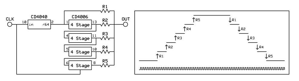

o and I couldn't resist redrawing the schematic a bit so you can see a bit more clearly what the 4006 does Cool
Cynosure's CMOS Wave Shaper - block schematic by PHOBoS

Thanks for that schematic Phobos. Much easier to read what it does.

Thanks for the diagram and for the
4067
Phobos Wink
I love block diagrams, they are so easy to understand Very Happy

well I couldn't hold back any longer and just breadboarded it.
first thing I changed was removing the resistor attached to the CLK input since this only adds
the source frequency which is rather high (unless you're using it as an LFO).
instead add a resistor to the input of the 4006 (pin 1)

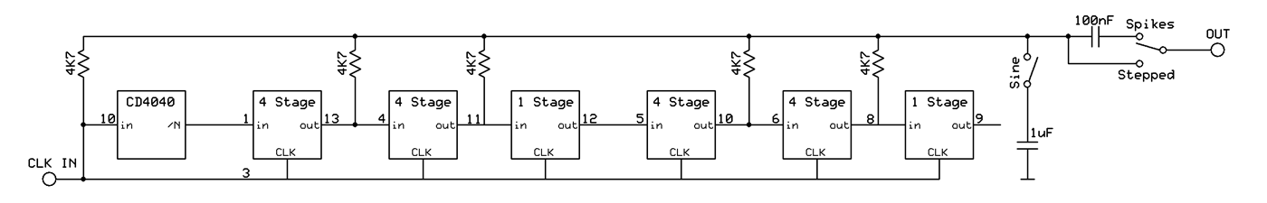

Cynosure wrote:
I didn't try when I had it bread boarded, but I wonder what it would do with the 1 stage outputs added to the mix. Maybe add 2 more steps that aren't as wide?
yep that's what it does,. so I added resistors to both pin 12 and pin 9 for some extra steps.

edit:
here's a schematic + waveform and a nice scopeshot, this should clear things up a bit more. Cool

and here's another one with the 1-stage shiftregisters added, not completely to scale since the total amplitude remains the same.
