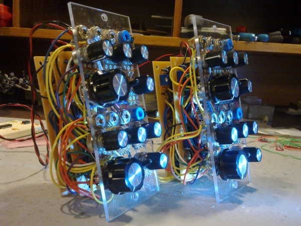

I had twins (oscillators that is...)!
My first proper oscillator: a dual, variable pulse/ramp variety with plenty of in's and out's.
The core is based off of Ray Wilson's 'variable skew lfo' and was then completely bastardized for audio rate use, +/-4.5V rail power, and adapted for my control scheme (current control). I tacked on a cross fader to mix between the pulse and ramp waveforms and added an amplifier before the output (basically a vca...).
Controls row by row:
Row 1: Control signal out, Frequency control input, Amp. control input, Audio out
Row 2: Control out level/depth, Amp. gain, Waveform mix
Row 3: Frequency control, Frequency range (low, med, high), Wave tilt/pulse width
I was shooting for something along the lines of a buchla 258, and was happy with the way this design came out; lots of great fm and cross-mod opportunities!
Fun fact: there are four vactrols (hand rolled) per oscillator, so eight per module, or 16 between the two!

Adam, congrats on having proper VCOs and they look great. Cool
