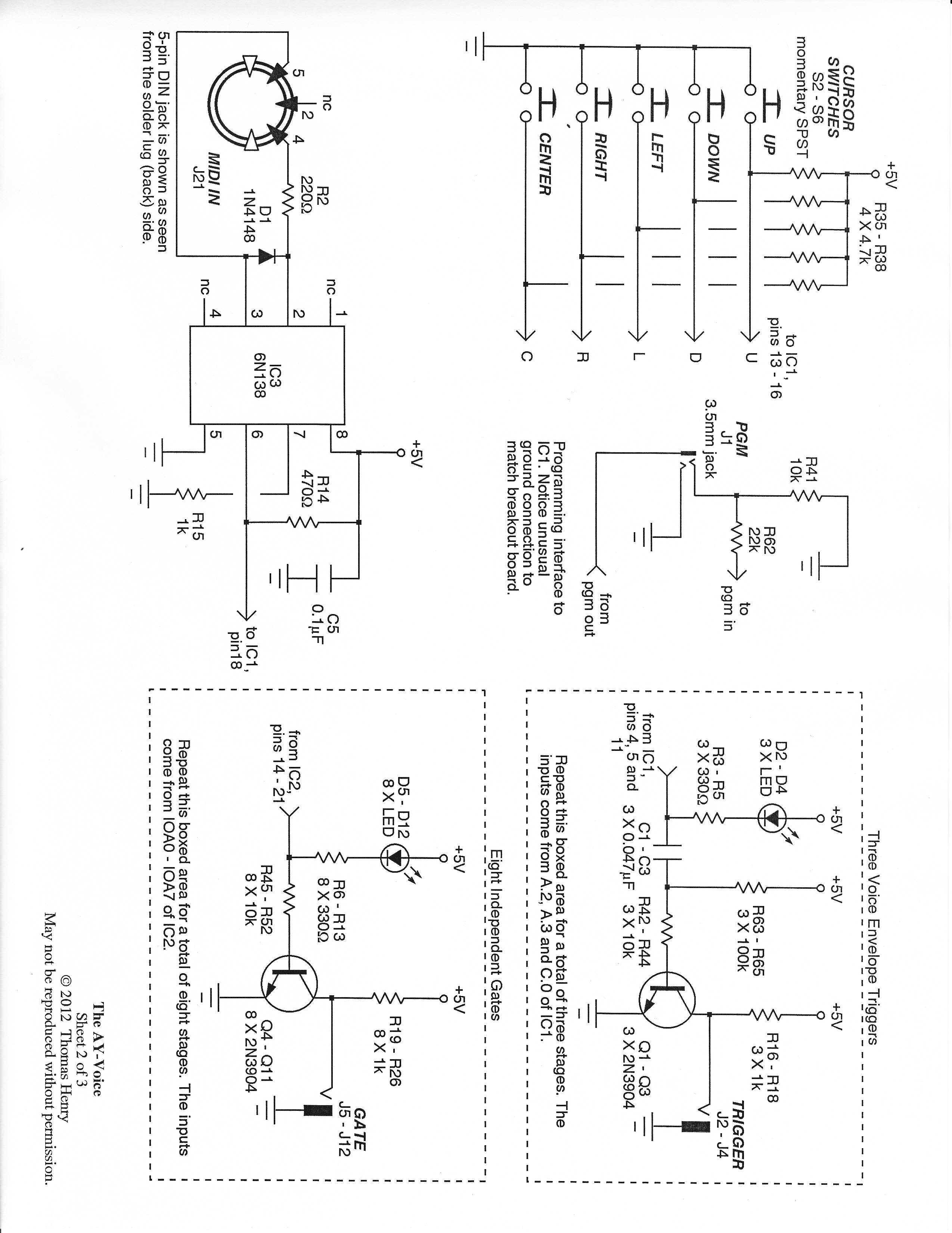

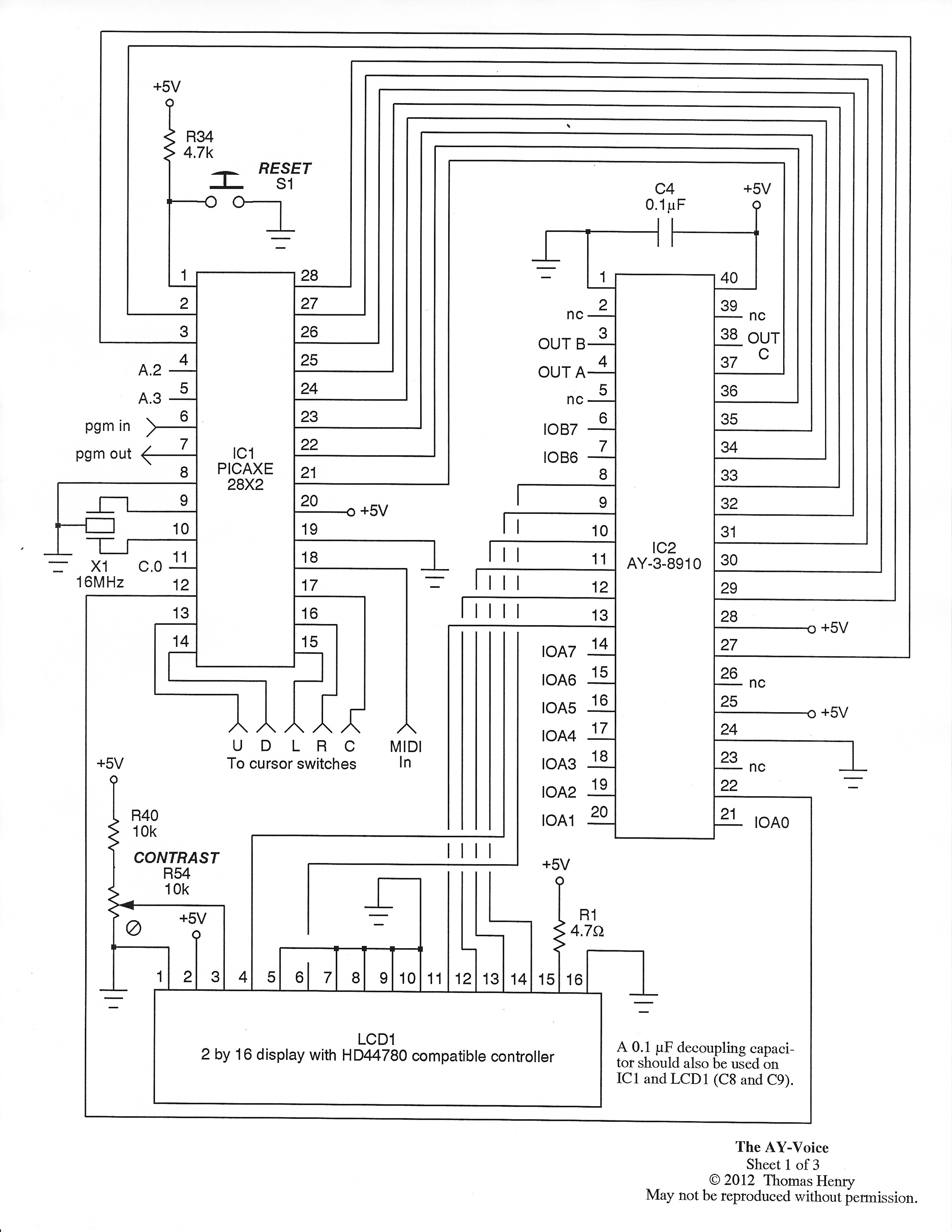

Hi again,
I had originally thought to use DC coupling throughout the audio path. It turns out the bias voltage on the output is not fixed as I had thought, so DC coupling won't work. Attached are the updated schems which now include AC coupling. While I was at it, I fixed a few typos in the schems as well.
And if it isn't clear, the break-jacks allow you to inject filtering or other effects if desired. The voltage levels are the usual 10Vpp.
Thomas Henry
Sheet 1
 Filesize:  1.1 MB
 Viewed:  651 Time(s)
Sheet 2
 Filesize:  1.06 MB
 Viewed:  635 Time(s)
Sheet 3
 Filesize:  962.9 KB
 Viewed:  644 Time(s)

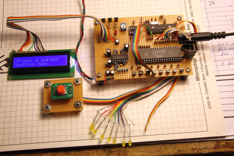

PostPosted: Sat Jun 23, 2012 7:44 am    Post subject: AY-Voice perfboard Reply with quote  Mark this post and the followings unread
Just received my PicAxe IC and perf boarded it up...works great! I have attached a tweaked version of the ay_switch demo so that it would run on my AY at 64MHz. I have also attached an octave sweep program as well.
I used the Parallax 5 position switch (mini joystick) instead of the 5 separate switches.
Thanks again Thomas!
Theff

PostPosted: Sat Jun 23, 2012 8:01 am    Post subject: Reply with quote  Mark this post and the followings unread
Wow, that's beautiful work. My perf/proto boards are usually FAR messier...I don't have your experience of course, but that's a great target for me to tshoot for.
Dan Lavin
Joined: Nov 09, 2006
Posts: 649
Audio files: 21
PostPosted: Sat Jun 23, 2012 10:08 am    Post subject: Reply with quote  Mark this post and the followings unread
THeff,
I agree with elmegil, very nice work! I have my AY chip too, but I'm a couple projects behind in the project queue. I hope to join in sometime yet this summer. Really looking forward to seeing how Thomas' firmware ends up. I'm sure the rest of the crew here will come up with some interesting mods, too.

PostPosted: Sat Jun 23, 2012 11:01 am    Post subject: Reply with quote  Mark this post and the followings unread
Thanks elmegil & Dan,
Those AY-3-8910 chips have been stored away since the 90s just waiting for the right application. It took Thomas to light the fire and get me to finally use them. I am planning to do some chords next and link it to MIDI.
Like Dan said I am anxious to see what other people have in mind with their AY.
