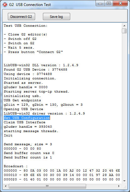

I have a amd64 system also, windows7, but I'm not having any trouble with libusb-win32. I know libusb-win32 is giving a bit of trouble with some systems, sometimes trying another version of libusb helps.
It's impossible for me to try out all configurations and libusb is a black box for me also, but I made a little diagnostic tool, maybe we can help each other out a bit to post here wat versions work depending on os / cpu.
So the diagnostic tool just shows the log when setting up the usb connection and when all goes well downloads the startup data from the g2. In some cases the setup hangs at the "set USB configuartion" stage, in that case try another (newer) libusb-win32 version.
To try the tool, the clavia driver should be installed already on your system and you should have installed the libusb-win32 as a filter driver on the clavia driver, just the same as you need to do for using the nmg2 os editor.
