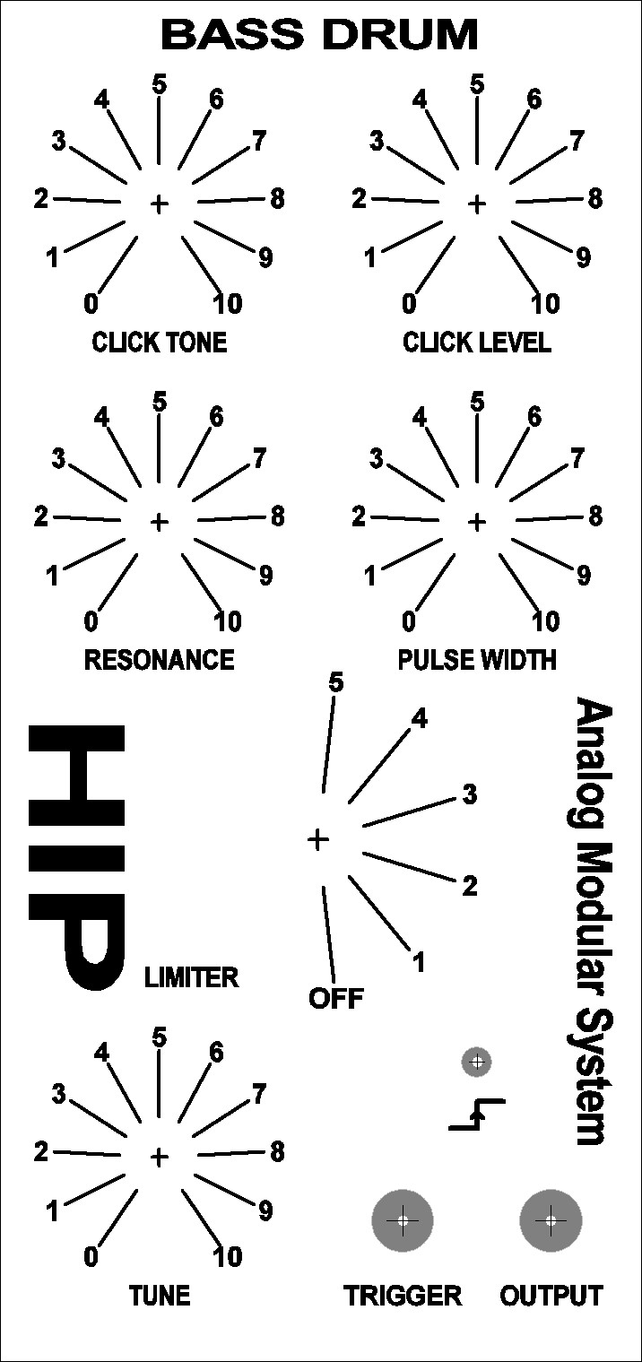

KRS1972
Joined: Sep 27, 2012
Posts: 38
Location: Amsterdam
PostPosted: Thu Oct 18, 2012 11:01 am    Post subject: Reply with quote  Mark this post and the followings unread
Hello !!
HIP Bass Drum, that sounds good to me.
Good article and thanks for the layout.
This is what I made off it so far, ready to ets the pcb board and make the front panel.
Grt,
Chris
 Filesize:  40.41 KB
 Viewed:  3418 Time(s)
 Filesize:  151.91 KB
 Viewed:  1230 Time(s)
