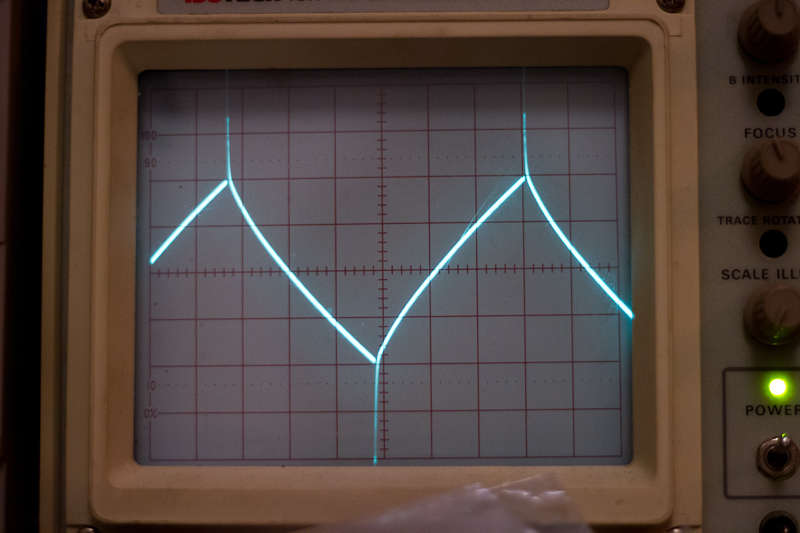

PostPosted: Thu Dec 06, 2012 2:12 am    Post subject: Reply with quote  Mark this post and the followings unread
Ok, I have managed to stabilise one by replacing the power electrolytics (at least it looks ok on the scope for now)... I'm wondering, Can I put a higher value electro-cap in place of the 10µF (say 100µF)? Would that be more robust against dirty power, or would a higher voltage tolerance prove more robust? I currently use 10µF, 63V.
Anyway, the other issue still seems evident (particularly noticable on the triangle - I've only tested that and the saw so far). I still seem to have those rogue tails, as pictured below - are they normal?

PostPosted: Thu Dec 06, 2012 2:30 am    Post subject: Reply with quote  Mark this post and the followings unread
100uF would be okay also, gives you another filter band.
you said you already replaced the electrolytics. did you use another value, too? did you buy these elecs new, or are thay old stock?
BTW the voltage limit does not matter.
no, not normal.

Ok, I'll stick in 100µF, see if that helps, or works any better... They are new (within a year old)
no, not normal.
Hmm, question is, what would cause it, and how to sort it? Maybe the bigger power caps might solve it. I'll report back once they are in...

PostPosted: Thu Dec 06, 2012 7:15 am    Post subject: Reply with quote  Mark this post and the followings unread
I tried 100µF electro caps, but didn't really make any difference... As for stability, it is no longer jumping all over the place, but there are slight fluctuations over time. I can see the movement on my scope, but I need to get it up on a frequency counter to see how serious it really is..
Still no idea what causes the spikes...

PostPosted: Thu Dec 06, 2012 6:30 pm    Post subject: Reply with quote  Mark this post and the followings unread
Ok, I've had this running on my bench all day, and on the bench PSU it has gone back to the random pitch problem. So, there is a problem somewhere in the power circuitry, but it doesn't appear to be the PSU causing it.
So, replacing the 10µF electro-caps solved the problem temporarily, but what could cause it to go back to the random pitch issue?

PostPosted: Fri Dec 07, 2012 12:31 pm    Post subject: Reply with quote  Mark this post and the followings unread
Is there a schematic for this somewhere publicly viewable?
When changing the 10 µF capacitors cures the problem but it comes back after a while .. what is the voltage rating for the capacitors and what voltage are they working on?

PostPosted: Fri Dec 07, 2012 12:56 pm    Post subject: Reply with quote  Mark this post and the followings unread
fonik wrote:
what i got is that LektroiD used 63V rated...maybe i was wrong?
Ah ok, I did read back a bit but missed it apparently.
They are not put in backwards either? Some electrolytics have confusing polarity indicators.

PostPosted: Fri Dec 07, 2012 1:06 pm    Post subject: Reply with quote  Mark this post and the followings unread
Regarding the overshoot on some of the wave forms .. that seems to be by design ... http://www.birthofasynth.com/Thomas_Henry/Pages/X-4046.html#Forming_The_Triangle_Wave .
