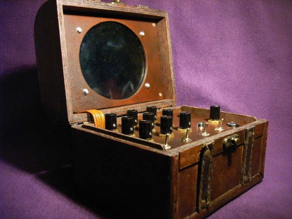

RingMad wondered how I achieved the fading on the audio for the Enneatronic Spectralizer so here's
the schematic and some extra info for those interested.
THE ENNEATRONIC SPECTRALIZER
The Enneatronic Spectralizer is a drone box containing 9 tunable squarewave oscillators with a
simple, 1 transistor, VCA section to fade the sound of each oscillator in and out. The same oscillators that
control the VCA's also control 42(!) LED's, arranged in such a way that it creates a constantly changing
display of symmetrical patterns.
thanks for posting that pic richardc64 Wink
The oscillators are all made with a CD40106 (3 chips in total) combined with some resistors, capacitors and
transistors to create the fading effect for both sound and LED's. Values were selected by means of experimentation
to get the result I was happy with. So if you want to use the circuit with a different supply voltage you'll probably
have to change some values. The fading of the LED's also varies with the kind of LED's used, so this will need
some experimentation aswell.
Each group of 3 oscillators (build around a single CD40106) also has a switch to turn the sound off. This makes
tuning a bit easier but can also be used to switch between differently tuned drones. The tuning itself is done
with a 47K pot (fine) in series with a 250K trimpot for pretuning (coarse). Originally the circuit was made with
just the 250K trimpots, but it was difficult to tune them pecisely so I added the 47k pots in series and
pretuned them to a low, mid and high section.
The sounds of the oscillators are mixed together with an opamp and then send out to a jack, which is wired up
in such a way that it can also be used as an EFX Send/Return for the build in amplifier. The amplifier itself is a
very basic LM386 setup. The 65Ω speaker was just something I had laying around that was small enough, so it
doesn't have to be 65Ω. Wink

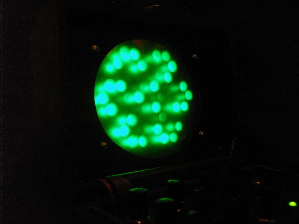

some extra info on the display:
- directly in front of the LED's there's a layer of frosted plastic to diffuse the light a bit. (cut from a box that came with some VHS tapes).
- on top of this is a blue lighting filter to dim the lights. (42 bright green LED's produce a lot of light! Shocked )
- followed by a green lighting filter which together with the blue creates a very nice shade of green.
- this is covered with a piece of perspex to protect it which also functions as a mirror if you turn the LED's off (bonus effect).
because there is some space between the LED's and the plastic it creates a sort of 3D effect were the brighter LED's
seem closer then ones that are dimmed. Laughing
(I added a photo which shows this a bit)

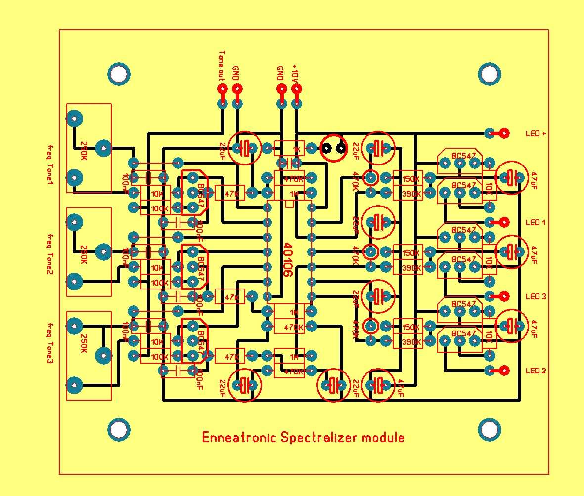

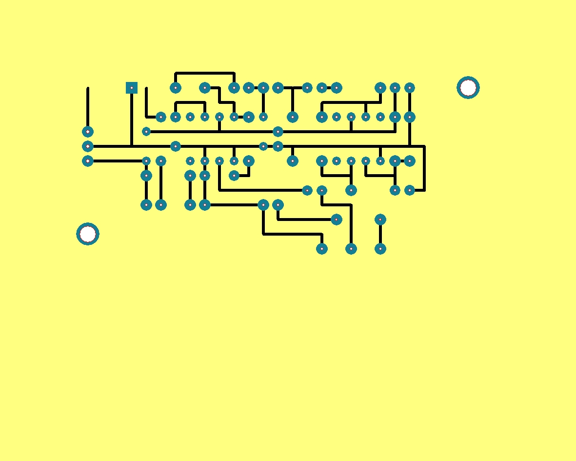

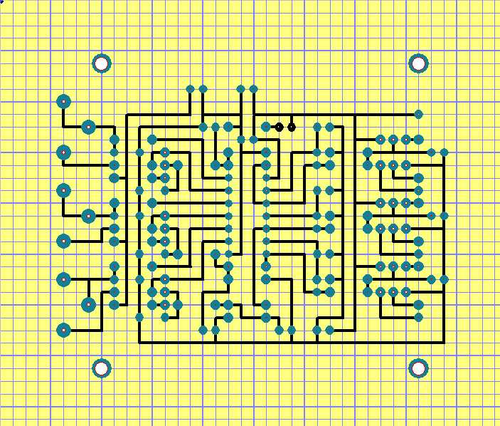

Here's the original perfboard layout for the modules
I made 3 of those and later added the 47K pots. I soldered those to the edge of the boards as can be seen on this photo:
(I had to cut a small part off to get them in the box)
The 47K pots are connected instead of the connections between the 250K trimpots and 10K resistors using some wires.

Enneatronic Spectralizer module layout (traces + grid)
as seen from the top, so it's mirrored from the actual layout

Hi Phobos,thank you very much for all this information!!!! we certainly encourage everyone to help build this fantastic machine.
You really are the master! Very Happy Very Happy Very Happy I expect good hours of entertainment and fun ... Laughing
Question: what is the resistor 1k and cap value and what is red circle on top of the circuit? its a led? i think its a led red and the cap its a 100nf on schema..ok?
Thanks again !!! when I have something done .. I will keep you informed.
What is the cap value and what is the red circle?led?

The cap is a decoupling cap (I usually don't label those, nor draw them in schematics Rolling Eyes) so 100nF would be fine.
And the circle is indeed a (3mm) LED, which simple shows if the PCB is powered, so you can leave that and the 1K resistor off the board. Cool
