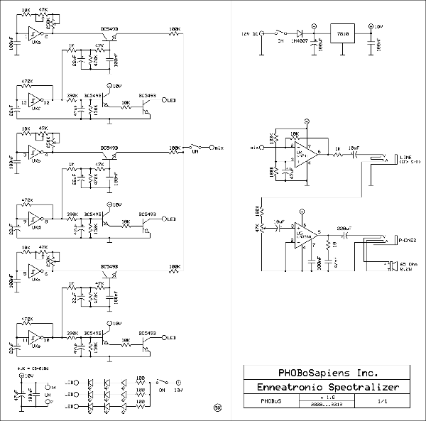

RingMad wondered how I achieved the fading on the audio for the Enneatronic Spectralizer so here's
the schematic and some extra info for those interested.
THE ENNEATRONIC SPECTRALIZER
The Enneatronic Spectralizer is a drone box containing 9 tunable squarewave oscillators with a
simple, 1 transistor, VCA section to fade the sound of each oscillator in and out. The same oscillators that
control the VCA's also control 42(!) LED's, arranged in such a way that it creates a constantly changing
display of symmetrical patterns.
thanks for posting that pic richardc64 Wink

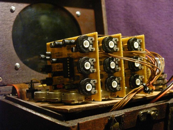

The oscillators are all made with a CD40106 (3 chips in total) combined with some resistors, capacitors and
transistors to create the fading effect for both sound and LED's. Values were selected by means of experimentation
to get the result I was happy with. So if you want to use the circuit with a different supply voltage you'll probably
have to change some values. The fading of the LED's also varies with the kind of LED's used, so this will need
some experimentation aswell.

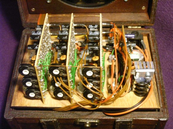

Each group of 3 oscillators (build around a single CD40106) also has a switch to turn the sound off. This makes
tuning a bit easier but can also be used to switch between differently tuned drones. The tuning itself is done
with a 47K pot (fine) in series with a 250K trimpot for pretuning (coarse). Originally the circuit was made with
just the 250K trimpots, but it was difficult to tune them pecisely so I added the 47k pots in series and
pretuned them to a low, mid and high section.
The sounds of the oscillators are mixed together with an opamp and then send out to a jack, which is wired up
in such a way that it can also be used as an EFX Send/Return for the build in amplifier. The amplifier itself is a
very basic LM386 setup. The 65Ω speaker was just something I had laying around that was small enough, so it
doesn't have to be 65Ω. Wink

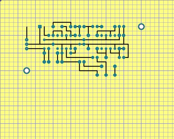

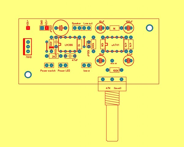

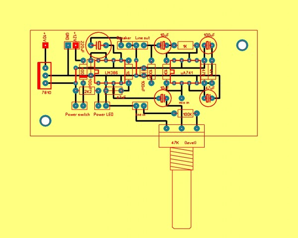

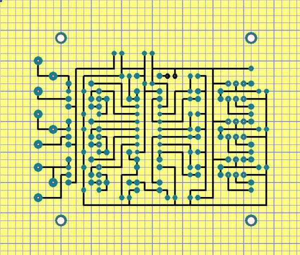

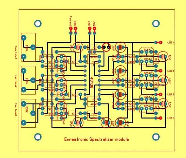

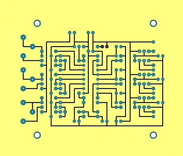

Here's the original perfboard layout for the modules
I made 3 of those and later added the 47K pots. I soldered those to the edge of the boards as can be seen on this photo:
(I had to cut a small part off to get them in the box)
The 47K pots are connected instead of the connections between the 250K trimpots and 10K resistors using some wires.

as seen from the top, so it's mirrored from the actual layout
 Filesize:  91.99 KB
 Viewed:  700 Time(s)

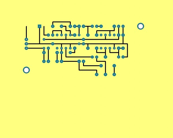

the green wires are the connections to the 47K pots.
 Filesize:  116.74 KB
 Viewed:  680 Time(s)

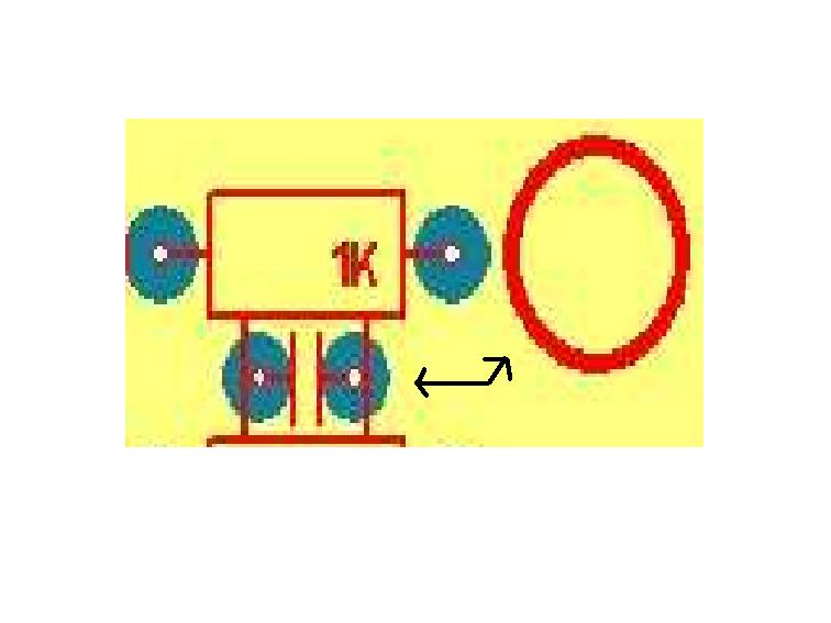

Hi Phobos,thank you very much for all this information!!!! we certainly encourage everyone to help build this fantastic machine.
You really are the master! Very Happy Very Happy Very Happy I expect good hours of entertainment and fun ... Laughing
Question: what is the resistor 1k and cap value and what is red circle on top of the circuit? its a led? i think its a led red and the cap its a 100nf on schema..ok?
Thanks again !!! when I have something done .. I will keep you informed.
What is the cap value and what is the red circle?led?
 Filesize:  28.9 KB
 Viewed:  678 Time(s)
Posts: 5929
PostPosted: Mon Jun 02, 2014 10:34 am    Post subject: Reply with quote  Mark this post and the followings unread
The cap is a decoupling cap (I usually don't label those, nor draw them in schematics Rolling Eyes) so 100nF would be fine.
And the circle is indeed a (3mm) LED, which simple shows if the PCB is powered, so you can leave that and the 1K resistor off the board. Cool

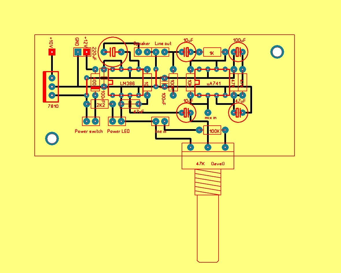

Hello everyone Very Happy , this is an approximation of the Phobos Eneatronic Spectralizer. PCBs in pdf, one is the actual view and another the pcb.
I also included the power supply and amplification.
I still have not done the tests to verify them .. I hope to soon! Smile I am now trying to do the pcb for leds ..
Thank you all ..

Posts: 5929
PostPosted: Mon Jun 09, 2014 2:38 pm    Post subject: Reply with quote  Mark this post and the followings unread
looks good:)
one small error though, the voltage regulator needs to be a 7810 (instead of 7805) Wink
here's the layout I used.
(I'm working on a blockdiagram which shows how I have things connected)
 Filesize:  280.92 KB
 Viewed:  709 Time(s)
 Filesize:  253.33 KB
 Viewed:  738 Time(s)
 Filesize:  154.27 KB
 Viewed:  734 Time(s)
 Filesize:  296.89 KB
 Viewed:  780 Time(s)
