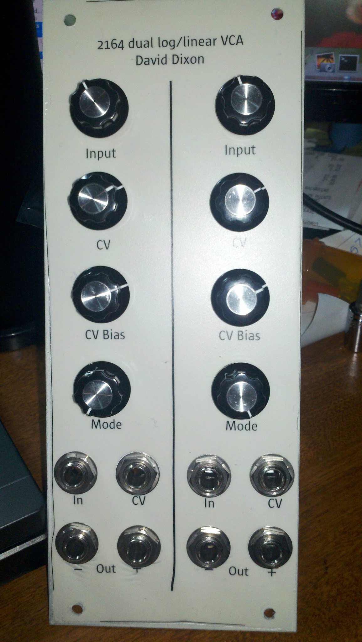

PostPosted: Fri Jan 11, 2013 10:43 pm    Post subject: Reply with quote  Mark this post and the followings unread
First completed module of the new year, though I did most of the soldering last year....
Pay no attention to the weirdness with the label Smile

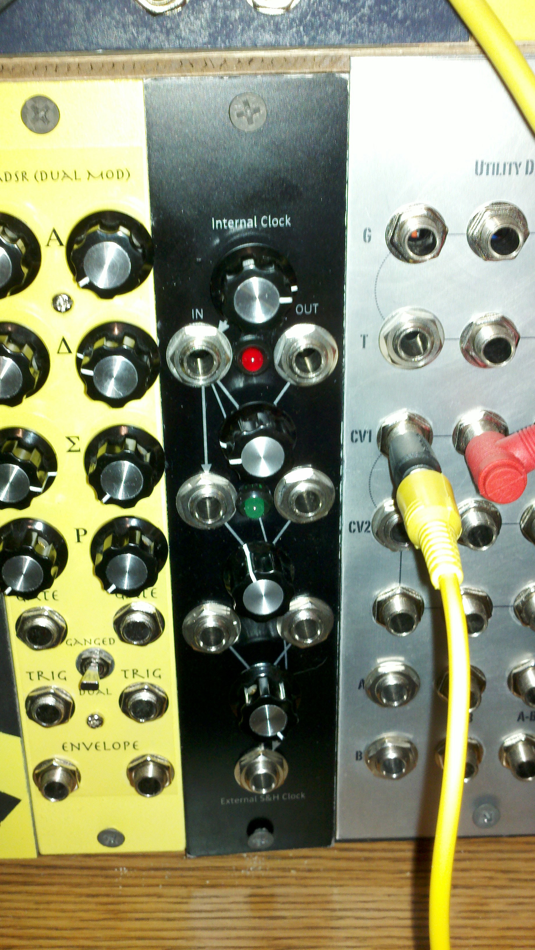

PostPosted: Tue Feb 12, 2013 10:35 pm    Post subject: Reply with quote  Mark this post and the followings unread
basic 40106 clock (thanks to diablojoy for pointing out the one-shot solution to make it a trigger clock without double triggering like I was when I tried to use a comparator), plus a couple stages of YuSynth clock divider, plus the "super simple S&H" circuit from kickstarter a while back....
Originally was going to be VC Noise + the S&H but I couldn't get it to fit into 1U so that went back onto a different spot on my backlog.
playing around with the S&H and the clock dividers:
https://soundcloud.com/elmegil/sample-and-thump
