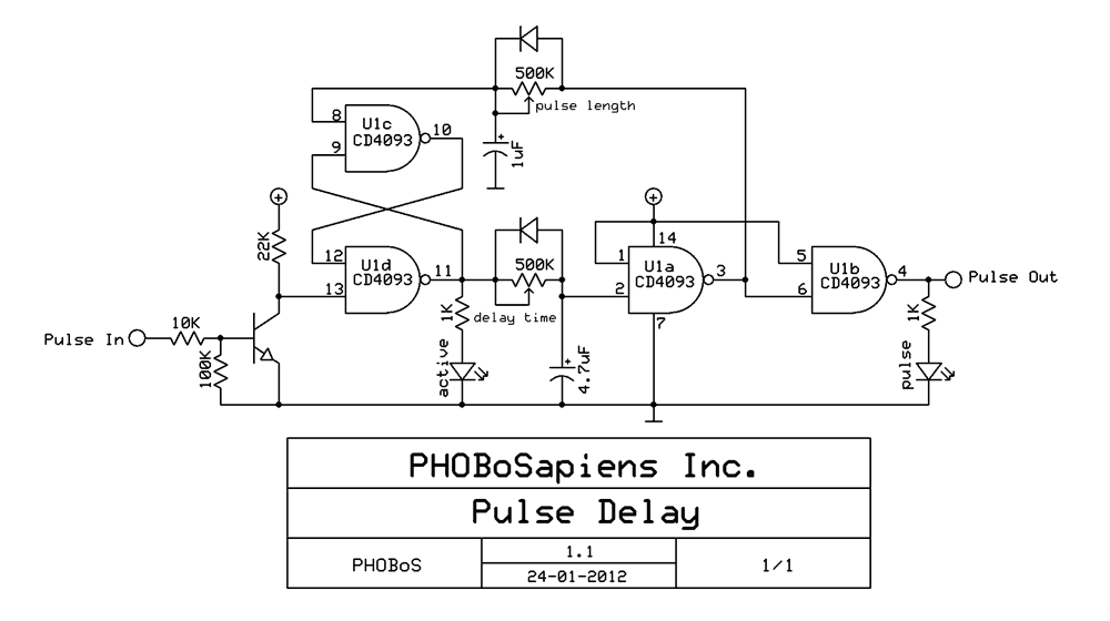

Hi.
I have a need to variably (prefferably with a pot) delay a pulse (a gate from a 4024 shift register) from about a milisecond up to maybe 2seconds long.
Basically I have the 4024 outputs going through gate to trigger circuits and then Im using the triggers to drive small motors that pluck strings... Now I want to be able to dampen the strings with solenoids just after they are plucked...
Im sure there is a simple Lunetta solution to this that maybe uses one chip and a few other components.
Do any of you gurus have experience with this kind of circuit?
Im aware I will need to beef things up to drive the solenoids its just the delay part that has this noob baffled.

PostPosted: Thu Jan 24, 2013 7:51 am    Post subject: Reply with quote  Mark this post and the followings unread
first thing that came to mind was a 555 in monostable mode but that just changes the length of the pulse, maybe if you invert it
add some extra logic that might be usefull.
something with a shiftregister ? clk sets delay time, but you would need a flip flop or something at the data input if the pulse
is shorter then a CLK cycle. You could use some logic to control the time digitally too by setting the number of places it shifts.
(a mux that selects where you take the pulse out)

I couldn't let it rest so I tried something. I wanted to make it with only 1 IC and managed to get it working with a CD4093 Cool
U1c and U1d form a S/R flip flop which 'captures' the pulse. Because it works on active low levels there's an extra transistor
inverter at the input. So when the "Pulse In"- get's a high signal U1d's output becomes high and stays high even when the
input is low again. The 4.7uF capacitor is (slowly) charged through the 500K pot until it reaches the treshold level
of U1a. When this happens the output of U1a will become low (inverted by U1b for the pulse out) which will then (slowly)
discharge the 1uF capacitor (500K) untill it drops below the treshold level of U1c. Which will reset the flip flop.
The 4.7uF cap is now quickly discharged through the diode, the output of U1a become high again and the 1uF is quickly
charged.
If the pulse input is still high after the cycle ends the pulse out will also stay high untill the input becomes low again.

PostPosted: Fri Jan 25, 2013 6:11 am    Post subject: Reply with quote  Mark this post and the followings unread
you're very welcome Very Happy
a pulse delay was something I have been thinking about before, just hadn't taken the time yet to come up with a circuit.
so I'm glad you asked. And yes you can of course replace the pot with a resistor. You could even leave out the pot/diode/cap
attached to pin 8 alltogether and just connect it directly to pin 3. But then the pulse might be too short.
You could also leave out the LED's but I think the active LED is very usefull.

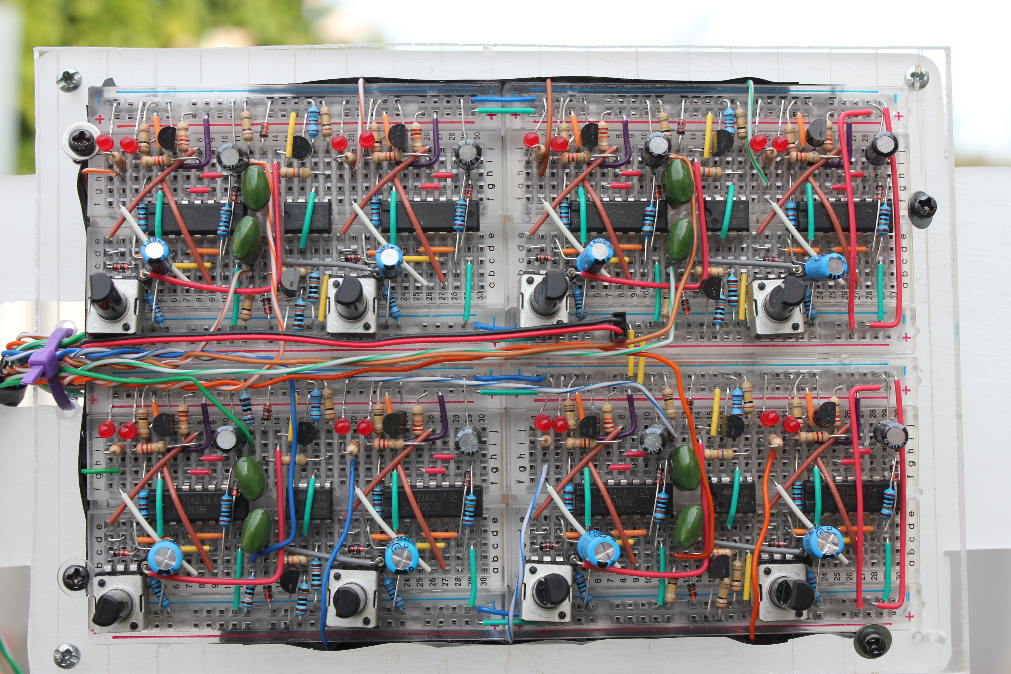

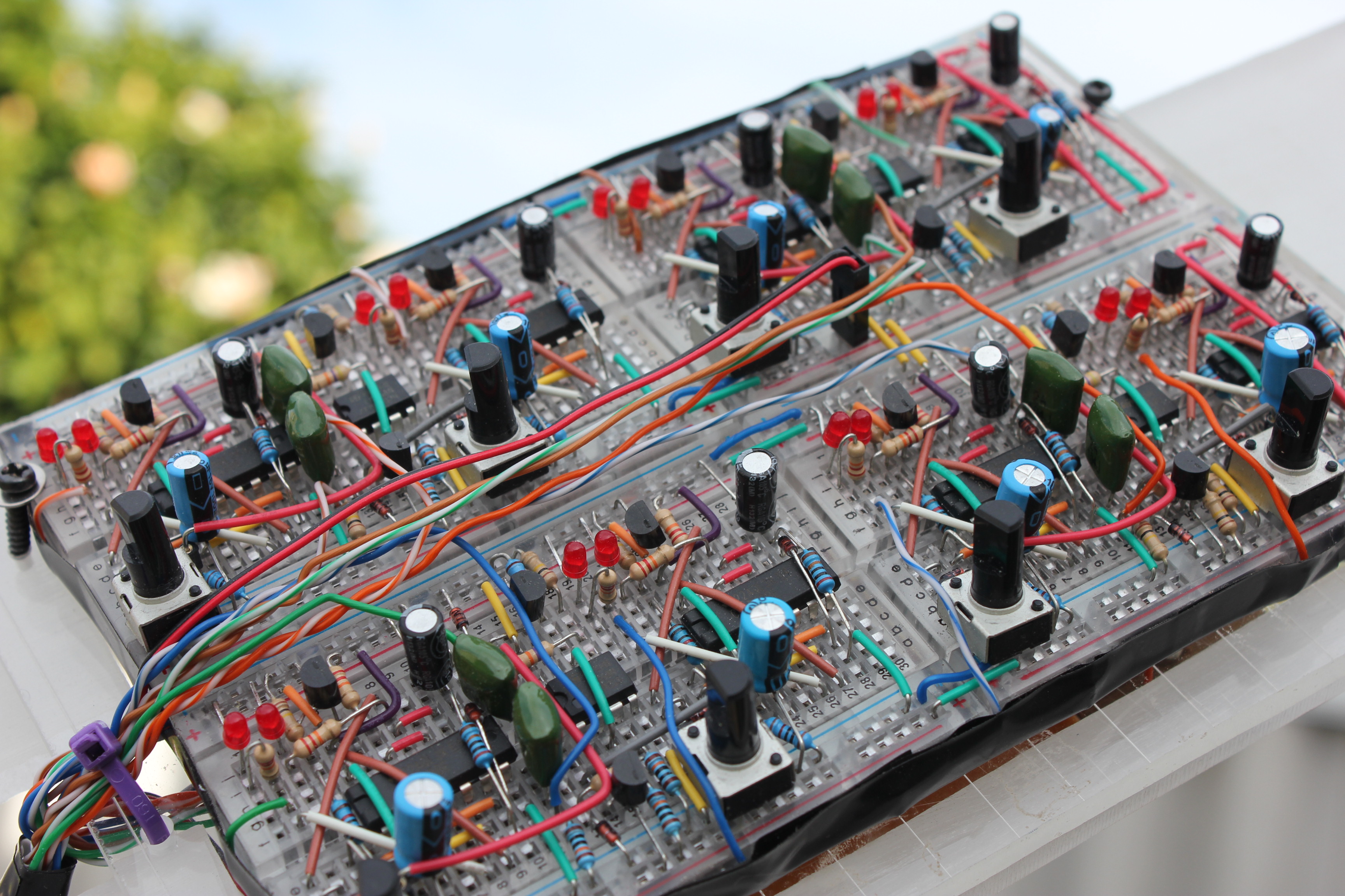

PostPosted: Tue Sep 17, 2013 3:20 am    Post subject: Reply with quote  Mark this post and the followings unread
I have had this fantastic circuit on a breadboard driving my 8string Lunetta Guitar for a few weeks now and its great. I am now starting to move it over to space wiring, freeform style... Its going to take some time as you can expect.
8gate inputs, 8delay circuits and 8outputs to relays (hidden underneath) then this goes out to the solenoids on the strings:
 Filesize:  1.81 MB
 Viewed:  748 Time(s)
 Filesize:  1.47 MB
 Viewed:  685 Time(s)

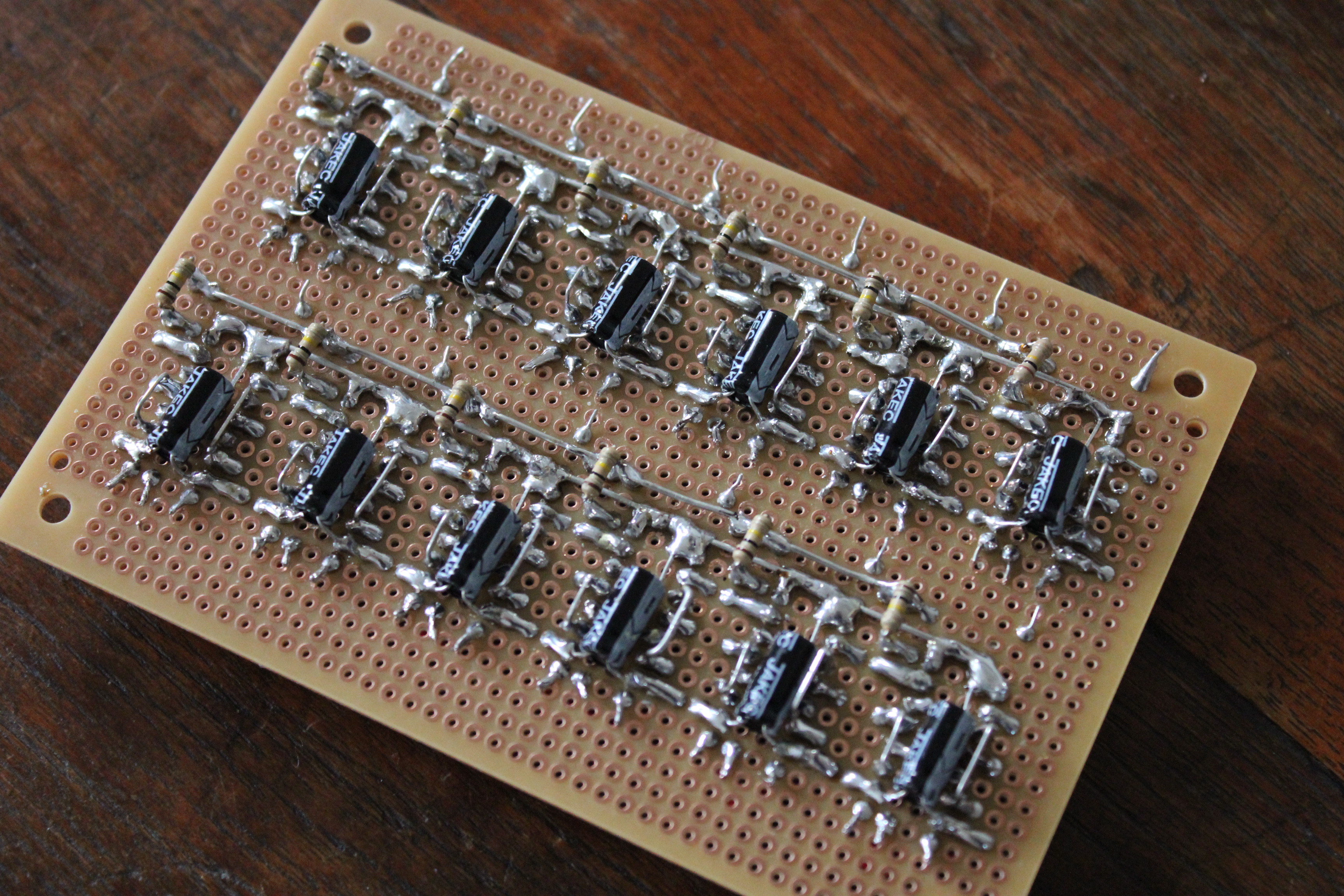

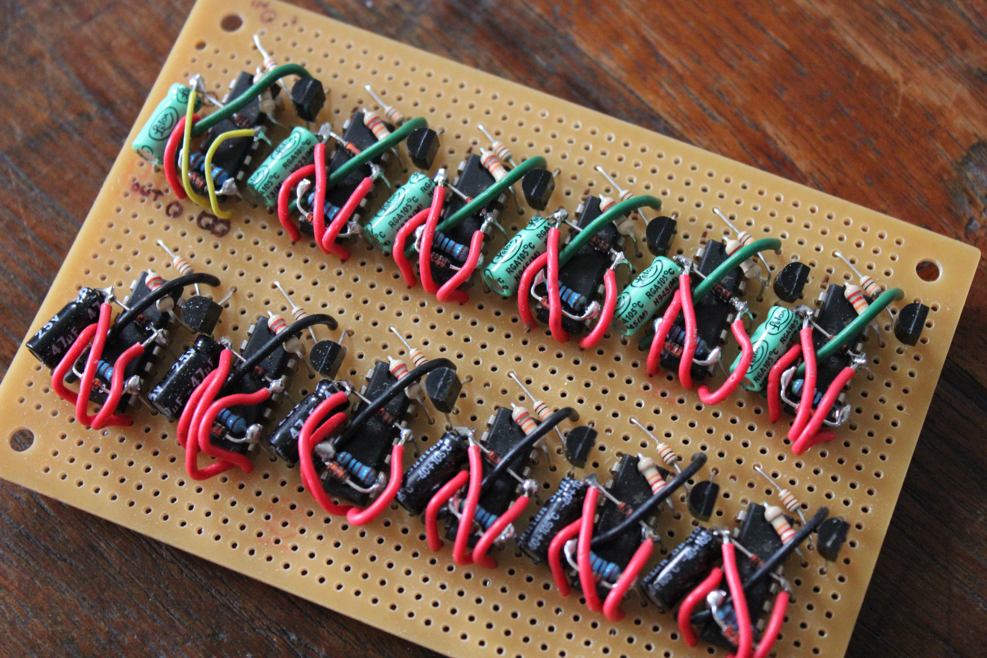

PostPosted: Tue Sep 17, 2013 3:26 am    Post subject: Reply with quote  Mark this post and the followings unread
Im building another small Lunetta Guitar in a briefcase for a small tour in Japan next month.
It will have 12 strings and space is premium so Ive tried to keep everything compact. Here is the same circuit on perfboard for 12string dampeners.
Ive sourced some solid state relays so the only sound heard is the slight clack of the dampener arm...
I have to get back to the workshop. SO much to do.
 Filesize:  1.96 MB
 Viewed:  674 Time(s)
 Filesize:  1.9 MB
 Viewed:  695 Time(s)

Posts: 5854
PostPosted: Tue Sep 17, 2013 8:01 am    Post subject: Reply with quote  Mark this post and the followings unread
good luck with the freeform wiring, I can imagine that's gonna be quite
some work Shocked your breadboards look nice too (just put it in clear
some epoxy Wink), so thanks for the nice desktop wallpapers!
o and the perf looks great aswell!

mike page wrote:
Is the output always longer than the input with 4093 option? I need something to turn big pulses into small ones (and delay them). I guess this is a positive edge detector right?
It is not necesarrily longer as it depends on the settings, but it will never be low when the input is still high.
Say you would use an input signal with a duration of 2 seconds and set both the delay time and pulse length to 0.5 sec.
at T= 0 the input goes high, output is still low
at T= 0.5 the output goes high because of the delay time setting.
at T= 1 the output would go low again because of the pulse length setting, but since the input is still high it will stay high untill T = 2.
The flip flop made with U1c & U1d triggers on a negative edge but the input is inverted by the transistor so that does work
as a positive edge detector. However, the output isn't completely isolated from the input hence why it will stay high
when the input still is. There is a simple solution for this though but I haven't tested it. If you add a small capacitor
(100pF will probably suffice) in series with pin 13 and add another pullup resistor to that pin as well, the input signal will
be transformed into a very short pulse before it triggers the flip flop.

Would you see an easy modification to be able to add CV control over the gate length ?
Posts: 5854
PostPosted: Sun Dec 17, 2017 11:53 am    Post subject: Reply with quote  Mark this post and the followings unread
The maximum gate length can probably be calculated but depends a bit on the supply voltage. You can make it as long as you
want though by using a larger capacitor or resistor. If you do use a very large capacitor it might be wise to place a resistor in
series with the diode to limit the current a bit. Voltage control could be done with a vactrol or transistor but it would be better to
use a slightly different circuit altogether. I started on a design for a voltage controlled pulse delay recently which will have
voltage control for both delay time and gate length. Actually you could probably modify the NAND circuit by placing a comparator
before pin 8 of U1c and the treshold level (which can be voltage controlled) will determine the gate length.
