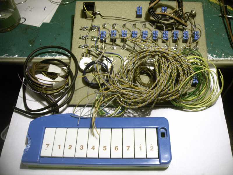

This is a project I'm currently working on and instead of waiting untill it's completely finished I'll post the progress I make
along the way.
It started when I went back to think about what i was gonna do with the Schrödinger II circuit. One thing that came to mind was to make
a stylophone controller for it, which then lead to the idea of using a small keyboard instead, using a cheap (€1,-) toy keyboard.
Initially I wanted to add a trimpot for each key or maybe a resistor string, but it turned out that the PCB was so small it would be hard to
solder anything to. So I ditched that idea and played around using the output of the keyboard to control another oscillator, and this gave me
the idea to just square up the output and use it as a tuned oscillator.
first a little more info about the keyboard I'm using. It has 10 keys, tuned to major intervals (white keys). When you press a key a tone will
only play for a certain duration so it stops even when the key is still pressed down. It also has a switch that puts it into melody mode.
In this mode each key plays a different melody, restarting from the first note everytime you press a key. It runs on 2AA batteries and has
a small speaker.
So now to square up the output. Well this turned out to be a lot easier then I could have hoped for because when I connected my scope to the
output a nice squarewave allready appeared Laughing Since the keyboard runs on 3V, the output voltage isn't high enough to control anything
directly. However, as it turns out, it's an open collector output (there is no extra transistor on the PCB though), with the speaker connected
between +3V and the output. So all that's needed was a pullup resistor, connected to the voltage I want to use, instead of the speaker.
Followed by an inverting buffer for which i used a 40106. For the sound itself it doesn't have to be inverted but when there is no sound
I like the output to be low.
of course I couldn't just leave it at that. So I'm also adding remote inputs for every key (Lunetta controlled keyboard for nice sequences),
a Gate output which is high as long as a key is pressed, and a Trigger output which gives a short pulse everytime a key is pressed even
when another key is still held down. And some indicator LED's for every key.
of course I couldn't just leave it at that. So I'm also adding a simple AD/AR generator to control a very simple transistor VCA, a 4040
divider and a switch to select different octaves, which is also used to add suboctave and modulation to the sound. And a potentiometer to
control the pitch, which also affects the note length.
And I hope I can leave it at that. Cool
To be able to do all this I did have to solder wires to the PCB afterall, so I used some thin enameled wires and soldered them to a piece of perf
with a printconnector on it. This will make it easy to solder wires to it later. I also added a 3V supply using an LM317L.
I'm currently soldering the main PCB, So more info later.
But here are some photo's.

Posts: 5930
PostPosted: Sat Feb 23, 2013 6:00 pm    Post subject: Reply with quote  Mark this post and the followings unread
soldering,...

Posts: 5930
PostPosted: Sun Feb 24, 2013 4:22 am    Post subject: Reply with quote  Mark this post and the followings unread
I'm done with soldering the main PCB, but before I can wire it up I first need to design a frontpanel and make a case for it and then order some
switches which should arrive tuesday. Maybe I'll solder a couple of wires to the PCB and do a couple of tests though.
Main PCB done

just different.
It's all done with a (electric) jigsaw, a file, some sanding paper, sweat and a bit of patience. And I don't use real wood, which makes it a lot easier
to work with. Everything is just glued together by the way, no screws or nails.
Switches, pots and knob did arrive today as planned so I can continue with that. I did have another idea yesterday which is using the inputs
that control the keyboard also as outputs to control something else, so you can use the keyboard as a row of 10 pushbuttons. I allready have
toggle switches to turn the inputs off so I could do it,. but it would need some extra buffers though.

I now have everything wired up,. so next is going to be the hold-your-breath-and-turn-it-on-and-hope-there-isn't-any-smoke part. Shocked
The painting set me back a bit timewise, I'm doing a duotone but one color kept messing up the other. I think it's ok now just needs some
clear coating. If I can resist I'll let it harden further until tomorrow before I put it together, allthough it will be dry enough to handle.
Posts: 5930
PostPosted: Wed Feb 27, 2013 2:24 pm    Post subject: Reply with quote  Mark this post and the followings unread
I wired the LED's the wrong way around doh (I usually have them connected to GND). But no smoke, I've got power on all the IC sockets
and I get 2.7 V when I press a keyboard key. So that's right sofar. Laughing
so a little bit of rewiring and then I'll try again,..

After I rewired the LED's yesterday there was still one LED that didn't light up. I wondered if I put it in reversed again so desoldered it,
and tested it (couldn't really see what was anode or cathode) and it turned out to be dead. I used some different LED's then usual (waterclear)
of which I had just enough,. I almost went into panic mode, but luckely I did manage to find just one more. After replacing it all the LED's
lit up as they should. Very Happy
So I inserted the 40106 and the 'Gate' and 'Out' LED's worked too. After that I put the 555 for the 'Trigger' output in place and that also
worked as it should.
Next the 4040 (octave switch, sub-octave and modulation). I could see if it worked by looking at the mod.rate LED, which seemed to work
except at one position of the rotary switch. So I checked what it was connected to and it turned out to be the wrong pin of the 4040.
It would actually blink really slow, but because the keyboard only produces short tones it didn't get a chance to turn off.
After I resoldered it to the correct pin I still wasn't really happy with the modulation rate. Originally I planned for a 4 step switch,.
but when I designed the front I changed it to 5 steps (I could have used 12, but the slow modulation is useless). So initially I choose
a larger division of the original squarewave for this 5th step, but in my opinion it was too slow,. so I shifted everything 1 step and
used a smaller division instead.
Finally there was one more chip to insert, the 555 for the AD/AR generator and with this inserted I could actually listen to it. Well,
I got sound but the AD/AR generator didn't seem to work as it should, it did something though. So I compared the schematic with the
PCB layout and noticed I had the timing capacitor in backwards, which of course I also put in the wrong way on the PCB itself. (this probably
happened after making some last minute changes for which I had to move some components around). After I replaced the cap (just to
be sure) the AD/AR generator worked too. Laughing allthough it doesn't always seem to retrigger but that's probably just how I designed it.
I might look into it, but it works well enough.
At this point I thought I had all systems running,. untill I tried the remote inputs. The key LED lit up, Trigger LED blinked, Gate LED lit up,
but no sound
So I measured the voltage going to the 'keypoint' on the keyboard and it was only ±1.2V. which should be 2.7V, hmm. I first removed the
connection between the input resistors and diodes and the rest of the circuit to see what voltage I got, but still the same. So I
removed the zenerdiode (keyboard disconnected) and now I got a voltage of ±6.6V which was correct. Well, what i didn't keep in mind
was that a zenerdiode needs some current flowing through it to work, and I had done just the opposite, that is trying to keep the current
through the diode to a minimum. So I just needed to reduce the input resistor (33K) and to make life easy I didn't remove it from
the PCB but just soldered a 4K7 resistor in parallel. After this modification the remote inputs worked perfect. So at this point it was
finally all working as it should.
One final change I made was change the series resistors of the Gate/Trigger/Out LED's which were not bright enough in my opinion.
The Gate and Trigger LED's are both waterclear which usually are also pretty bright but not these ones. And the Out LED is a blue
one, which can be pretty bright, but because it's actually blinking with a 50% dutycyle it's not as bright as when it's just on.
I'll post some schematics later. I'm still working on the paint now. I put some clear coating on this morning, but I should have put
down some fresh newspapers because the force of the spray lifted the paintdust of which landed where it shouldn't .
So I had to repaint a bit again. But I should be able to put it together today.
Allready had a bit of fun with it last night making some simple sequences wave Laughing
