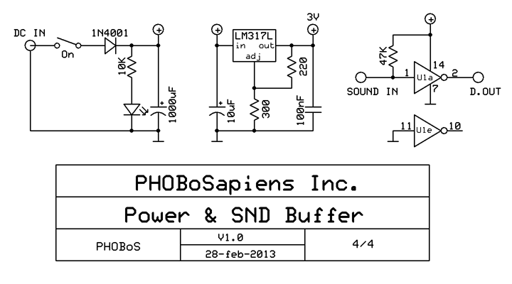

Some small bits, 3V power supply and the buffer to convert the keyboard output to a CMOS level.
AD/AR will follow. I just did some tests, and I think the 'problem' is not that it doesn't retrigger just that it doesn't dicharge the cap first, which is actually fine with me.

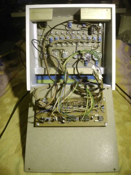

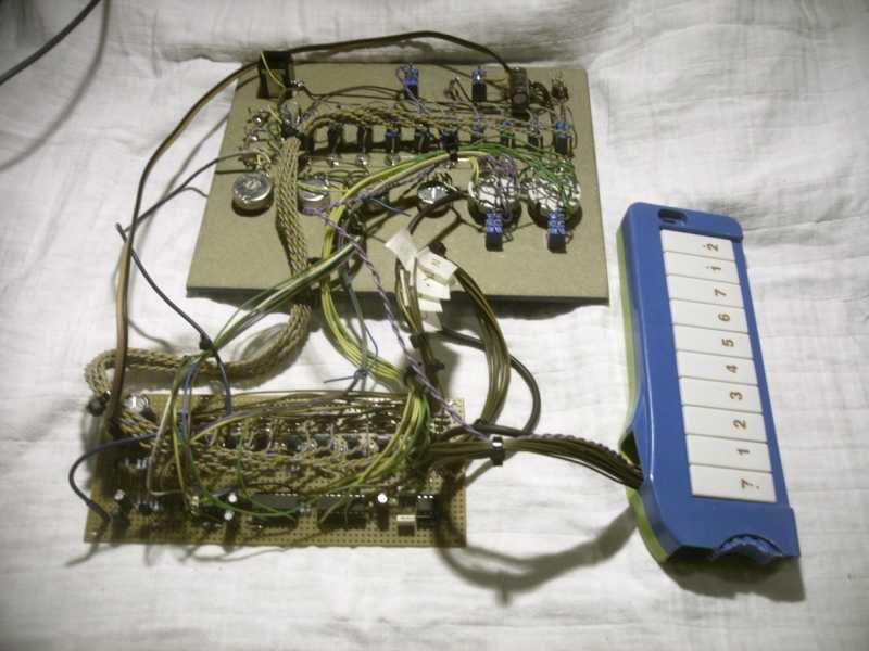

some pre-final pics. The front panel did stay in place by itself but I secured it with some hotglue.
PCB and keyboard all wired up.
 Filesize:  46.34 KB
 Viewed:  595 Time(s)
everything installed and ready to be closed up
 Filesize:  48.94 KB
 Viewed:  631 Time(s)

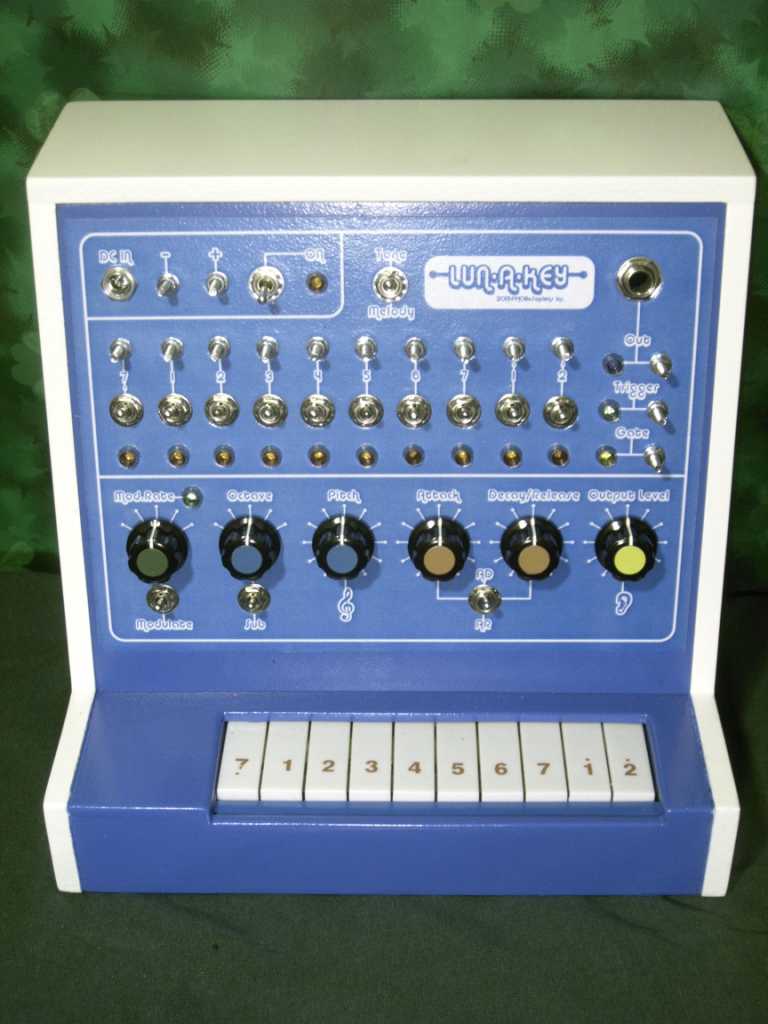

Posts: 5947
PostPosted: Thu Feb 28, 2013 6:18 pm    Post subject: Reply with quote  Mark this post and the followings unread
smurfin
 Filesize:  56.81 KB
 Viewed:  642 Time(s)
 Filesize:  59.55 KB
 Viewed:  623 Time(s)
 Filesize:  67.25 KB
 Viewed:  603 Time(s)
analog_backlash
Joined: Sep 04, 2012
Posts: 393
Location: Aldershot, UK
Audio files: 21
PostPosted: Fri Mar 01, 2013 6:18 am    Post subject: Reply with quote  Mark this post and the followings unread
The final results look great again PHOBoS Very Happy

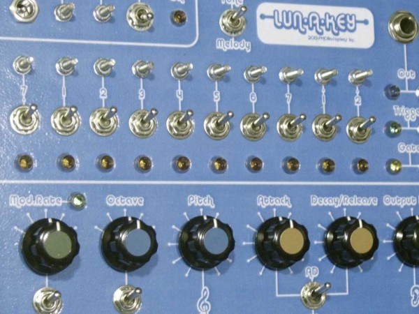

PostPosted: Fri Mar 01, 2013 11:33 am    Post subject: How to make frontpanels like PHOBoS
Subject description: step by step guide
Thanks! Gary and Jake Very Happy
let's see if I can give you a step by step rundown on how I do it.
step1: design a frontpanel, I use photoshop since I'm used to it,. but there are better programs for it. Can't give you much suggestions for it,
you'll learn and get better by doing it. And I get a lot of inspiration by watching what other people make. I do usually print out a
simplified greyscaled version, to get a better idea on how it will look. It's also useful to test if you have enough space for components.
step2: when you're completely satisfied with your design, print it (or better, wait untill after step 4). I use a laser printer myself (Samsung
CLP-320, not the best quality but good enough for me), You could use an inktjet, allthough that can get problematic with full color designs, or
maybe have it printed somewhere else.
step3: while I'm making the front design I also make a drill template, which only has crosshairs for the holes and an outline. Sometimes I leave
the text on there too so I know what all the holes are for. Then I use some painters tape to stick it to the panel and then drill all the holes.
- Put a piece of (flat) scrapwood underneath it so you get cleaner holes. After that sand the panel.
update: I now use sprayglue instead of tape which works much better
step 4: Next I paint the panel,. even when I'm covering it for the most part with a frontlabel. Might not be necessary, it depends a bit of
what you use to glue it together. I paint it using spraypaint, usually a couple layers of primer first and then 2 or more layers of color,
with some sanding in between. No clear coating though.
step5: during this painting process I prepare the frontlabel. I first cut it roughly to size, leaving an extra edge of ± 5 mm, using one of those
cheap plastic boxcutters. Always do a test cut first to see if it's sharp enough, else it might damage your nicely printed paper while cutting mad, short circuit .
Next I add a layer of thin self adhesive plastic to the backside, and then I cut it neatly to size. The plastic I use is actually meant to print on
directly. link. It will add more strength to the paper so it doesn't tear up so easily, which I started doing because of the way I attach the
frontlabel to the panel. Which brings me to the next step.
step6a: When you have your frontlabel printed and cut and panel drilled and painted you have to stick them together. There are several ways
to do this. For my synthcases I used woodglue which is also why I needed to use the plastic else the paper would get all bubbly and tear very
easily. I apply it with a paintroller to the frontpanel. For my PWM Lunetta and this Lun-A-Key I used double adhesive tape instead link. It makes
it a bit more expensive, especially with larger panels, but it sticks better then the glue and adds some extra strenght and thickness. You could
leave the extra plastic layer off if you do it this way,. but it's nicer with. Another way is using spayglue, which I use for my modular lunetta
panels. But it's a bit more messy and doesn't always stick too well.
step6b: the most nerve racking part, glueing it together while trying to line everything up. Unless the label and panel are the same size
(which will makes corners peel off easy) you will need some backlight for this. sometimes a PC monitor will work or a simple light box or just
the sun using a window. When using woodglue you have a little bit of time to slightly adjust it, but with the double adhesive tape you only have
one shot at it. I don't just pull of the protective layer and then hope to get it stuck exactly right at the panel btw. I first pull off a little bit and fold
it back, then line up the part where it's still in place and when I think it's in the correct place I push down on the uncovered, sticky part. From there
on it's just slowly peeling it off while pushing the label on the panel.
step7: now you need to add a protective layer. You could use all kinds of stuff for this but what I use is woodglue, again applied with a paintroller Cool.
Just the ordinary white stuff that dries transparent, allthough I've been using a special waterproof version of that lately. You have to work
quick though since it dries pretty fast. But it leaves a nice thick structered layer
step8: after you let this dry (it dries fast but I wait at least an hour). You can cut the holes in the label. I do this by first making some starshaped *
cuts with an exacto knife, and then use a round file. Takes a bit of practise but you get the hang of it after a couple of holes. I always wear a glove
on the hand I use to hold the panel. The glue protects but isn't rocksolid (especially not after 1 hour) And I don't want my fingerprints embedded in it.
and that's it. Cool

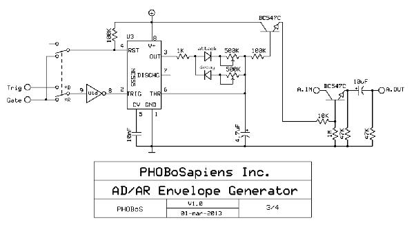

anyway I hadn't posted the schematic for the AD/AR envelope generator yet so here it is.
It's a very basic setup with a single 555, allthough this time I didn't use the discharge pin (7) for the decay/release but pin 3 aswell. I think
I got this idea from a schematic posted in the Schematics Vault but I can't seem to find it right now. Here's how it works:
Starting in AD mode. The 555 get's a trigger pulse (inverted by U1d), which will make the output (pin3) go high. This will charge the
timing capacitor untill it reaches the treshold level (measured by pin 6) and then the ouput will go low again which discharges the cap.
Charge and discharge times are of course adjustable with the two 500K pots.
In AR mode the same thing happens but with a few differences. Because the trigger input of the 555 is connected to the keyboard Gate instead
of Trigger output, it's output will stay high as long as you hold a key down. Only after you release the key it will discharge. Normally it would only
discharge once it has reached the treshold level, but this is were the connection to the reset pin comes in to play. As soon as you release the
key it wil reset the 555 which will make it's ouput low instantly.
Of course so far it's just a varying voltage, now to use it for something. The first thing is a buffer transistor, which functions pretty much the
same as an opamp configured as a voltage follower. I didn't want to use any opamps and since it's a self contained circuit a simple transistor
was good enough. This transistor drives another transistor which actually controls the amplitude of the signal. (VCA). The resistor values
are just the first ones I tried and it worked instantly Very Happy So I left it at that. I did replace the 47K output resistor with a 47K pot for level control.
