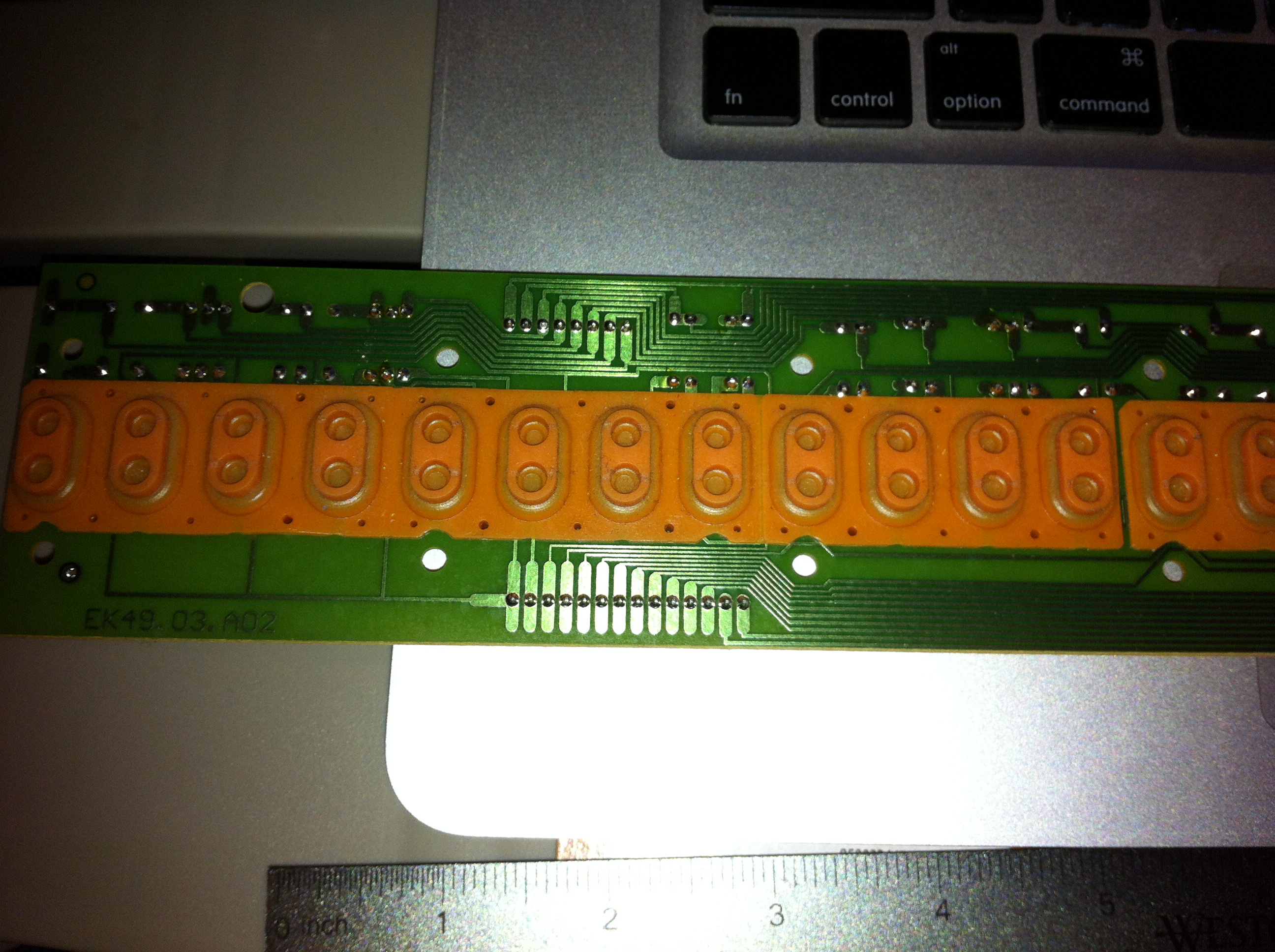

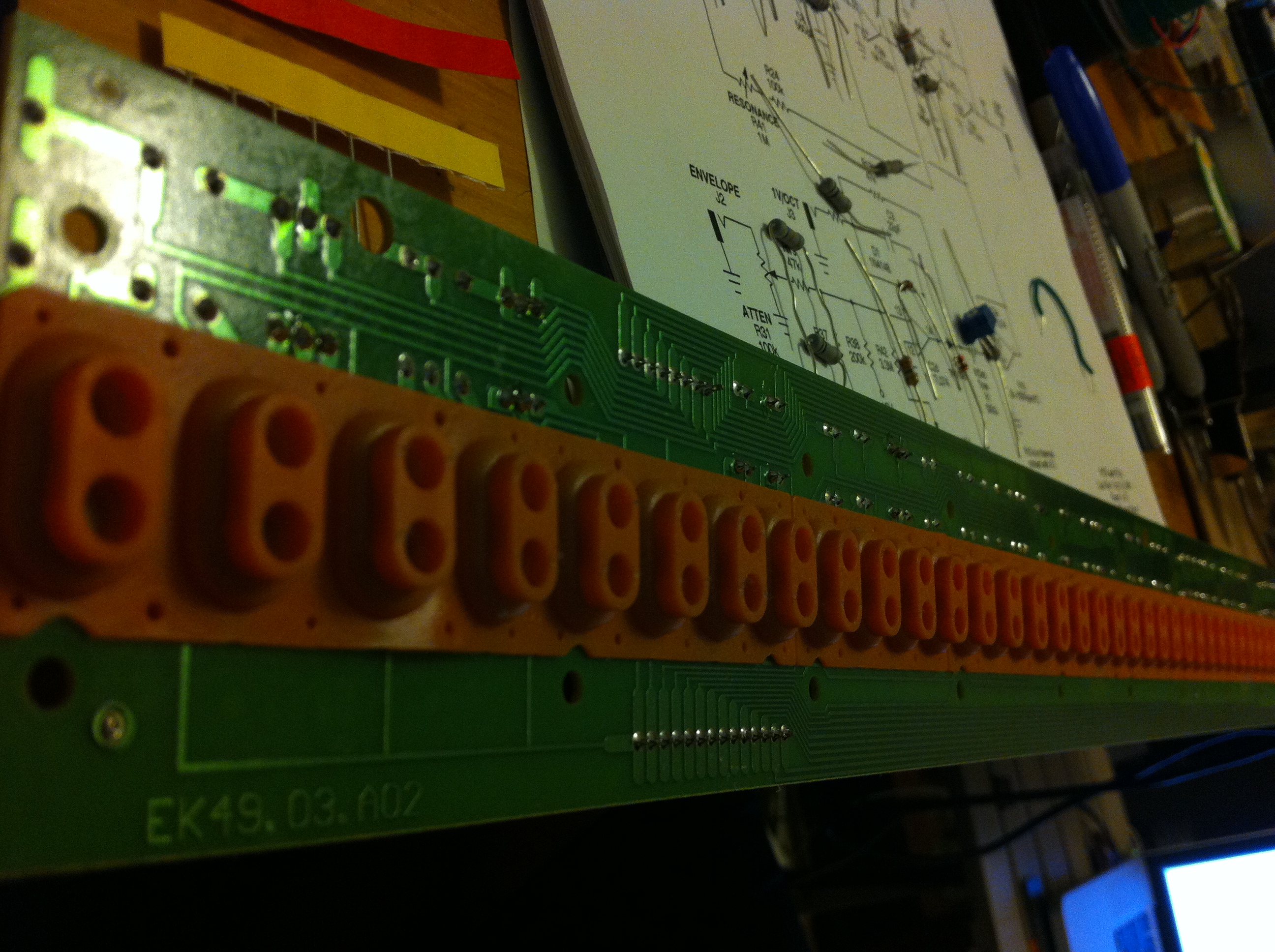

PostPosted: Sun May 05, 2013 9:15 pm    Post subject: Reply with quote  Mark this post and the followings unread
Hey guys, here's the underbelly of the keyboard. It seems to use the ROW/COLUMN configuration needed by the IKC to communicate with the modules, but I'm not sure exactly how to tell which side is ROW and which is COLUMN, or if I'm clearly mistaken and should cave in for a FATAR..
Geez the LFO is tough to get going haha.
Thanks for the help guys.

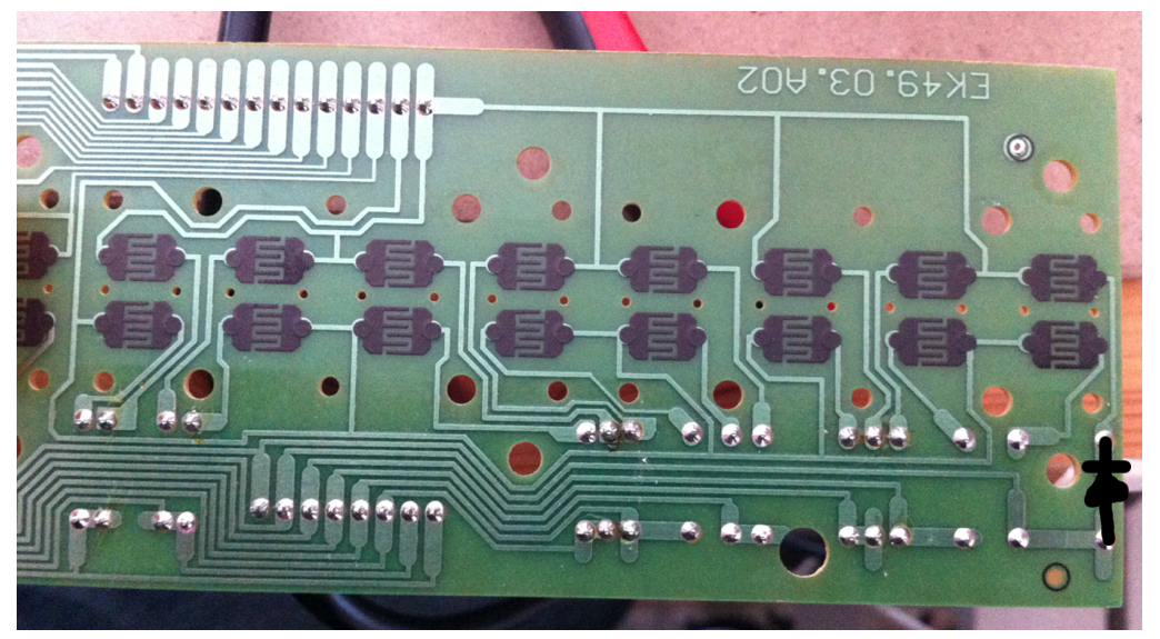

PostPosted: Mon May 06, 2013 2:39 pm    Post subject: Reply with quote  Mark this post and the followings unread
Hey guys, I opened up the keyboard a little more and I think I might be able to use this but the configuration seems a little odd to me right now, but maybe you guys have some insight on the row/column configuration in here.
The cathodes of the diodes are like the one show in the picture but going across to the left side.
Let me know what you guys think.

PostPosted: Mon May 06, 2013 3:01 pm    Post subject: Reply with quote  Mark this post and the followings unread
in a diode matrix scanner keyboard the catodes are going to be summed into the rows, no?
so just follow the traces and compare it with the drawing on i.e. ray wilsons music from outer space scanning matrix keyboard page.
since the PCB of your keyboard is single sided it might look a little bit confusing at the 1st glance.
i would recommend to print out the drawing from MFOS and greenline it while following the traces on your PCB.

PostPosted: Mon May 06, 2013 7:50 pm    Post subject: Reply with quote  Mark this post and the followings unread
Yes, the little rubber buttons in your keyboard are the switches in Ray's schematic.

PostPosted: Tue May 07, 2013 1:23 am    Post subject: Reply with quote  Mark this post and the followings unread
Okay so I guess the smaller row refers to the column connections as they are connected to the anodes of the diodes, so I shouldn't have a problem there since that would correspond to the exact number of input column pins on the IKC (8 pins) but here's where it gets confusing..
How am I to connect the row to the IKC if the IKC only has 8 input row pins but the keyboard has 14 pins? The diagram shows 5 rows for a 37 key.
