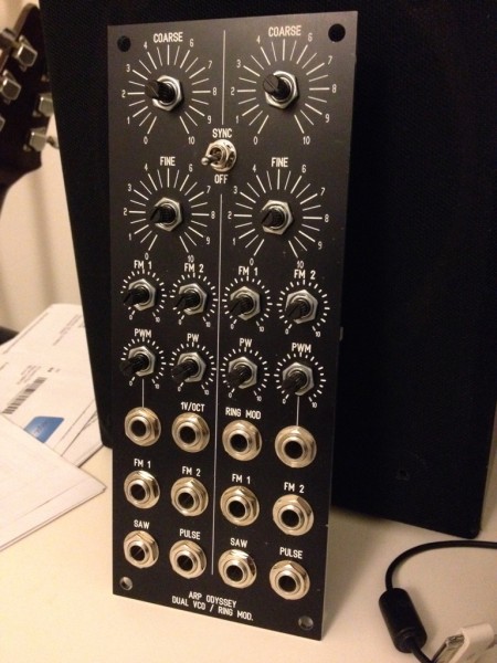

Sorry to drag this up again, but I still don't think my saw and square waves are correct!
On the previous page I thought my waveshapes were a little 'wonky' looking. They used to be perfect square and saw waves, but after getting my synth out of storage where it had been languishing for a couple of years, I noticed that they were wonky.
I thought it might have been my oscilloscope that was playing up, and using the attenuator on the probe it looked like the problem had gone away. But I've just recorded my synth straight out into my computer and took a look at the waves in my DAW. They're still wonky! In both oscillators!
I guess I'll have to start poking around the 4011 seeing as that's the component that both oscs share. |

Well they look wonky on my scope, until I use the attentuator switch on my probe, when they then appear as expected. On the previous page of this thread it was said that this was an impedance issue.
My problem is though is that if my square and saw wave look wonky in Cubase, after going through my FF400, then surely I'm not able to compose/ record with perfect square and saw waves?
I've attached some screenshots of the audio clips so you can see what I mean by wonky.

Well the reason I'm being so anal with the waveforms is that they sound... well not off, but not quite how I remember them sounding. That's why I'm being paranoid! The only problem is that I haven't played with the synth for a couple of years, so it might just be my memory playing tricks on me!
If this could be an impedance issue, would it be solved by putting 1K resistor in series with the outputs? |

Apologies if this has been asked before, but is anyone running this on +/-12v at all?
Do I need to re-calculate some resistor values for it to work, or should I be fine just plugging it in?
Thanks! |
steffensen
Joined: Jul 11, 2012 Posts: 103 Location: Sweden
Posted: Mon Oct 14, 2013 12:26 pm Post subject:
| LetterBeacon wrote: | Apologies if this has been asked before, but is anyone running this on +/-12v at all?
Thanks! |
Im running mine on +/- 12V with no problem. The only thing that might need a lower value is the 274K controlling the PW. |

Posted: Mon Oct 14, 2013 1:03 pm Post subject:
Hi steffensen
Back then I think we talked about the 56k of the PWM, not the 274k..
If I remember correctly one should add 16.5k to the 56k in the 12V version.
So when you turn the PWM all the down you will get the square you want.
Just found it in one of our emails...
| Quote: | In the 12V I needed to add more resistance for the square to sound like a square, i found that if I take the PW pot all the to the left I can still hear the PW works, only when I turn the pot CW few millimeters I get the square that should be.
So in the 12V I checked how many resistance I get when turning the PW pot till I hear the perfect square, it turns out to be 16.5k so I added this value to the 56k that in series with the PW pot and it worked like a charm  |
I wrote PW but meant PWM, sorry for the mixup. _________________ http://www.myspace.com/mgmtrance |

If I wanted to be able to control the pitch of each oscillator separately, which trace should I cut?
Looking at the PCB layout posted on page 1, it looks like I need to cut the trace that goes from the 1v/Oct to the VCO2 Scale trimmer. Does that sound look right? |

Working on SMD version of this great little module.
So far it sounds great, need to verify tracking and stability and also how it performs on 12V.
I'm tracking 4-5 octaves (the fifth is a bit sharp) with unmatched trannies.
How does yours track? how many octaves?
I'll add pads for Thru-hole transistors for the expo pair in next revision, just want to know if i'm having the same results.

I can track mine with no matched transistors up to 9 fully octaves.
It perform great with 12V although the signal is a bit low comparing to 15V.
Isak E. _________________ http://www.myspace.com/mgmtrance |

What did you use as trannies for the expo pair?
I'm wondering why I only get 4 good octaves when you get 9, must be something else perturbing the thing.
