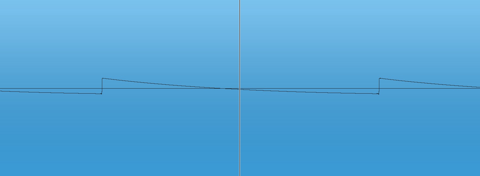

Sorry to drag this up again, but I still don't think my saw and square waves are correct!
On the previous page I thought my waveshapes were a little 'wonky' looking. They used to be perfect square and saw waves, but after getting my synth out of storage where it had been languishing for a couple of years, I noticed that they were wonky.
I thought it might have been my oscilloscope that was playing up, and using the attenuator on the probe it looked like the problem had gone away. But I've just recorded my synth straight out into my computer and took a look at the waves in my DAW. They're still wonky! In both oscillators!
I guess I'll have to start poking around the 4011 seeing as that's the component that both oscs share.

PostPosted: Sat Jun 29, 2013 9:12 pm    Post subject: Reply with quote  Mark this post and the followings unread
Hi Smile
How does they look in the scope?
Are they look ok in your scope and in your computer they look wonky?
If yes that's normal.
I have the same thing with mine.
On the scope looks as they should, when connect to the soundcatd (RME FF400) look wonky, it's very obvious when at low freqs.
Cheers.

PostPosted: Sun Jun 30, 2013 2:03 am    Post subject: Reply with quote  Mark this post and the followings unread
Well they look wonky on my scope, until I use the attentuator switch on my probe, when they then appear as expected. On the previous page of this thread it was said that this was an impedance issue.
My problem is though is that if my square and saw wave look wonky in Cubase, after going through my FF400, then surely I'm not able to compose/ record with perfect square and saw waves?
I've attached some screenshots of the audio clips so you can see what I mean by wonky.

isak
Joined: Dec 13, 2009
Posts: 847
Location: Israel
Audio files: 18
PostPosted: Sun Jun 30, 2013 2:10 am    Post subject: Reply with quote  Mark this post and the followings unread
believe me, you will Wink
same shapes i have in my comp, nothing to worry about.

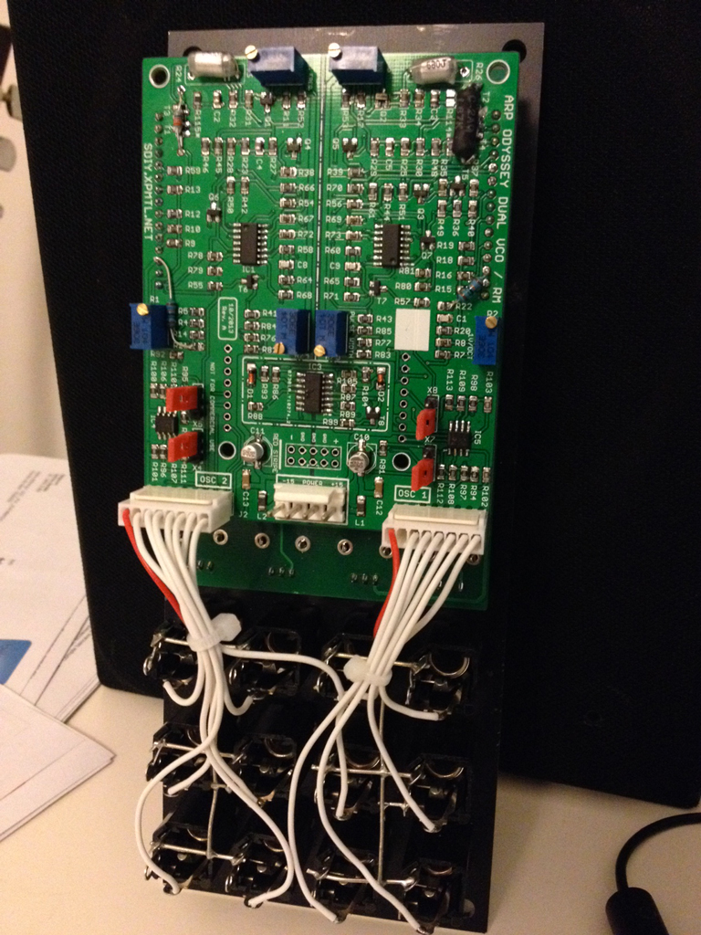

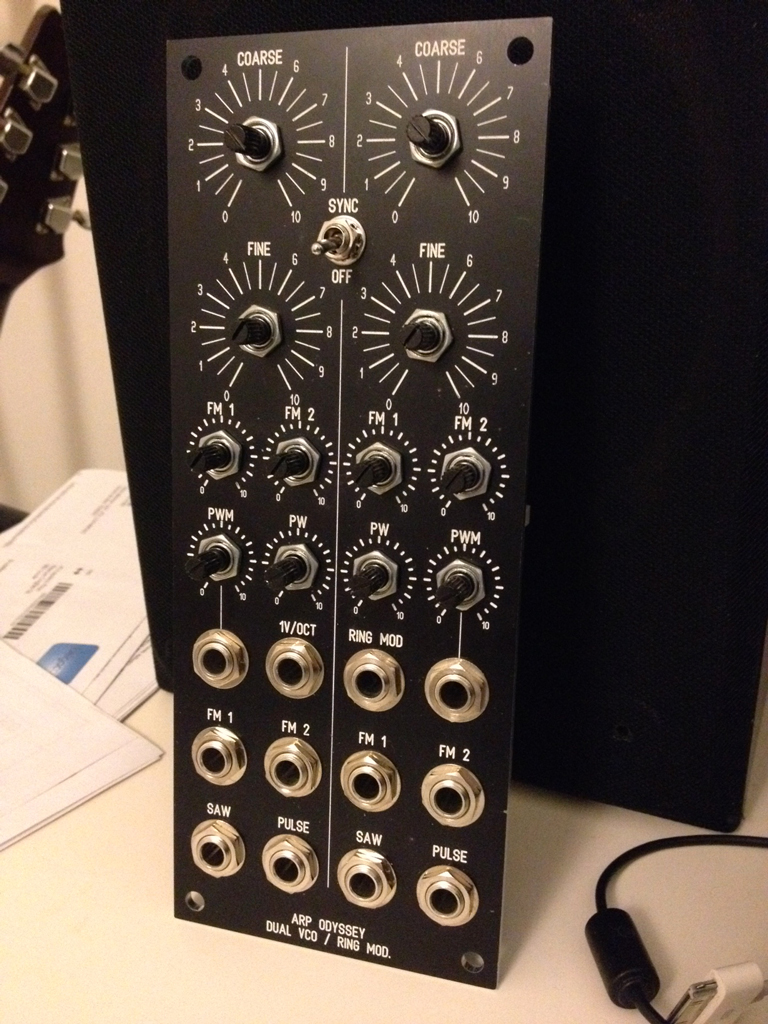

PostPosted: Fri Jan 10, 2014 8:34 am    Post subject: Reply with quote  Mark this post and the followings unread
Working on SMD version of this great little module.
So far it sounds great, need to verify tracking and stability and also how it performs on 12V.
I'm tracking 4-5 octaves (the fifth is a bit sharp) with unmatched trannies.
How does yours track? how many octaves?
I'll add pads for Thru-hole transistors for the expo pair in next revision, just want to know if i'm having the same results.

PostPosted: Fri Jan 10, 2014 1:47 pm    Post subject: Reply with quote  Mark this post and the followings unread
Hi Smile
that look nice, good job.
I can track mine with no matched transistors up to 9 fully octaves.
It perform great with 12V although the signal is a bit low comparing to 15V.

PostPosted: Sat Jan 11, 2014 2:12 am    Post subject: Reply with quote  Mark this post and the followings unread
Thanks Isak
What did you use as trannies for the expo pair?
I'm wondering why I only get 4 good octaves when you get 9, must be something else perturbing the thing.
