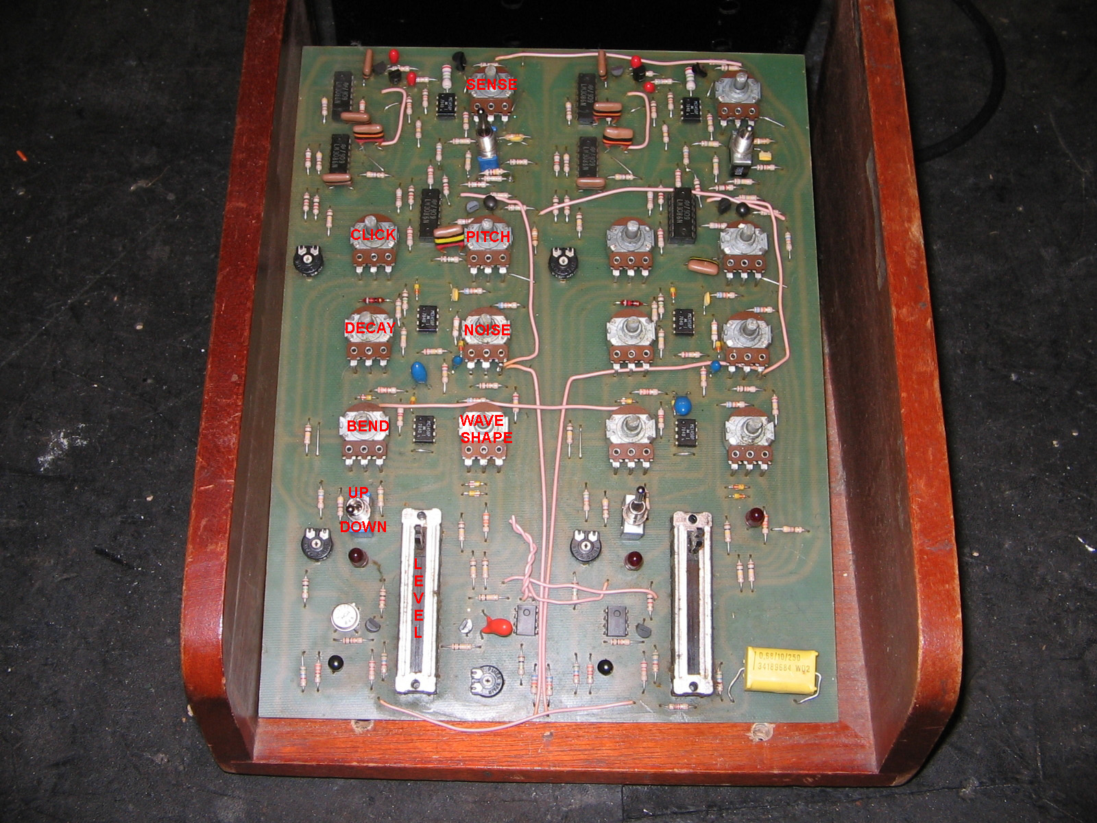

PostPosted: Wed May 08, 2024 7:53 pm    Post subject: SDS-3 images of original circuit board?
Subject description: Anyone have some hi res images of the original circuit board?
I've seen some links in the forum for hi res images, but alas the link does not work, I even tried the wayback machine. Anyone have the images they can share? I would be forever grateful. This unit is so elusive. Thanks all.
Steveg
Joined: Apr 23, 2015
Posts: 184
Location: Perth, Australia
PostPosted: Thu May 09, 2024 3:10 am    Post subject: Reply with quote  Mark this post and the followings unread
I can click on both of the above images and get a high rez version of each .... are you getting any errors?

PostPosted: Thu May 09, 2024 8:20 am    Post subject: Reply with quote  Mark this post and the followings unread
Sorry I'm a noob at the forums. Hi res photos of the original SDS-3 circuit board. Alex Ball has kindly given me some detailed images of the underside of the PCB, but as far as the top goes, for component values, I've found one image and it is super blurry.
I am looking for hi res image of the top of the circuit board. A few pages back someone shared that they own an SDS3 and posted a link but the link goes to a dead site.
Thank you!

PostPosted: Wed Jun 05, 2024 11:55 pm    Post subject: Reply with quote  Mark this post and the followings unread
This photo might have come from this thread. I don't want to look through 14 pages to see if this is a repost. Anyway, it's the best I have. How about posting your trace photo for us geeks?
 Filesize:  628.92 KB
 Viewed:  165 Time(s)
