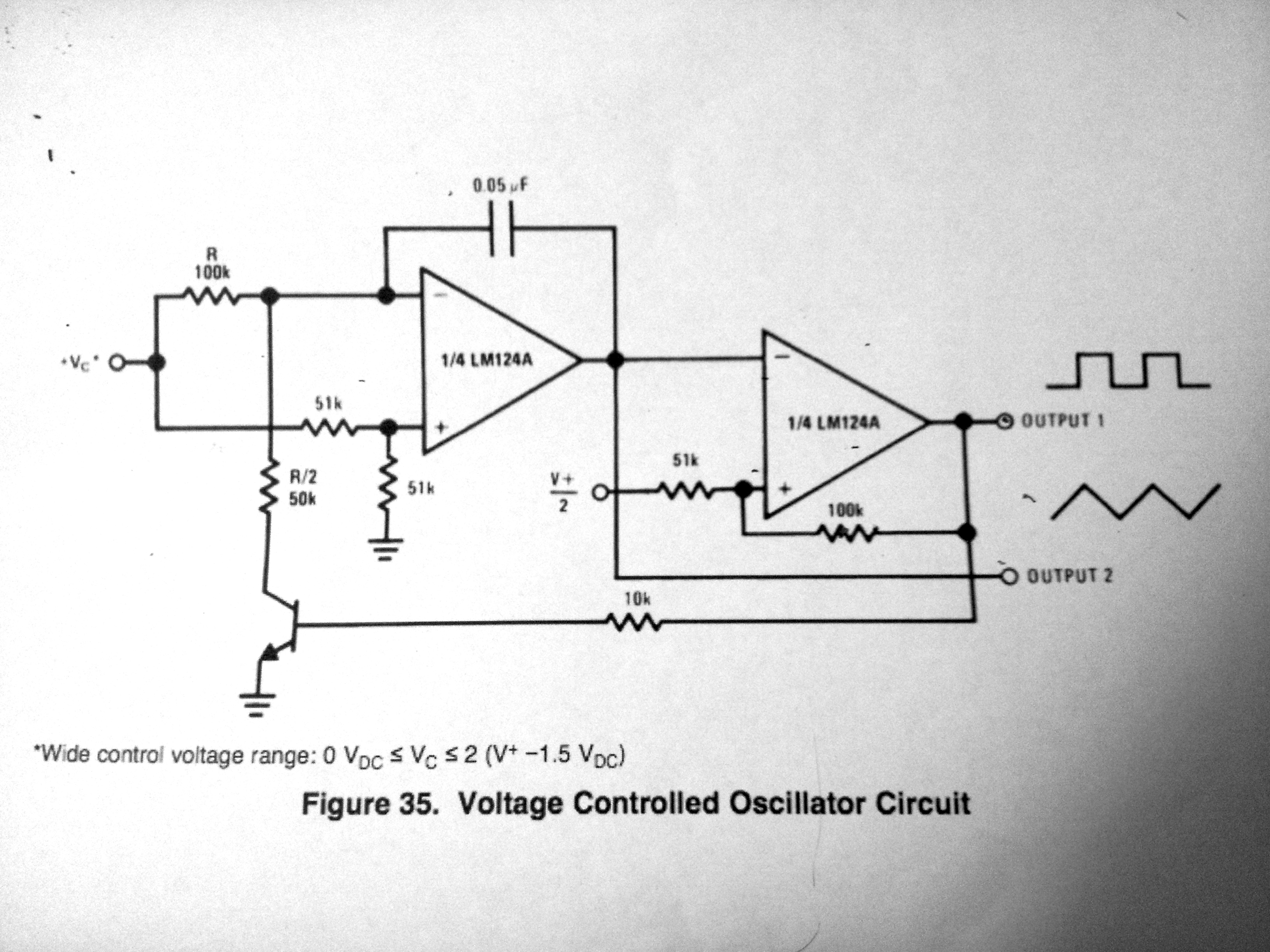

Hi everyone, congratulations on this beautiful forum. This is my first post here, but I have been acquiring a lot of knowledge by just reading other people's threads so far.
Now I want to design my own VCO. I think my understanding of electronics is getting good enough to do it... with help of course Smile My design won't be perfect but I don't mind a bit of glitch and building from the ground up will surely teach me a lot.
So the starting point of my VCO is an integrator / schmitt trigger. I found it on the datasheet of Texas Instruments for the LM124 (p.17) and I recently came across it in the book The Art Of Electronics. It also seems to be the heart of Thomas Henry's VCO-1. I want to make sure I really understand what's going on in those schematics before I start adding to it.
Attached are both the TI and the AOEE schematics. Two things strike me:
1. The 49.9K resistors in the AOEE book are replaced by 51K resistors in the TI datasheet. Why is this? Which option is... better?
2. In the TI schematics there is a BJT with a 10K at the base to "relax" the inverting input of the integrator and allow the cap to discharge. In the AOEE they use a FET with no resistor at the gate and provide a more complex circuit made of two transistors if you decide to use a BJT.
3a. I have built the TI version and I know it works. But I understand that the FET seems to be a better option as it is voltage driven and the op-amp will output mostly voltage and almost no current. Is this right? Why does the TI version even work?
3b. In the AOEE alternative BJT version they use two transistors. Are the basically just amplifying the signal?
Thanks in advance!
R4( references from AOE book) must be exactly 1/2 of R1 to get a symmetrical triangle. I always use 2 pcs.R1 in parallel for R4, or 2 pcs. R4 in series for R1, because then you can choose any standard R value (47k...220k). The same value can be used for R2 and R3 and also for R5,6,7 - then it's simply 1 value for all Rs to get the best precision.
for small currents like here , the CE saturation voltage is only some ten mV, which does not do much concerning symmetry. The circuit can be improved by swapping C and E of the discharge trans. and tweaking the 10k base resistor until you get <2mV Vce-sat. I don't see a reason to use a a second transistor to buffer the comparator because the 3160 can easily drive >1.5 mA, which is required here. A discrete MOSFET can be used instead of the 4007 or a 4066/4053/.... analog switch if you prefer ICs.
The circuit would even work with a diode as discharge switch ( symmetry/linearity not so nice then ...) or use a true comparator with OC like LM339 to get rid of the extra discharge switch.

Thanks for your answer.
Get it.
This is still pretty obscure for me.
1. I did a simulation of the circuit with C and E swapped and the triangle's amplitude increases. Why is that? I thought that C always had to be the positive side and E the negative.
2. Also, in the Art of Electronics, there is no resistor between the 1/2 V+ and the non inverting input of the schmitt trigger. If I don't put this resistor in my simulation I get a very fast / unstable oscillation. If I put it the oscillation works but at only half the frequency indicated on the schematics (f= 150 x (Vin / V+)).
3. I am trying to learn circuit analysis because there is no way around it. Kirchoff is still causing me trouble but I'll get there. Is it out of reach for me to understand how they come up with this equation to calculate the frequency?
this should not be and I didn't see it when swapping C and E in your linked example !?? In fact you will see nothing in these tiny simulation windows, because we talk about some mV difference in a some-volts signal.
You can swap C and E with any transistor and it will still work with the disatvantage of a very low (reverse-) gain and the advantage of a very low saturation voltage.
robynm wrote:
2. Also, in the Art of Electronics, there is no resistor between the 1/2 V+ and the non inverting input of the schmitt trigger. ..
there is one : it is R5 parallel R6 . When you replace the voltage divider R5,R6 connected to V+ by R5 parallel R6 connected to V+/2 you will have an equivalent circuit with the same internal resistance.
don't worry:
1. calculate the upper and lower switching thresholds of the comparator:
if comp. Vout is v+ then R7 is parallel to R6 and the voltage over R5 is 2/3 V+
if comp. Vout is 0V, then R7 is parallel to R5 and the voltage over them is 1/3 v+
2. calculate the output voltage range of the integrator :
amplitude of the triangle is upper minus lower threshold = 2/3V+ - 1/3V+ = V+/3
3. calculate the current that fills C1 :
let comp. Vout = 0 => Q1 is OFF => integrator is ramping down
constant current flowing into C1 == current flowing through R1
noninverting input is held @ Vin/2 so opamp keeps inverting output also @ Vin/2
Ic1 = Ir1 = Vr1/R1 = ( Vin - Vin/2)/R1 = (Vin/2)/R1
4. calculate output voltage ramp (absolute value, sign changes for up/down ramp) of the integrator:
down from 2/3V+ to 1/3V+. Lets calculate the time for this ramp:
voltage change in a capacitor is high when the charging time is high, the charging current is
high and the capacitor is small. here:
deltaV = (Ir1 * Tramp) / C1
because deltaV is the ramp amplitude and Ir1 = (Vin/2)/R1 we can write :
deltaV = V+/3 = (Vin/2)/R1 * T / C1
5. calculate the ramp time T :
T = ( 2 * V+ * C1 * R1) / ( 3 * Vin )
because 1 periode is 2 ramps (up&down) frequency can be calculated as:
f = 1/(2T) = 3 * Vin / ( 2*2 * R1 * C1 * V+)
with R1 = 0.1e6 and C1 = 50e-9 you end up with the formula in the schematics:
f = 150 * Vin / V+

So if we want a 20kHz maximum frequency ( and setting aside the control voltage effects )
f = 3 / ( 4 * R1 * C1 )
Substituting in the values we want ...
20000 = 3 / ( 4 * R1 * C1 )
Multiply both sides by ( R1 * C1 )
20000 * ( R1 * C1 ) = 3 / 4
Divide both sides by 20000
R1 * C1 = 3 / 80000
R1 * C1 = 0.0000375
R1 is measured in ohms and C1 is measured in farads but remember most component values include some form of scaling so a 100k resistor is 100 x 1000 ohms and a 50nF capacitor is 50 x .000000001 Farads.
You want a frequency a bit over 100 times higher so we'll set R1 at 10K ... and substitute that in
10000 * C1 = 0.0000375
C1 = 0.0000375 / 10000
C1 = 0.00000000375 Farads
Lets convert that to nF
C1 = 3.75 nF
Now remember that is for (Vin / V+) equal to 1 - you control voltage is the same as your supply voltage.
That would give you a range from whatever the minimum frequency is up to the audible limit but your control is gong to be awful. You are unlikely to be precisely able to get any particular frequency because you wont be able to generate accurate enough voltages. Note that the original circuit didn't go all the way to 0 Hz. I'm guessing that you are only going to get a tunable range from 10KHz to 20KHz.
beautiful just beatiful...tnks for your explanation now i get it...
so if i follow the rule where i take in consideration vin/v+ everything would work ok?... cos if a take the first circuit and just change the 50nf to 1nf..yes the freq..goes up BUT the triangle wave dont follow the threshold of the smith tigger/comparator any more so the amplitud with more freq... increase alot..i mean if threshold is i.e. +-2v the triangle wave form has to be 4vpp all way, but that not happen if i change only the cap to lower value... the waveform increase a lot in amplitud
so with this rule math taking vin/v+ in consideration the triangle wave will follow the threshold???
tnks again Hail the Master Hail the Master Hail the Master
