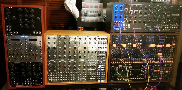

Greetings all,
I haven't posted anything in a very long time so I thought I would drag out the PolyArp and see what I could do today. I found a MIDI file lurking on my computer with no name, just a number. It has a lot of cool arpeggios so I made a recording of it. All of the sounds are from the PolyArp, except the drums.
Since it didn't have a name, I called the song ArpAmbience. If you recognize it, please let me know.
Cheers and Happy New Year!
THeff

I wasn't sure how playable it was going to be due to the pitch drift of the four analog VCOs, but I am very pleased with the results. I made an attenuation patch cord so that I could plug a guitar tuner into the Sine output of each oscillator and that makes tuning fast and easy. I hope you build a cool synth in the near future.
