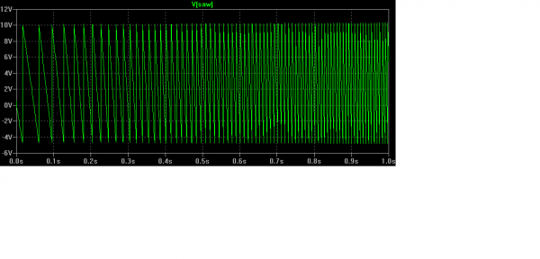

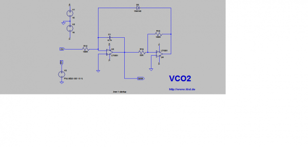

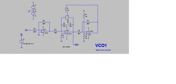

here are two schematics with an LTSpice Simulation.
It looks goad at the first sight and i will build them on Breadboard and will do some real life measurements.
The graphic shows a linear sweep with an control voltage from 125mV to 1V
Here you can follow the progress..

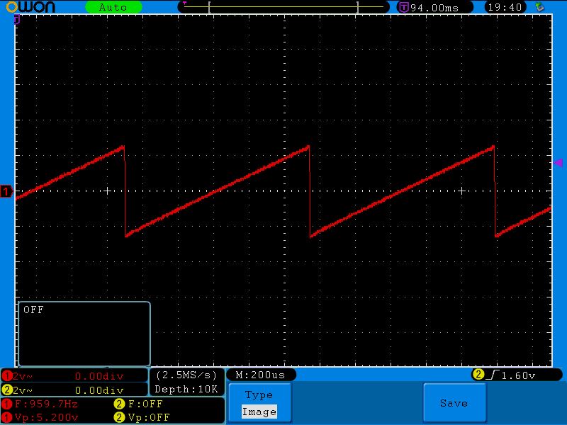

This is a picture of the two VCOs on breadboard.
Test Results comming soon...

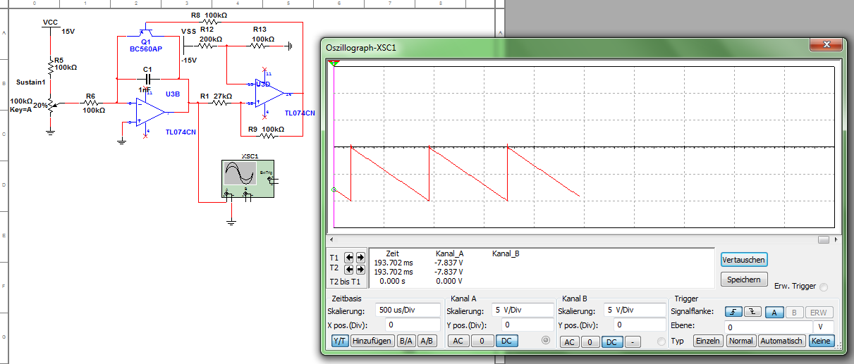

i have built the third VCO (Korg Style) on breadboard.
The simulation did not work but real life circuit runs.

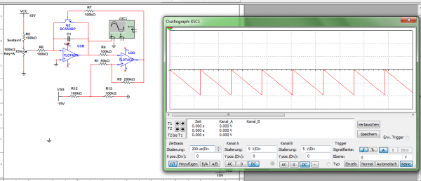

PostPosted: Wed Feb 05, 2014 10:13 am    Post subject: Reply with quote  Mark this post and the followings unread
For your collection
simulated, breadboarded
