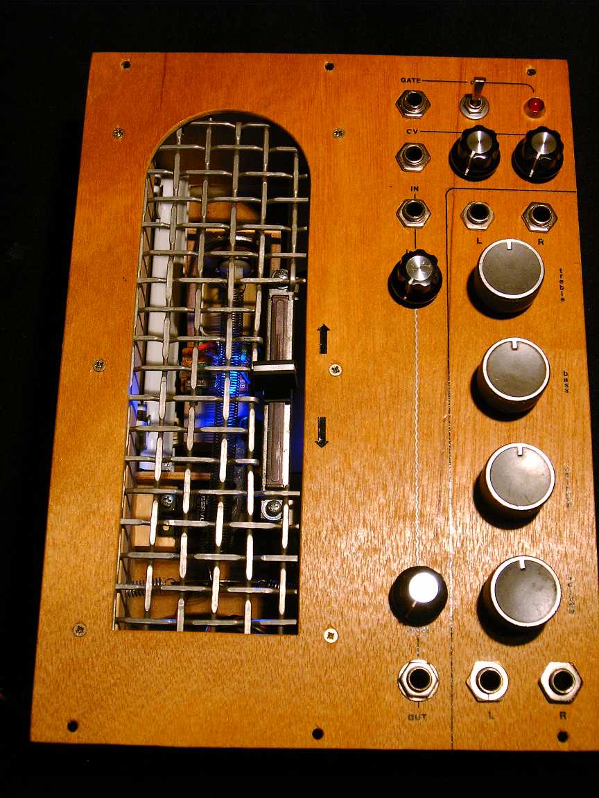

Posts: 5930
PostPosted: Sun Feb 16, 2014 11:24 am    Post subject: Reply with quote  Mark this post and the followings unread
Cool
Frankensynth - spring reverb

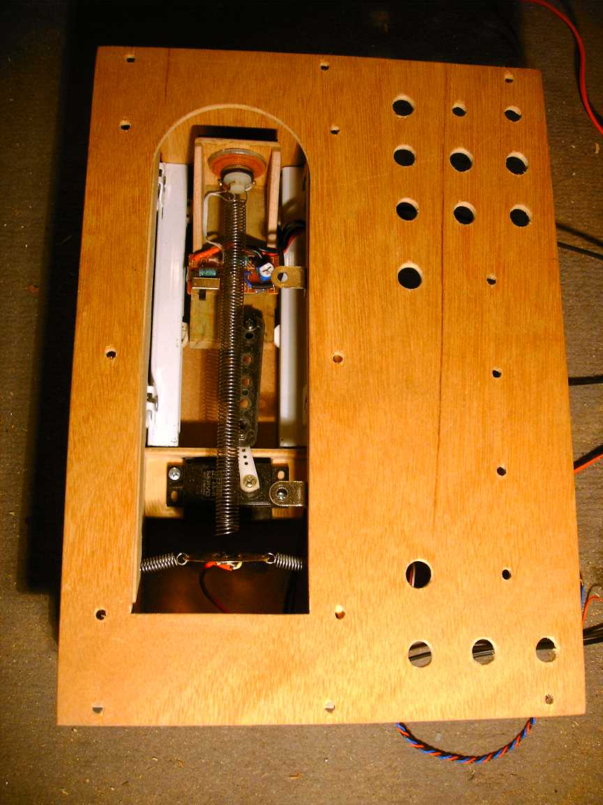

Posts: 5930
PostPosted: Sun Feb 16, 2014 3:03 pm    Post subject: Reply with quote  Mark this post and the followings unread
Thanks Very Happy
So what I'm working on is a spring reverb as is probably clear by now. I used the transducer + amplifier (the little board on the car/sled) from a
Paper Jamz guitar amplifier, the spring from a (toy) echo microphone and a piezo pickup connected to a preamp I found in my box of old circuits.
While I was thinking about how to construct it I got the idea to make one end of the spring adjustable to control the length/tension. The next idea
was to control it with a servo. At first I thought it was just a silly idea, but I gave it go to see if I could do it. I used some curtain rails + rollers
to make the adjustable part and then figured out a way to control it with the servo. I already had a simple servo tester to control it with which
was my original plan, but since a servo is pulse width controlled it's pretty easy to make that voltage controlled. Twisted Evil
I'll post the circuit for that + more info later.

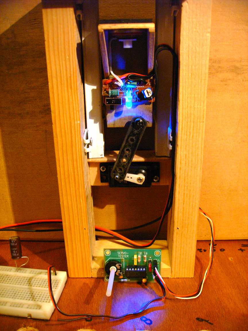

PostPosted: Mon Feb 17, 2014 3:37 pm    Post subject: Frankensynth spring reverb
Subject description: Transducer & amplifier info
I finished the spring reverb, so here are some more details.
TRANSDUCER:
As mentioned I used the transducer from a Paper Jamz guitar amplifier. It's just a cardboard box with an amplifier design printed on it and there's
a plastic battery compartment on the back which also has the input jack and power on/off switch + LED. I expected that there would be a small
speaker inside but to my surprise it was a transducer glued to the cardboard. Shocked It basically is a speaker but it uses the front of the box
as a "cone". (someone posted some photos of it here).
I needed a way to connect the spring to it and my first idea was to drill some small holes in the little cardboard cilinder that has the coil on it.
Then bend a little wire that goes through the holes which I could hook the spring on. For my first tests I drilled 2 small holes and simply left the drill
in so I could attach the spring to it. This worked pretty well but I wasn't really happy that it left the gap between the magnet and voicecoil
exposed, and I found something better. A little plastic 'thingy' that I just glued onto the cilinder (which has a plastic ring on top) and I drilled a
hole in it to hold the spring.
AMPLIFIER:
Driving the transducer was easy because it came with an amplifier. I used an old 5v phonecharger to power it since it needs 4.8V..6V (4 batteries),
and also because it uses more current than I would like to pull from my main PSU. It had a stereoinput jack but only one transducer so I took a
look at the PCB to see how they were mixed together. I found out that there's a capacitor and resistor in series with each input, and the resistors
are attached together at one input of the chip. I didn't see anything else connected to it so I guess it's just a passive resistor mixer. I also noticed
that there was a 100 ohm resistor to ground on each input. This might have something to do with what it's originally intended for but I removed
them. I also removed the capacitor and resistor from one input and the connector which gave me space to solder on a small trimpot to adjust the
input level.
I replaced the standard red LED with a bright blue one which is mounted in such a way that it illuminates the spring and piezo disc. Both the
transducer and amplifier are mounted on the "sled" so the LED moves up and down too. Very Happy

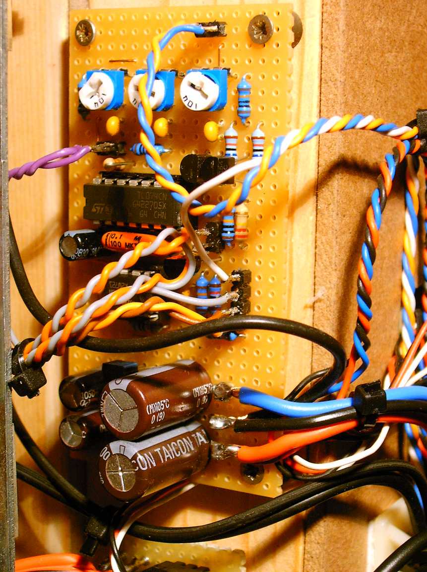

PREAMP:
The preamp came from my box of old circuits. It was a microphone/MD preamp of which I had only build the microphone section. It was made
for a single supply using a fake ground so I made some changes to the circuit to use it with a dual supply. I noticed I could faintly hear the sine
wave VCO's so I added resistors and capacitors to the power line to filter out any noise.
Frankensynth - Spring reverb preamp schematic
 Filesize:  29.42 KB
 Viewed:  655 Time(s)

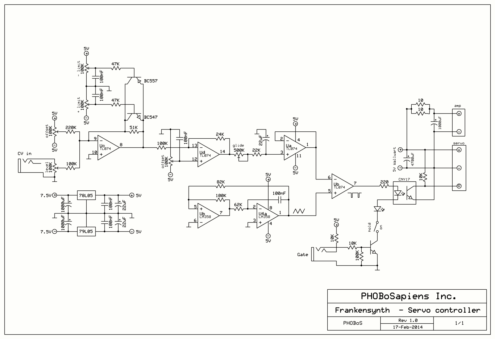

Posts: 5930
PostPosted: Mon Feb 17, 2014 6:52 pm    Post subject: Frankensynth spring reverb
Subject description: Servo Controller
SERVO CONTROLLER:
So I got this silly idea of making the spring adjustable and voltage controlled (thanks brain ). When I first tested the servo with the
tester it worked fine, but when I tried to control it with a circuit consisting of a triangle wave oscillator + comparator it started to behave very
randomly. It was actually quite fun to watch but not exactly what I had in mind. (I might have a recording of it). Turned out that it was caused by
the servo causing noise in the powerline eventhough I was using a seperate supply for it, but then again that one isn't very powerful.
Also the servo moves to one end position with a pulsewidth of 1mS and the other end at 2mS which translated to a control voltage of only 2mV.
So I did a couple of things. Instead of using the same 5v powersupply as I used for the servo I used the dual main supply and added some regulators
for a more stable dual voltage of +/- 5 V. Besides a more stable voltage this also increases the amplitude of the saw wave which in turn increases the
range of the control voltage. It's still pretty small though.
For the CV input I used the same setup as used for the waveshaper, with offset control, level control and limiters (so the servo isn't forced to move
beyond it's range). I also added a glide control for smoother movement which makes it possible to modulate it with a slow square wave aswell.
I used an optocoupler to keep it isolated from the servo supply to prevent any noise. There's also a switch to turn the control signal off which halts
the servo (it doesn't move by the spring tension). This can also be controlled by an external signal which can work as a sample track and hold together
with the CV input.
Frankensynth servo controller schematic
 Filesize:  77.68 KB
 Viewed:  629 Time(s)
servo controller perf
 Filesize:  122.91 KB
 Viewed:  647 Time(s)

Some additional information.
Besides the springreverb I also mounted a passive tonecontrol circuit on the same panel. It also came from my box of circuits and it's something I
took out of an old amplifier many years ago. Because it is passive it just has 2 inputs and 2 outputs and no active components, so I just added 4
connectors for the inputs and outputs. I wired the output from the reverb to the left input by using the switch contact on the socket and wired the
input of the reverb to the right channel also using the switch contact. This turns the balance control into a sort of wet/dry control when the outputs
are mixed together. The in-/outputs of the reverb also have attenuators to adjust the levels.
I used foam on the top and bottom of the reverb chamber to dampen vibrations from the case and I also used rubber grommets between the
panel and chamber for the same reason. I had to cut a bit off to be able to get it mounted in the case and this left a gap which I simply covered
with a piece of masking tape.
Here's the finished module Cool
