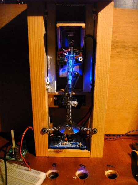

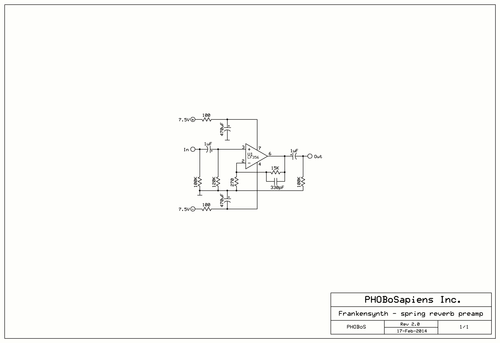

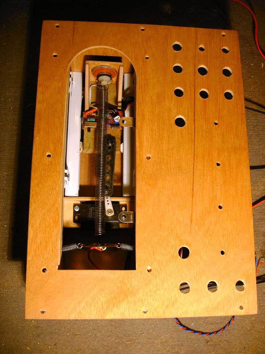

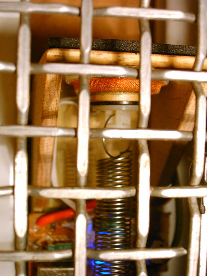

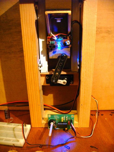

So what I'm working on is a spring reverb as is probably clear by now. I used the transducer + amplifier (the little board on the car/sled) from a
Paper Jamz guitar amplifier, the spring from a (toy) echo microphone and a piezo pickup connected to a preamp I found in my box of old circuits.
While I was thinking about how to construct it I got the idea to make one end of the spring adjustable to control the length/tension. The next idea
was to control it with a servo. At first I thought it was just a silly idea, but I gave it go to see if I could do it. I used some curtain rails + rollers
to make the adjustable part and then figured out a way to control it with the servo. I already had a simple servo tester to control it with which
was my original plan, but since a servo is pulse width controlled it's pretty easy to make that voltage controlled.
I'll post the circuit for that + more info later. _________________ "My perf, it's full of holes!"

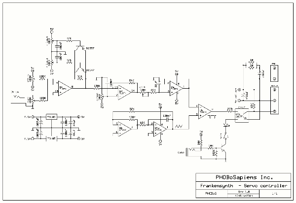

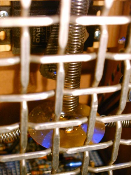

SERVO CONTROLLER:
So I got this silly idea of making the spring adjustable and voltage controlled (thanks brain ). When I first tested the servo with the
tester it worked fine, but when I tried to control it with a circuit consisting of a triangle wave oscillator + comparator it started to behave very
randomly. It was actually quite fun to watch but not exactly what I had in mind. (I might have a recording of it). Turned out that it was caused by
the servo causing noise in the powerline eventhough I was using a seperate supply for it, but then again that one isn't very powerful.
Also the servo moves to one end position with a pulsewidth of 1mS and the other end at 2mS which translated to a control voltage of only 2mV.
So I did a couple of things. Instead of using the same 5v powersupply as I used for the servo I used the dual main supply and added some regulators
for a more stable dual voltage of +/- 5 V. Besides a more stable voltage this also increases the amplitude of the saw wave which in turn increases the
range of the control voltage. It's still pretty small though.
For the CV input I used the same setup as used for the waveshaper, with offset control, level control and limiters (so the servo isn't forced to move
beyond it's range). I also added a glide control for smoother movement which makes it possible to modulate it with a slow square wave aswell.
I used an optocoupler to keep it isolated from the servo supply to prevent any noise. There's also a switch to turn the control signal off which halts
the servo (it doesn't move by the spring tension). This can also be controlled by an external signal which can work as a sample track and hold together
with the CV input.

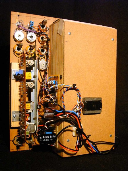

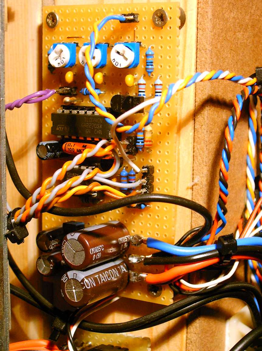

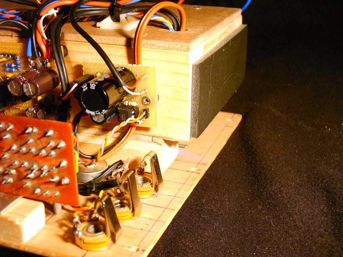

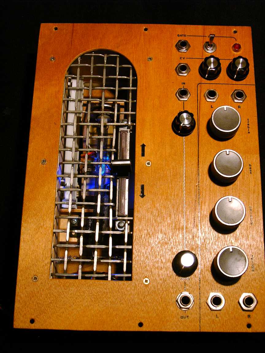

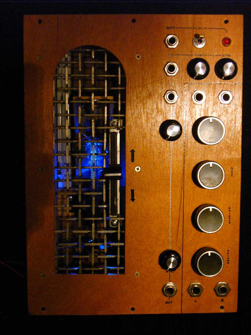

Some additional information.
Besides the springreverb I also mounted a passive tonecontrol circuit on the same panel. It also came from my box of circuits and it's something I
took out of an old amplifier many years ago. Because it is passive it just has 2 inputs and 2 outputs and no active components, so I just added 4
connectors for the inputs and outputs. I wired the output from the reverb to the left input by using the switch contact on the socket and wired the
input of the reverb to the right channel also using the switch contact. This turns the balance control into a sort of wet/dry control when the outputs
are mixed together. The in-/outputs of the reverb also have attenuators to adjust the levels.
I used foam on the top and bottom of the reverb chamber to dampen vibrations from the case and I also used rubber grommets between the
panel and chamber for the same reason. I had to cut a bit off to be able to get it mounted in the case and this left a gap which I simply covered
with a piece of masking tape.
Here's the finished module
Description: |
Frankensynth spring reverb |
Filesize: |
119.35 KB |
Viewed: |
551 Time(s) |
Description: |
Filesize: |
105.54 KB |
Viewed: |
549 Time(s) |
Description: |
Frankensynth spring reverb (backside) |
Filesize: |
120.69 KB |
Viewed: |
551 Time(s) |
Description: |
Frankensynth spring reverb (powerboard for servo & amplifier and foam on the bottom) |
Filesize: |
115.88 KB |
Viewed: |
555 Time(s) |

Looks and sounds amazing! The grille looks nice too, although I thought you may have wanted direct access to the spiring for plucking it. _________________ Muied Lumens Sub Forum

Muied Lumens wrote: | Looks and sounds amazing! The grille looks nice too, although I thought you may have wanted direct access to the spiring for plucking it. |
thanks
yeah plucking the spring was a reason why I wasn't sure about the grille (I can still remove it btw). But plucking the grille gives a similar sound,
without overdriving the preamp. And I still have more springs and piezo's which I could use for a springboard anyway. _________________ "My perf, it's full of holes!"
