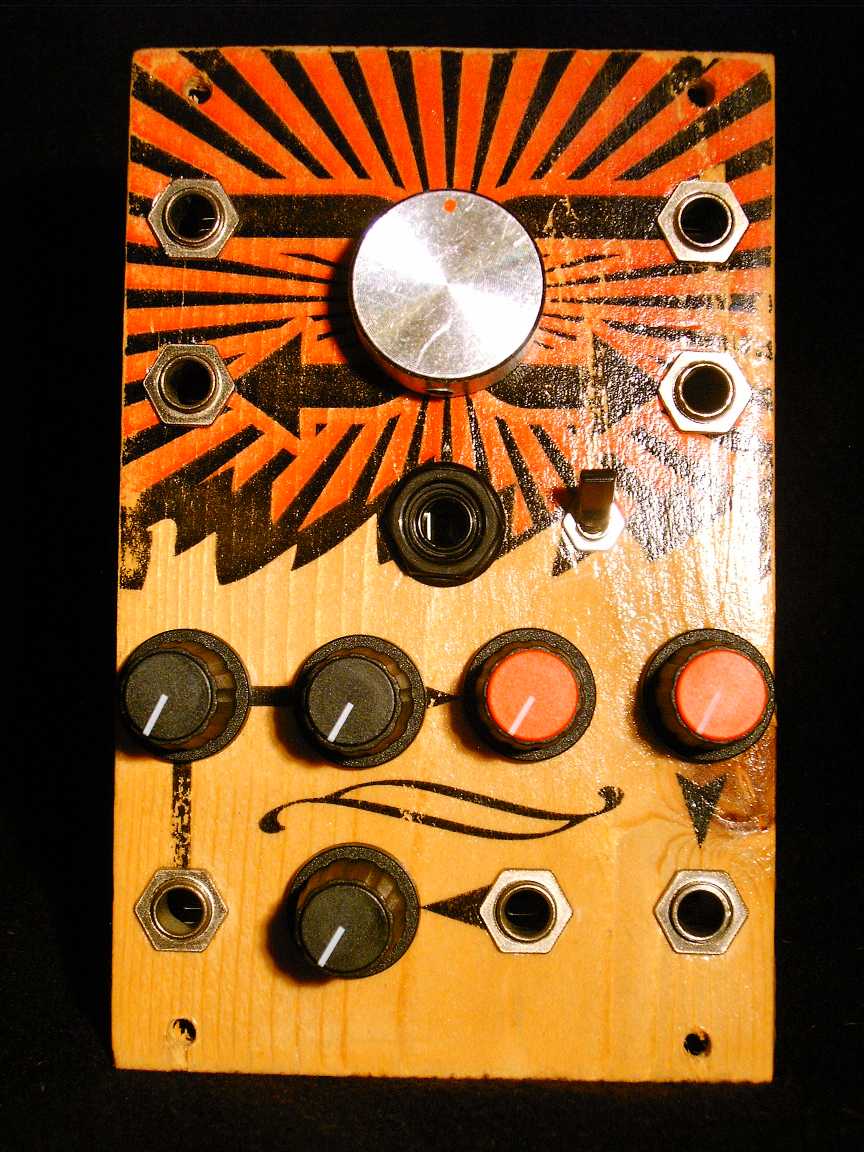

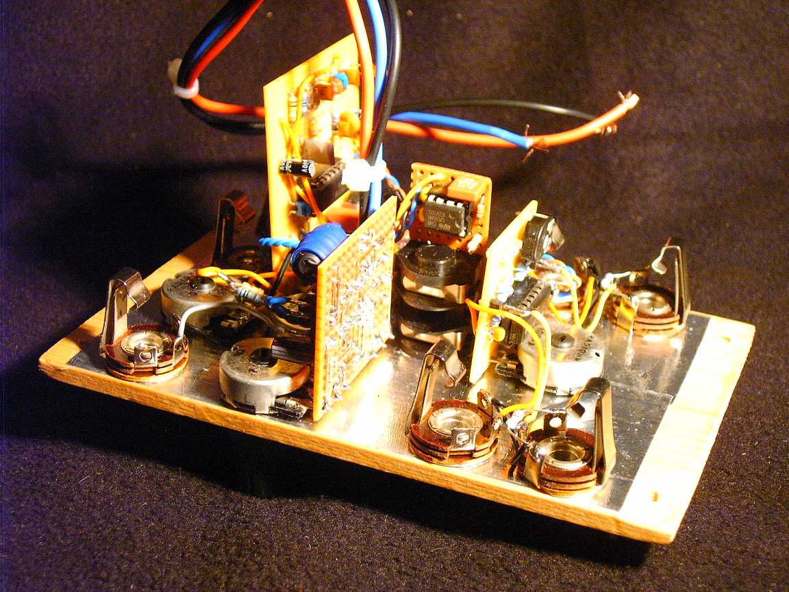

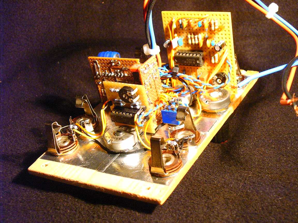

I finished another module last week. This one uses 2 circuits: One is some sort of mono/stereo control, or actually I don't know what it is or where I
got the schematic from, maybe someone recognizes it. The other circuit is a windsound generator consisting of a noise source and a bandpass filter.
So I split it up in those two parts and added an amplifier and a switch to choose between wind mode (output of the filter amplified) or split mode
(output of noise source amplified). I also added a vactrol to have a bit of control over the filter frequency.
Frankensynth Wind Filter
 Filesize:  139.8 KB
 Viewed:  752 Time(s)
 Filesize:  144.73 KB
 Viewed:  724 Time(s)
 Filesize:  154.63 KB
 Viewed:  742 Time(s)
 Filesize:  126.83 KB
 Viewed:  745 Time(s)

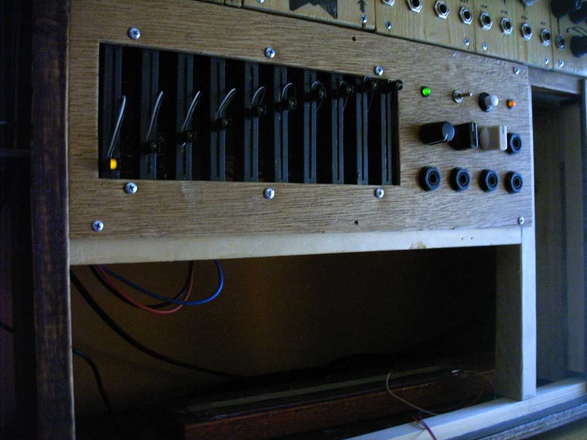

PostPosted: Sat Apr 26, 2014 6:23 am    Post subject: Reply with quote  Mark this post and the followings unread
I added a sequencer made from a simple light chaser. The original circuit used two 4017's, one was used as a divider for a slower speed setting and
the other to sequence 4 lights. Tempo was controlled by either the build in 555 LFO but an external CLK could be used aswell. I added a transistor to
the output of the 555 to invert the output, since the dutycycle was ±95/5 (on/off).
I made use of having 2 4017's by adding a swinggenerator. Because I only have 12 step rotary switches I just wired all the outputs to the switch.
The 2 leftover NAND gates are used for a buffered CLK and reset input. I used slidepots and glued some LED's to them secured with some heatshrink.
The pots are 25K log stereo pots and not really great, which is why I nevered used them before. Some of them are so bad that I had to use the
other 'side' (stereopots) to get it working. The whole circuit is powered by 5V using a 7805 regulator that was already on the PCB. Well actually it
wasn't on there anymore but there used to be one so I just had to put it back.
I made a panel out of MDF covered with a woodgrain print because I didn't have anything else left. But I didn't really like it, so I kept my eyes
open and found a nicer piece of wood in a container at the side of the road. So I used that to make a new panel and it looks much better.
An old meccano set (not the real stuff though) came in handy for mounting the slidepots and PCB. Cool
I will probably make 2 simple 555 based VCO's next , made from 2 similar strobelight controller circuits.
Frankensynth sequencer (no labels yet but I might put something on the panel)
 Filesize:  73.85 KB
 Viewed:  725 Time(s)
 Filesize:  83.78 KB
 Viewed:  710 Time(s)

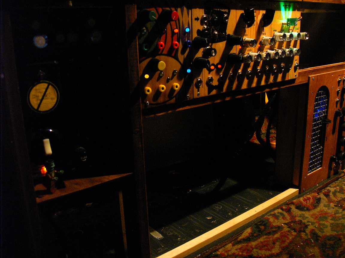

Posts: 5949
PostPosted: Sun Dec 06, 2015 7:17 am    Post subject: Reply with quote  Mark this post and the followings unread
No new photos/videos or updates. I have some other stuff to finish first and I'm out of 1/4" sockets.
But here's an an older photo Smile
you'll probably like this one too.
 Filesize:  1.42 MB
 Viewed:  610 Time(s)
