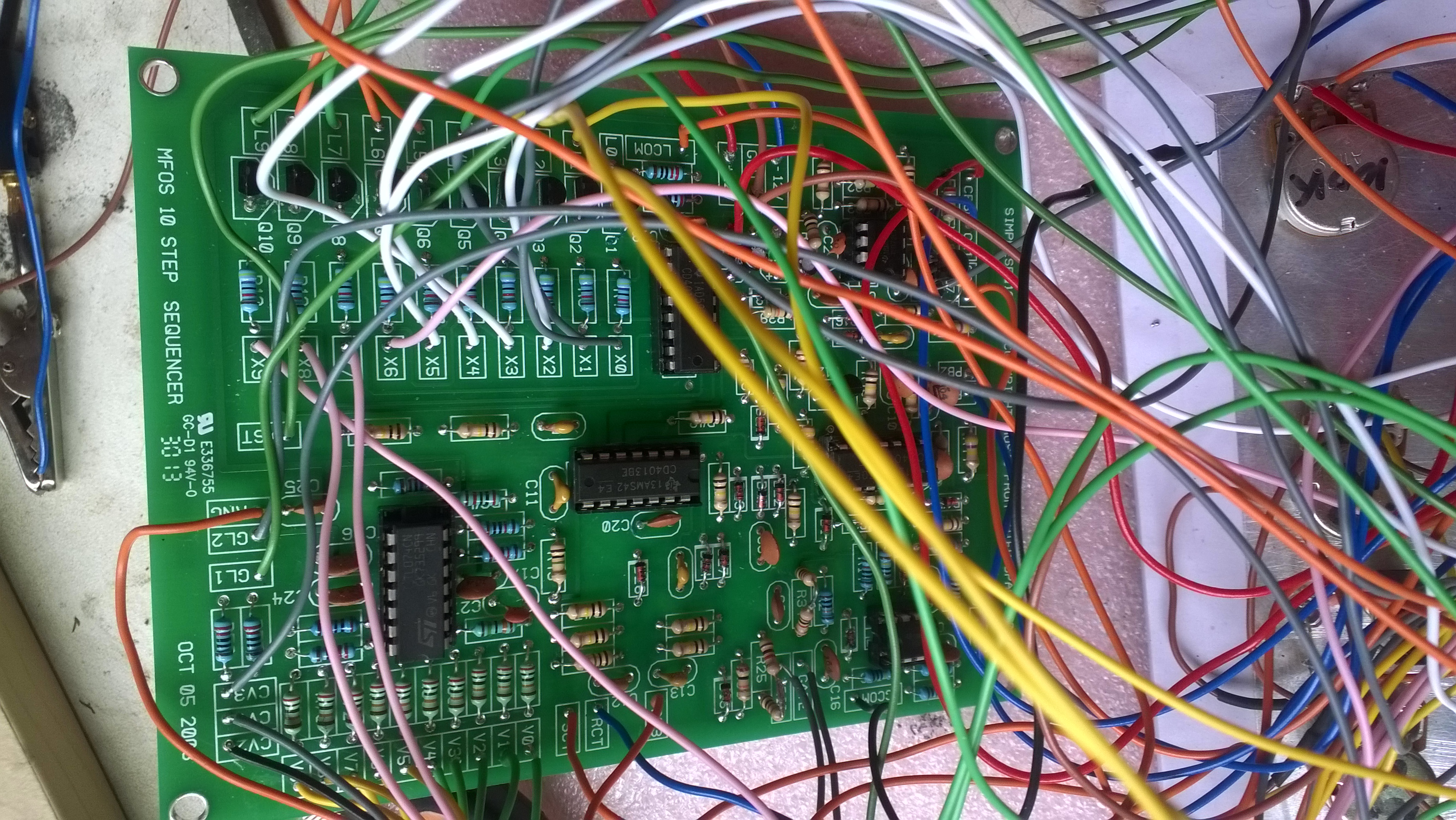

Hello I am new to electro music, have found it a useful resource when stuck. I am now Stuck and out of ideas.
I am a amateur hobbyist, I got into electronics about 2 years ago and have built an 8 step 555 / 4017 based sequencer with APC oscillator and a portamento. Plus a 16 step sequencer 555 / 2x 4017 with APC oscillator. I bought and loved building the mfos noise toaster and have built a Thomas Henry VCA. Very Happy
All my builds had various issues and needed trouble shooting before success, the mfos 10 step has got me stumped. Confused
What works
1) start/stop push button
2) step push button
3) reset push button
4) last step selector dial all steps
5) stop/reset/10 steps switch
6) clock rate (audible oscillation)
7) CV output range (I can hear a slight change in tone)
Cool LEDs light up with each step
What does not work
1) no sequencing
2) all gate switches, whether on or off, the LEDS stay on
3) no portamento
I originally had C8 and C11 the wrong way round, did'nt know about tantalum cap polarity, removed and replaced with new ones.
All ICs have power and ground seems ok
Have since swapped out all chips and have replaced Q11 2n5457 3 times. The last time I soldered a cut down piece of socket and 'plugged' the jfet in, to avoid soldering it, still no luck Mad
Q11 shows -2.4v on gate, 0v on drain, 5.4v on source. When taking these readings placing the probe on the Gate starts the LEDs sequencing !! but no change to clock sound.
Can anyone help or advise ?
 Filesize:  2.66 MB
 Viewed:  450 Time(s)
Area of concern is U3 and Q11 jfet. No voltage on source
 Filesize:  2.4 MB
 Viewed:  413 Time(s)
 Filesize:  2.23 MB
 Viewed:  445 Time(s)
PostPosted: Sat May 31, 2014 10:01 pm    Post subject: Reply with quote  Mark this post and the followings unread
It's really not clear what you are saying about the clock. You say that the LEDs light in sequence, but you've focused on the FET in the clock oscillator section, as if the clock is not oscillating. But then how could you hear audio??
My suspicion if the clock is not working is that your -12V rail is not correct. You should have -12V, not ground, at pin 4 of U2 & U3, and pin 11 of U6. These are the only three chips that use the -12V rail, and if the clock isn't working all three sections controlled by these chips are down--the -12V supply is the obvious thing they have in common.

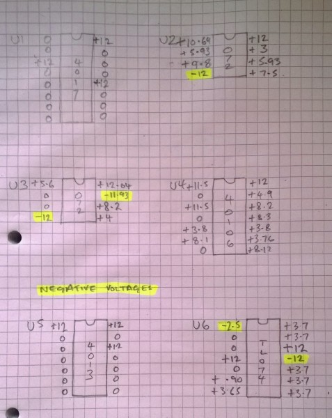

PostPosted: Sun Jun 01, 2014 5:42 am    Post subject: More info on mfos 10 step issues
Subject description: think i'm barking up the wrong tree
Thanks for reply, Very Happy pretty sure negative power is good.
I've added image showing what power the chips are getting.
I've also added this link, short video of sequencer in action.
www.youtube.com/watch?v=wwW0WVffULM&feature=youtu.be
I think I am missing the obvious Embarassed
pin out readings.
 Filesize:  1.47 MB
 Viewed:  396 Time(s)
PostPosted: Sun Jun 01, 2014 8:49 am    Post subject: Reply with quote  Mark this post and the followings unread
Are we listening to the raw CV out in your video? CV's are meant to control other synths, not be sound sources in themselves. If that's not what we're listening to, I think it would help me understand to know what we *are* hearing.
I'm kind of baffled how we would hear the clock out on the CV out at all. What should be happening is the clock is doing the same thing as the step button--moving each step forward.
Here's a similar sequencer I built; I'm using the soundlab mini synth built into a cigar box as the sound source.
[video]http://www.youtube.com/watch?v=8sdn6WWC8xg[/video]
The only really signficant difference with Ray's is that he's using a "real" oscillator rather than a 555 chip.
If I had to guess at this point, I'd say you have some portion of the clock circuit shorted to somewhere after the CV pots going into the output section. Not clear how that could happen, the circuit sections are on opposite sides of the board, but....

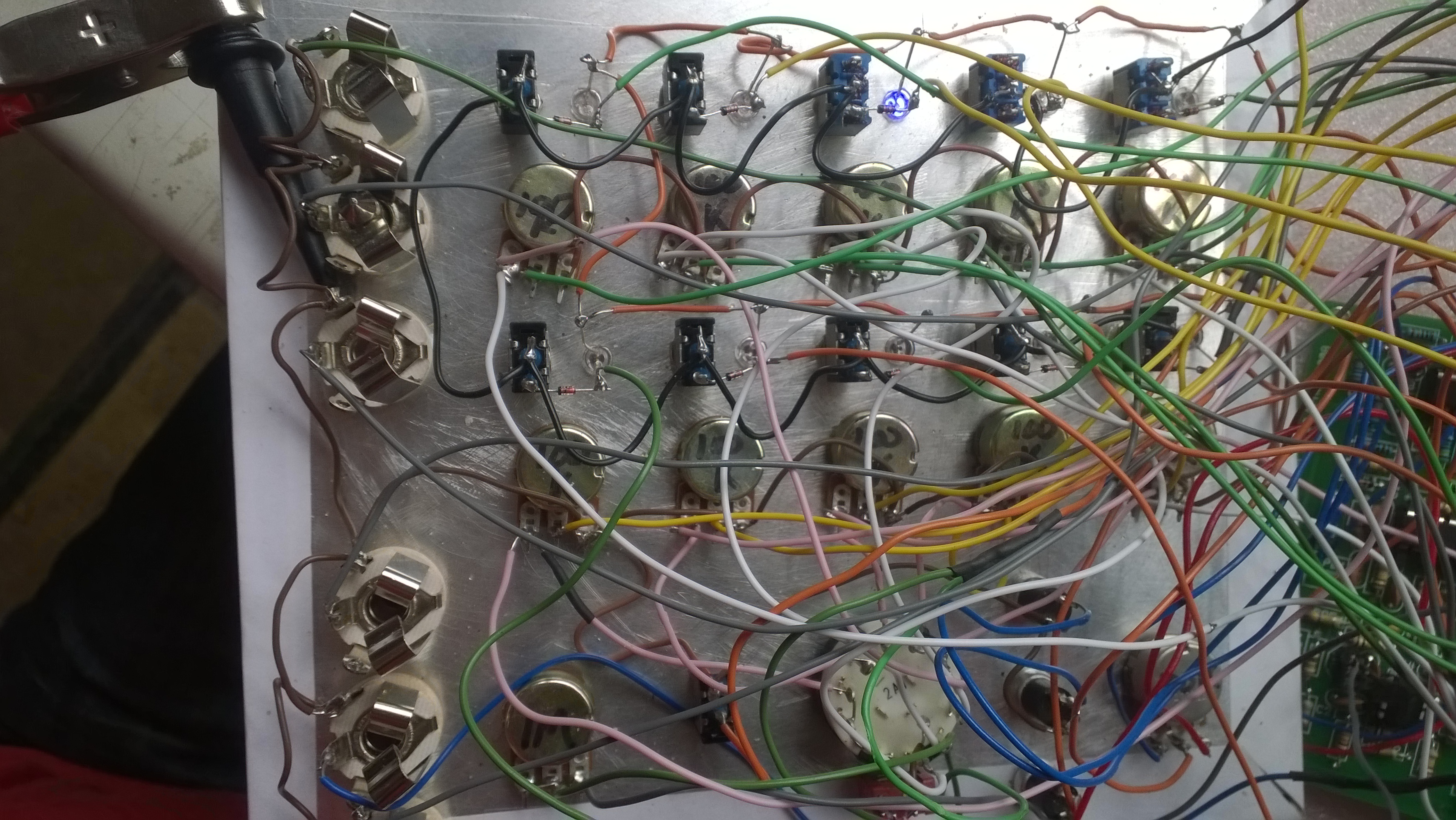

Its just ocurred to me that all the jack sockets may be wired back to front, the ground and signal wires are, i think, the wrong way round.
PostPosted: Sun Jun 01, 2014 11:05 am    Post subject: Reply with quote  Mark this post and the followings unread
That would certainly cause some interesting problems Very Happy
Cato
Joined: May 29, 2014
Posts: 44
Location: uk
PostPosted: Sun Jun 01, 2014 11:07 am    Post subject: MFOS 10 Step Sequencer not sequencing
Subject description: switched jack wires
Yes I had wired the jacks back to front. Now no sound from external start, 'bass' sound through gate out, lighter 'ticking' sound from trigger out, and no sound from any of the CV outputs.
All the other issues remain, am thinking I may have shorted something somewhere because of this obvious error. So I had the ground wires connected to the signal of the jack and the signal wires connected to the jacks ground.

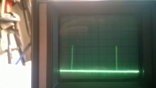

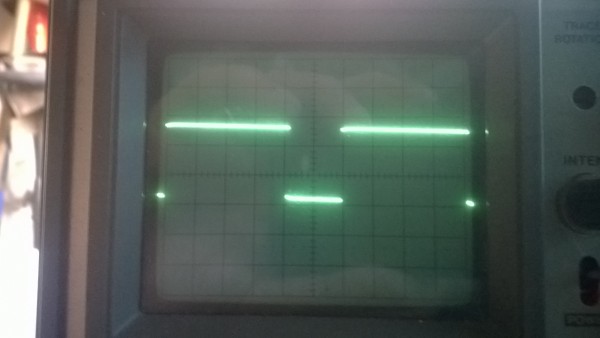

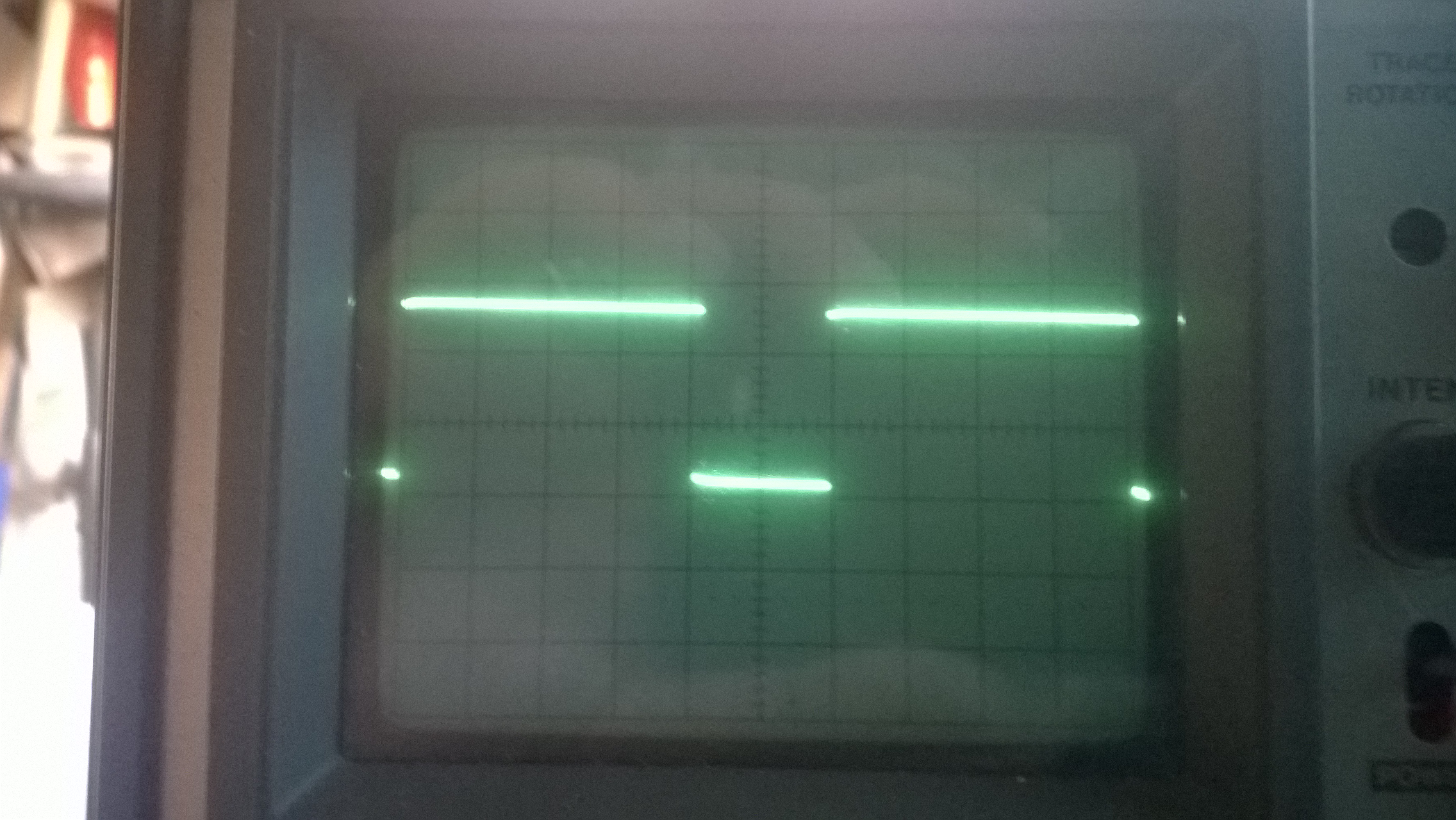

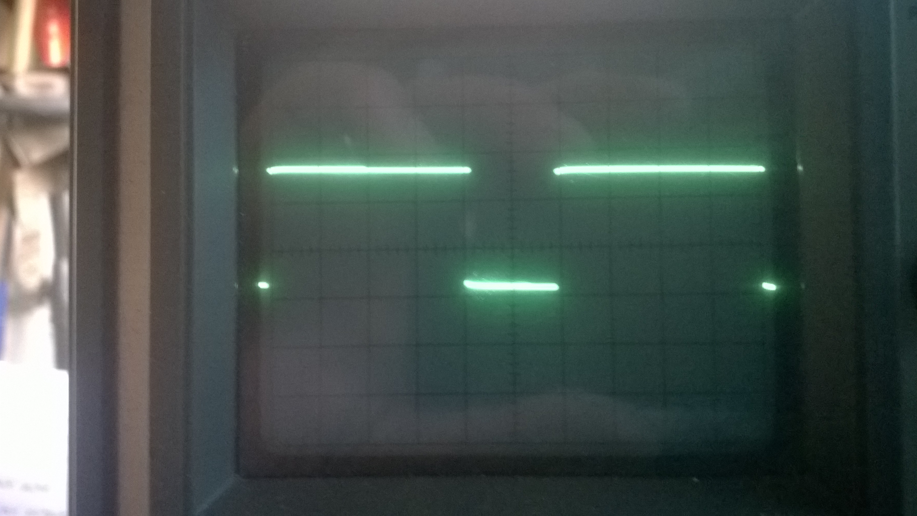

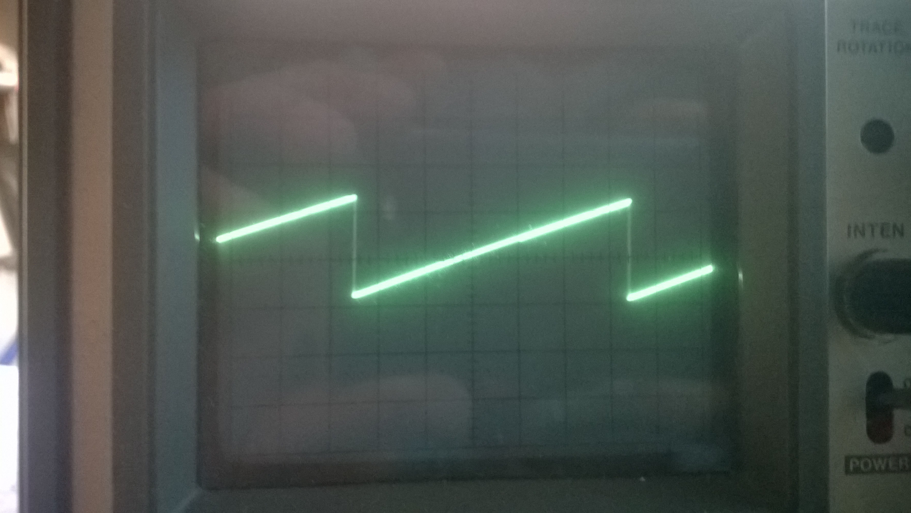

PostPosted: Fri Jun 20, 2014 3:15 pm    Post subject: Reply with quote  Mark this post and the followings unread
Some scope images for clarity
 Filesize:  2.4 MB
 Viewed:  345 Time(s)
 Filesize:  2.42 MB
 Viewed:  333 Time(s)
 Filesize:  2.45 MB
 Viewed:  381 Time(s)
 Filesize:  2.48 MB
 Viewed:  371 Time(s)
 Filesize:  2.4 MB
 Viewed:  386 Time(s)
