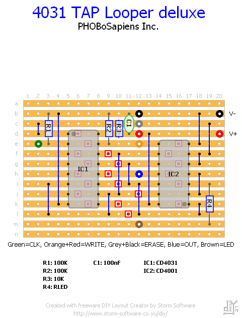

I finally got my hands on some CD4031s to built my own TAP looper. Very Happy But there was one thing I didn't really like about the original circuit;
the not so standard Normally Closed switch, and the fact that it is placed within the data line so it can't be controlled by other logic. But after
studying the datasheet I figured out a way to use a more standard Normally Open switch. And because it is connected between GND and a pin
of the CD4031 it can now be controlled by other logic. The discrete OR gate (diodes + resistor) add the WRITE signal to the output so you can
directly see/hear what you are doing.
I also designed a deluxe version which has a nicer output in the form of an actual logic gate and it also sends the ERASE signal through to the
output. The spare NOR is used to drive an LED.
And I designed a stripboard layout for the deluxe version for those who like to use that.
 Filesize:  30.56 KB
 Viewed:  1060 Time(s)
 Filesize:  40.6 KB
 Viewed:  1035 Time(s)
 Filesize:  17.68 KB
 Viewed:  878 Time(s)

PostPosted: Sun Dec 01, 2019 4:24 pm    Post subject: Reply with quote  Mark this post and the followings unread
Just a quick question... to debounce the switches on these, would it be as simple as strapping a cap (100nF?) over the switch contacts?
Posts: 5967
PostPosted: Sun Dec 01, 2019 4:46 pm    Post subject: Reply with quote  Mark this post and the followings unread
hmm, the circuit somewhat debounces itself unless you run it at a very high frequency because bits are only added/removed on
a low-to-high transition of the clock. However because it also routes the switches to the outputs bouncing can occur here.
A simple capacitor can sometimes improve things but can also make it worse. With these digital circuits you want transitions
to be as fast as possible, so no rising/falling slopes. Ideally you would use an RC low pass filter followed by a schmitt trigger or
comparator with hysteresis after the switch. It depends a lot on the switches you use though and what you are triggering with
the output. Something like a drummodule or envelope generator will be more forgiving than a clock input.

PostPosted: Sun Dec 01, 2019 4:54 pm    Post subject: Reply with quote  Mark this post and the followings unread
Ah yes... the 4031 doesn't seem to mind my switches, but one of the cool things about your setup with the switches passing through to the output, so when I'm not using the looper, I can still use the switches as a manual trigger. Sometimes they can be a bit wonky this way Smile
I take it, then, that the best way to resolve this is with a similar setup to the one you added to someone else's design here: http://electro-music.com/forum/phpbb-files/button_gated_oscillator_127.gif ?
Posts: 5967
PostPosted: Mon Dec 02, 2019 7:48 am    Post subject: Reply with quote  Mark this post and the followings unread
yep, the configuration used in the 'button gated oscillator' should work. Here's a version which has the RC low pass filter,
drawn by Scott/JovianPyx. Having a resistor in series with the switch is also a bit better for the switch and the cap otherwise
you are shorting it out to GND. Not really a big problem which such tiny caps but it could prolong the life of those components.

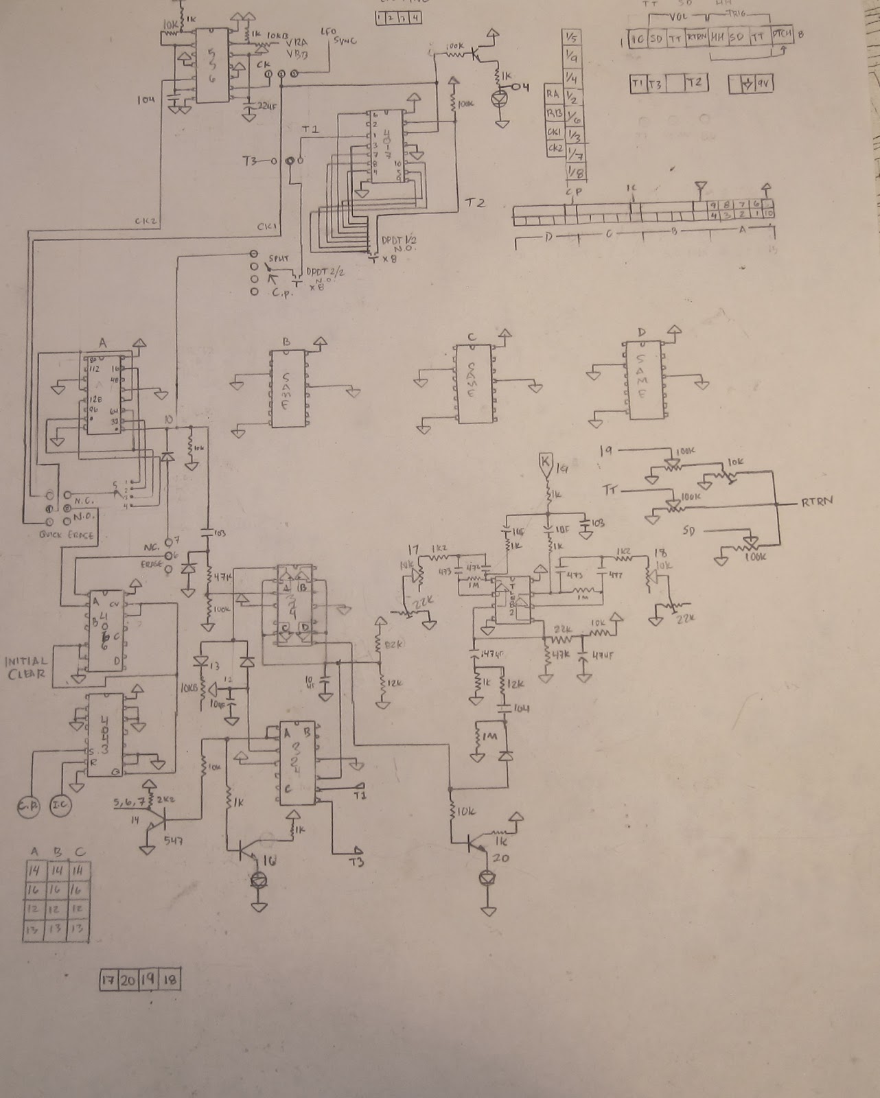

Your 8 key entry pad isnt 8 notes, it's just 8 buttons that each are encoded into 3 bits as high or low. Which means in practice you can encode one step across all 3 4031s with a single key entry.
And this combination then is the data input for another shift register which has 8 individual outputs? Does the 4051 then just give a single output based on the inputs <aaaah> So.... This process encodes those 8 switches to 3 bit binary which is saved as a 64 gate sequence by 3 4031s which then sends their 3 bits back to the 4051 which decodes it back to the 8 pots for cv output...
Did I get it?
Lance
Top Top
Joined: Feb 02, 2010
Posts: 266
Location: California
PostPosted: Thu Dec 19, 2019 12:05 am    Post subject: Reply with quote  Mark this post and the followings unread
cyclic wrote:
So Tip Top,
I'm trying to understand. <And>
Did I get it?
Lance
I think it would make more sense if I just drew a diagram. In this diagram, I have three buttons to enter the "notes" for the sequencer to play.
I think it sounds like you get the basic idea from what you said though.
Selecting different combinations of the three data inputs A,B,C, you get 8 possible values(000, 001, 010, 011, 100, 101, 110, 111). So you would tap in your entries just like the regular tap looper, but the three loopers in parallel allow for selecting between 8 tuned CV values (it switches between 8 pots).
The advantage of this over something like the baby 8 is that a baby 8 only has 8 CV values AND only 8 steps. This would still have only 8 possible CV values, but 64 steps, so you could arrange those 8 values in any order (including repeating values if desired) and develop much longer/complex sequences than on a baby 8, and you can rhythmically enter them yourself by taping, as is the enjoyable thing to do with the tap looper.
The 3 pushbutton (3 bit) entry pad could be replaced with an 8 button entry, diode mixing them to the proper combinations of the 3 bits going to the three CD4031 loopers.
Also, you could just put a simple RC oscillator (such as a CD40106 single gate oscillator) right there in the 4051 loop, so that rather than outputting CV, you would be selecting resistance values tuned to "notes" on the built in audio oscillator.

PostPosted: Thu Dec 19, 2019 7:18 am    Post subject: Reply with quote  Mark this post and the followings unread
neat idea with the triple looper + mux Very Happy
If you add a priority encoder in front you can use 8 buttons.
