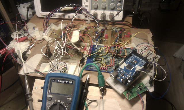

(Let's see if I can manage to upload pictures...)
I haven't recorded any sounds yet, but I have done a couple of "integration" tests, the first in the picture was just 4 oscillators (at the top) and 4 VCAs, I use an Arduino for midi input (lower right), DAC control (the breadboard under the arduino) and multiplexing (the blue board, I use a CD4051 for 8 outputs).
I used this to test out my arduino code, and it actually worked eventually (sawtooth only though).
I have since started using another VCO design, and I'm on the second 'major' version of my vcfs...
I think my biggest setup so far uses less than 400 milliamperes, so far I'm just using a lab supply with dual rails, I run everything on +- 12V partly because it feels safer testing together with my eurorack modules..

For my own project, well it's not moving fast, but I did get some time last couple of weeks to fiddle about with it.
For my new oscillators, I think I've got the hang of the tempco values now, still might need another revision of the board (It might be necessary to add a fine-tune trimmer in addition to the "main" one).
The new filters has taken quite a lot of time too, I've had trouble getting the resonance control right.
Last couple of days I've been working on the arduino control program and added a couple of test-modes to make calibration easier.
I have been sketching (in KiCAD) on a complete "voice card" for a 2-osc synth setup, but it tends to become pretty large (hard to get everything onto a 10 x 16 cm board) and I hesitate also because I know from experience how I tend to discover small but critical changes after I've committed and etched a bunch of boards...
