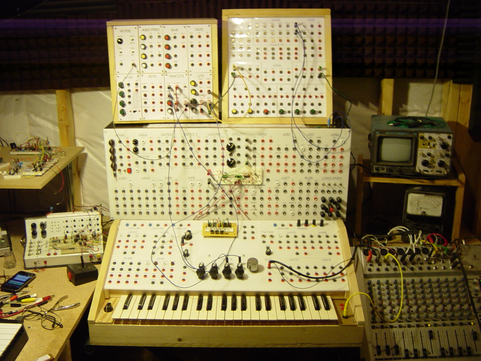

Hi! This is my first Lunetta build. Its very simple, with two 40106 oscillators and a 555 lfo/osc. In this SoundCloud link Lunetta is recorded with Monotribe, tube preamp, fuzz, delay and reverb.
https://soundcloud.com/automatonmusic/lunetta-diy-synth-through

Ive been lurking around here for a while and thought it about time I gave some thing back for all the stuff I have learned here.
So here is one of my pieces of cacophony. It was made using 4 40106 oscillators 2 of which get feed into a XOR gate which feeds a 4040. 8 random out puts of the 4040 feed into a 4051 multiplex inputs. The 4051's A B & C controller are fed by 2 of the 40106 oscillators with the 3 control coming from one of the oscillators feeding the XOR gate. The common in/out providing the output. A single track was recorded and then duplicated with a little bit of delay and reverb.
SO here is my Space Invaders' Boogie

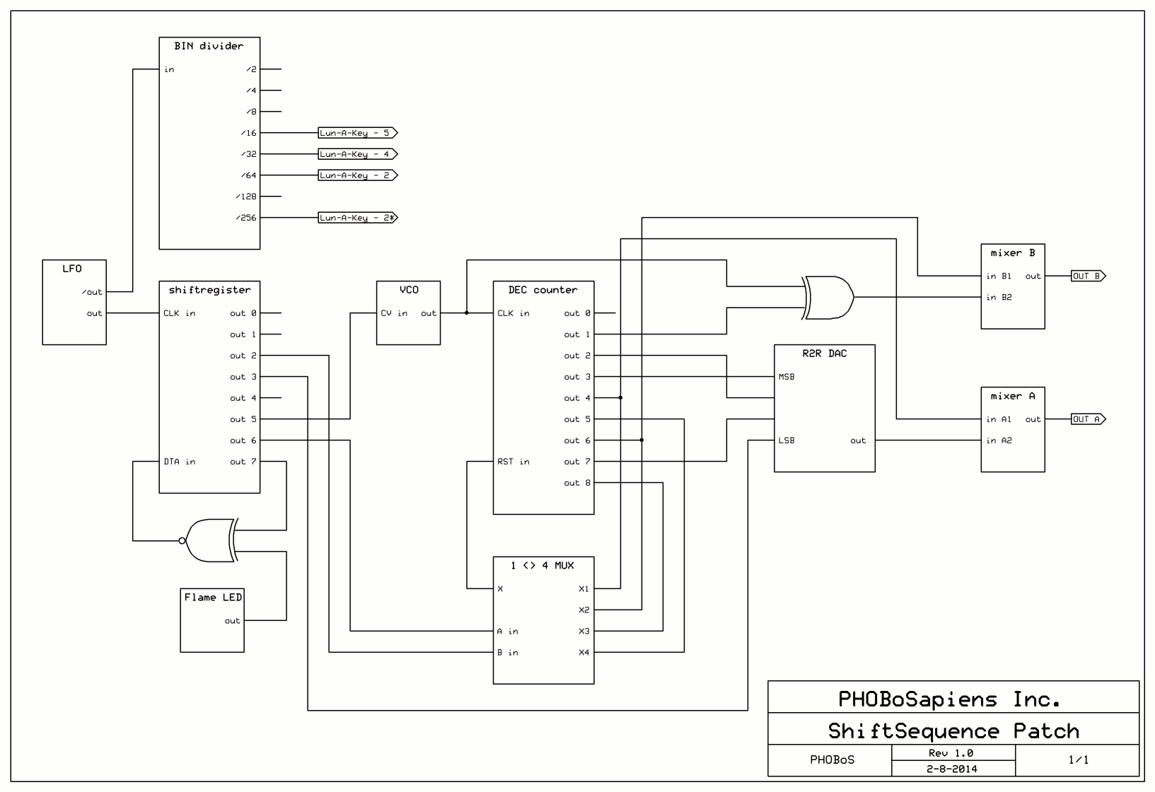

PostPosted: Sat Aug 02, 2014 6:35 am    Post subject: PHOBoS - ShiftSequence (Aug 02, 2014) Reply with quote  Mark this post and the followings unread
I wanted to make some sounds using the output from an R2R instead of a VCO which I mostly do, so I patched something up.
It has a shiftregister with the last bit fed back through an XNOR controlled by a tea candle LED (similar to the turing machine),
which in turn controls a mini melody generator (slacker). Cool
Could be expanded with the tea candle LED turned on/off by the divider (did that manually now). And another R2R to control the VCO
connected to outputs of the divider and or shiftregister. But I ran out of patch cables Rolling Eyes (have to fix some)
ShiftSequence Patch
