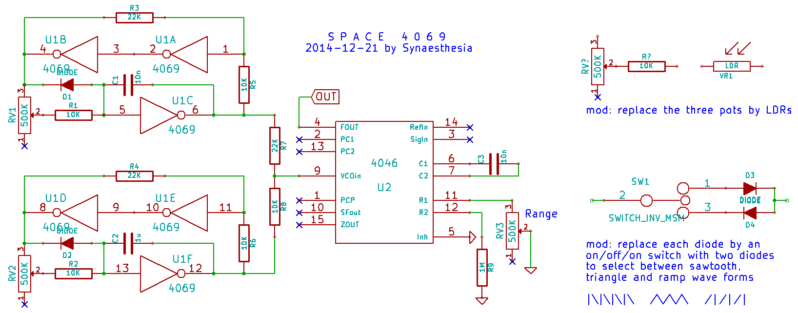

PostPosted: Sun Dec 21, 2014 8:22 am    Post subject: Reply with quote  Mark this post and the followings unread
A simplified version of the SPACE4046 circuit that uses 4069 inverters to create two triangle wave oscillators. The diodes are then used to change them into sawtooth or ramp generators.

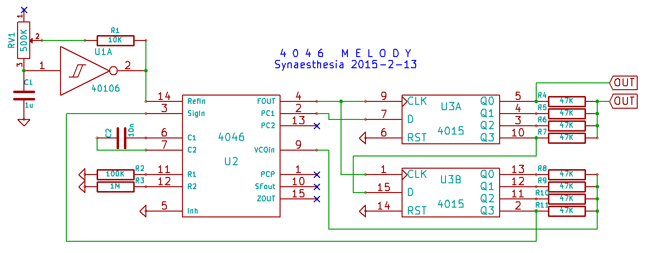

PostPosted: Fri Feb 13, 2015 4:09 pm    Post subject: Reply with quote  Mark this post and the followings unread
Here is a little circuit that generates a random melody using a 4046 and a 4015 shift register. The shift register output is run through the XOR gate from the 4046. Depending on the current state of the slow oscillator (a simple 40106 circuit here, anything else will work as well) the result is fed back into the shift register either inverted or unchanged. The random state of the shift register pattern determines the tone that is sent to the output via an optional resistor network as well as the control voltage that is sent to the 4046. The VCO output frequency is then used to clock the shift register. The self-modulating feedback generates a pretty random sequence of tones as you can hear in the recording.

PostPosted: Sat Feb 14, 2015 6:38 am    Post subject: Reply with quote  Mark this post and the followings unread
Nice! It's random, but not too much, so it still retains some musicality.

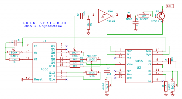

Here is a little snippet that turns a 4046 and a counter into a simple beat-box. I have originally used a 4040 counter in my test, but a 4060 may be used as well and saves an extra oscillator. You might have to experiment with Rt and Ct for the 4046 a bit. The 4060 counter is used for the tempo only, so the frequency is not too critical.
The low frequency counter outputs are mixed via a resistor network for the VCO input. The "melody" is generated by R2, R3, R4 and the 100K pot. The ratio of these resistor values should not change to give the best range of waveforms to drive the 4046 VCO. I have added two extra outputs from the counter plus a pot on top to vary the waveforms even a bit more, this is optional. The rate pot is used to select between two counter outputs for the envelope generator. There is no smooth transition but a sudden change, so it could be replaced by a switch.
The 4046 provides the VCO plus the extra XOR that is used to give the sound a metallic timbre. A glide pot can be used to vary the transitions between the beats (Edit: 22K is sufficient). The range pot at the 4046 controls the VCO range and may be used to shift the generated sounds towards a higher frequency range. Edit: Pin 5 (INH) should go to ground of course.
The 40106 inverter plus transistor is part of a VCA to provide an envelope. The circuit should even work without the extra inverter if you increase C2 to 1 or 2.2 uF. The decay pot modifies the sounds between short percussive beats and longer tones (Edit: better use 47K). The transistor is not critical, any NPN type should work.
During the recording I changed the setting of each pot to demonstrate the full range of sounds. At 1:22 I adjusted the rate pot to increase the tempo.

Cool circuit! Thanks for sharing.

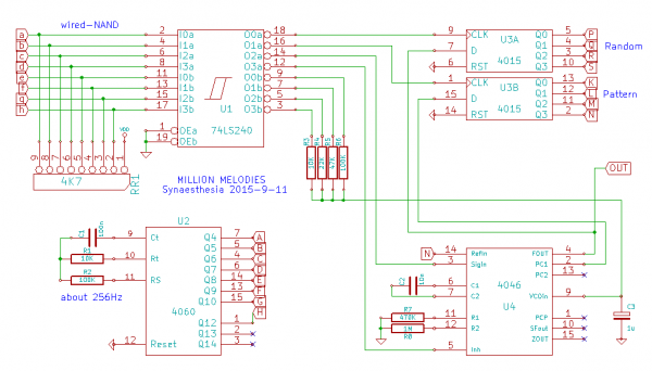

Here is one more fun circuit with the 4046. I wanted to build something loosely based on the pattern generator I am experimenting with. Instead of the simplistic oscillator that I have used there, I am using a 4046 this time because it sounds so much better. The melodies should be generated from a pattern generator core based on shift registers. I have used the XOR from the 4046 together with one 4015 shift register as the basis for that. The other shift register is wired as random bit generator by feeding the output from the VCO into the data input. Finally, a 4060 is used to provide the basic clock frequencies to drive the clock inputs. The resistor network R3-R6 generates the control voltage for the 4046 VCO, which will result in 16 possible tones.
When running the circuit, any output from the counter (A to H) and shift registers (K to N and P to S) may be connected to any of the eight inputs (a to h). Overall, there will be over 400 million possibilities to connect all eight inputs. For that I plan to use a 12 by 16 field of female pin headers. For each input I present only 12 outputs instead of the 16 available, leaving out those that do not makes sense, for example, feeding a shift register output back to the clock input of the same shift register. The connections will be made with LEDs, so that you can see the selected bit stream while the melody is being generated. With a power supply of 5V and 4K7 pull-up resistors the voltage drop at the LEDs is barely big enough to provide a valid LOW signal and thus I added eight Schmitt-Trigger inverters from a 74HC240 to the inputs. This should work better at higher supply voltages.
I still have to solder this circuit to see the effect of the blinking LEDs when patching a melody. However, I have patched it in my Lunetta-Lab and created a short recording with a few samples of the melodies this circuit can generate. There is just the right amount of regular pattern and randomness that I was looking for.

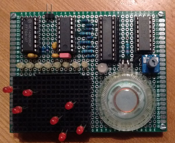

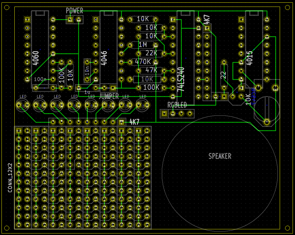

The board is complete and works. Very Happy I have attached the final schematic and layout as well.
The size of the board is only 7x9 centimeters, but still enough space to have a simple amplifier and speaker on it as well. Because the 4046 generates a simple square wave, a single transistor stage was good enough. I am running at 5V and so far I haven't seen any issues with the logic levels limited by using LEDs for patching.

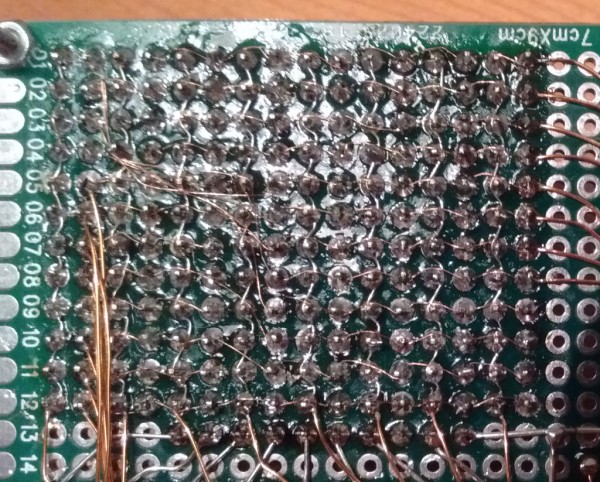

One part of the board was really ugly to solder. The patch matrix for the LEDs seemed to be a good idea, but the soldering was hell. In the detail you can see the vertical column wires for the inputs made from 0.2mm wire and the horizontal signal wires made from 0.1mm enameled wire. I don't think that I will do that again!
One issue I found with the headers that I was using is that the LEDs only fit well in one direction. Of course I noticed that after I started to solder 8 strips of 12x2 holes and had to remove them to replace them by 6 strips of 16x2 holes.

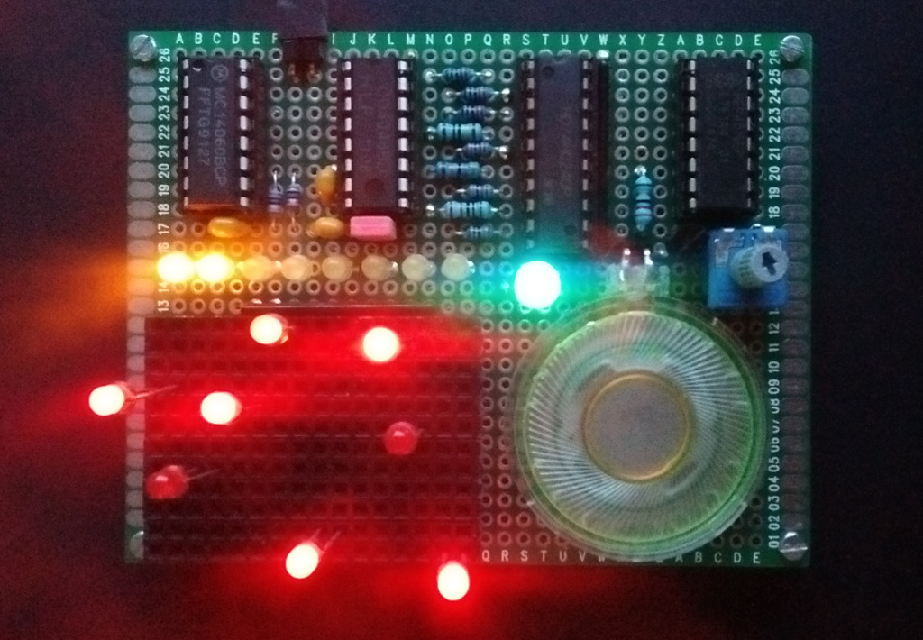

As you can see, I have added a RGB LED as well for extra light-show. Have a look at the movie coming soon!
