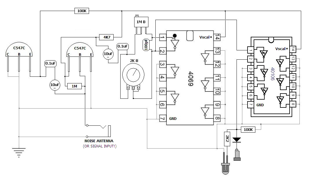

I haven't finished this module on stripboard yet, only on testboard but I've done a schematic for it you can take a look at.
At the top of this topic, in the first post, you can see all the planned modules and the ones I've done has DONE written next to them Smile
Thanks for stopping by!

PostPosted: Thu Jan 29, 2015 11:06 pm    Post subject: Reply with quote  Mark this post and the followings unread
nice thing! i like it.
(... in your shematic you shorted all the outputs of the 4069 and 40106 to Ground ? )
Thank you! Grounding the unused pins is done to prevent noise from floating in/outputs and can also reduce power consumation (so I was told) Wink

PostPosted: Fri Jan 30, 2015 12:10 am    Post subject: Reply with quote  Mark this post and the followings unread
You should ground inputs, but not outputs!
Ah! Makes sense with the schmitt trigger, if the input is pulled down or set to low. But in the case of the 4069/4049 I think I read somewhere that unused op amps should be shorted to be disabled... right? scratch
Nice to have it clarified - specially before I go to work with this circuit! Maybe I should post all my beta schemes to have your feedback.

PostPosted: Fri Jan 30, 2015 6:34 am    Post subject: Reply with quote  Mark this post and the followings unread
Dogenigt wrote:
Unused opamps are often configured as voltage followers and then grounded. But the 4069/4049 aren't opamps,
although the 4069UB can be (ab)used to behave like one. Shorting outputs is something you want to avoid with these chips,
which is also why you can't just connect outputs together. (with the exception of connecting gates parallel for a larger output current)

PostPosted: Fri Jan 30, 2015 10:24 pm    Post subject: Reply with quote  Mark this post and the followings unread
You shouldn't ground an unused op-amp either! Shocked Generally you configure it as a voltage follower, but connect the output *only* to the inverting input. That way the op-amp neither sinks or sources any current. (well, almost none)
Also, PHOBoS is correct that using an inverter as an amplifier is just making it behave sort of like an op-amp. It's not an op-amp at all.
