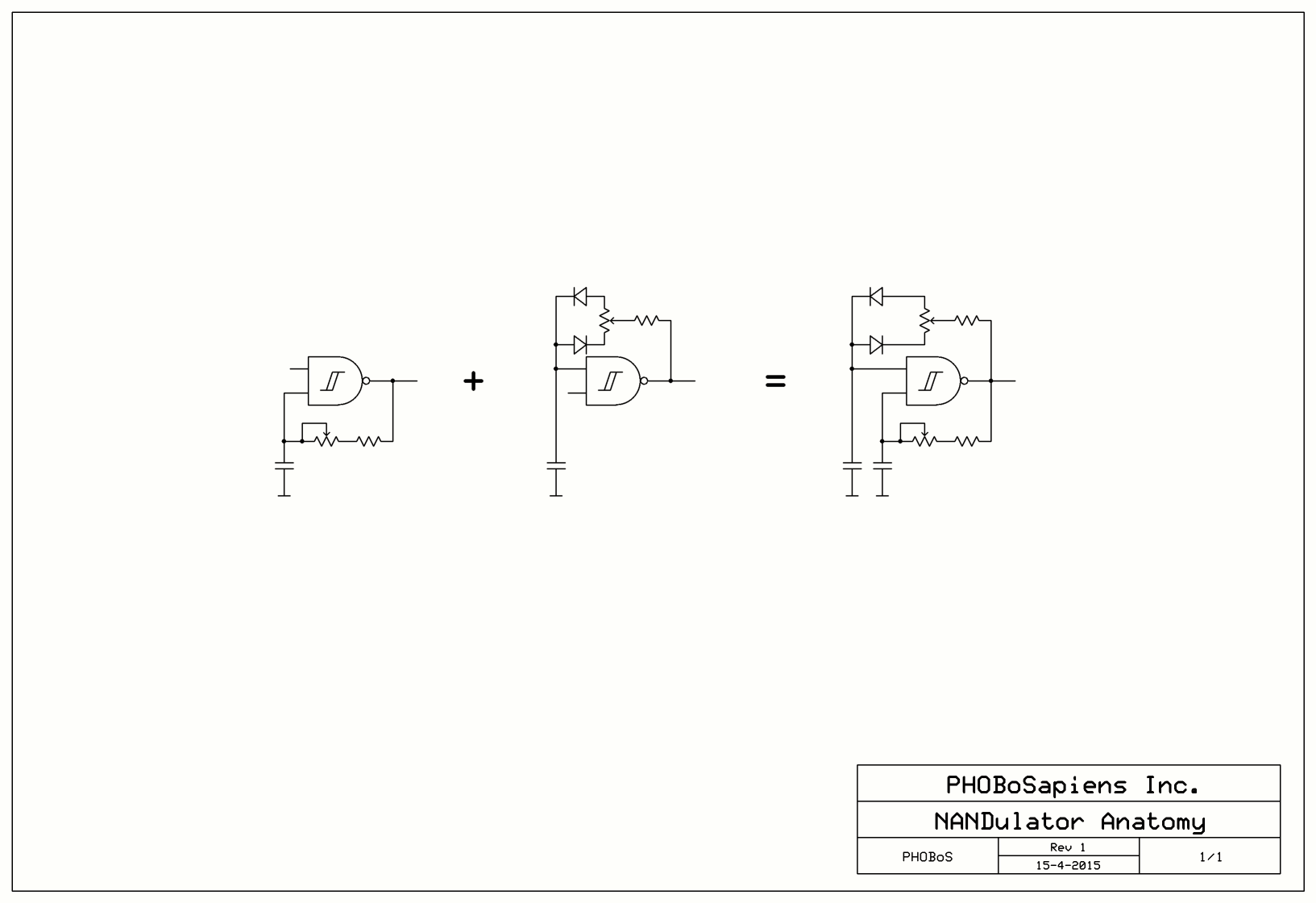

The bits around U1c/U1d are actually 2 things mashed together. They have a standard (schmitt trigger) oscillator with
a variable frequency and the part with the diodes is also an oscillator but with a fixed frequency and a variable pulsewidth.
Both of those only work if the other input pin of the NAND gate is high but since they are attached to same output
and are both oscillators the whole thing becomes somewhat unpredictable. not that it is really chaotic but both
oscillators influence eachother.
NAND U1a just mixes the signals together and the output is only low when both inputs are high.
NAND U1b is a gated oscillator which only oscillates if the input attached to U1a is high.
 Filesize:  26.35 KB
 Viewed:  783 Time(s)

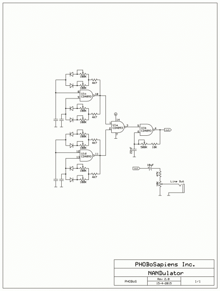

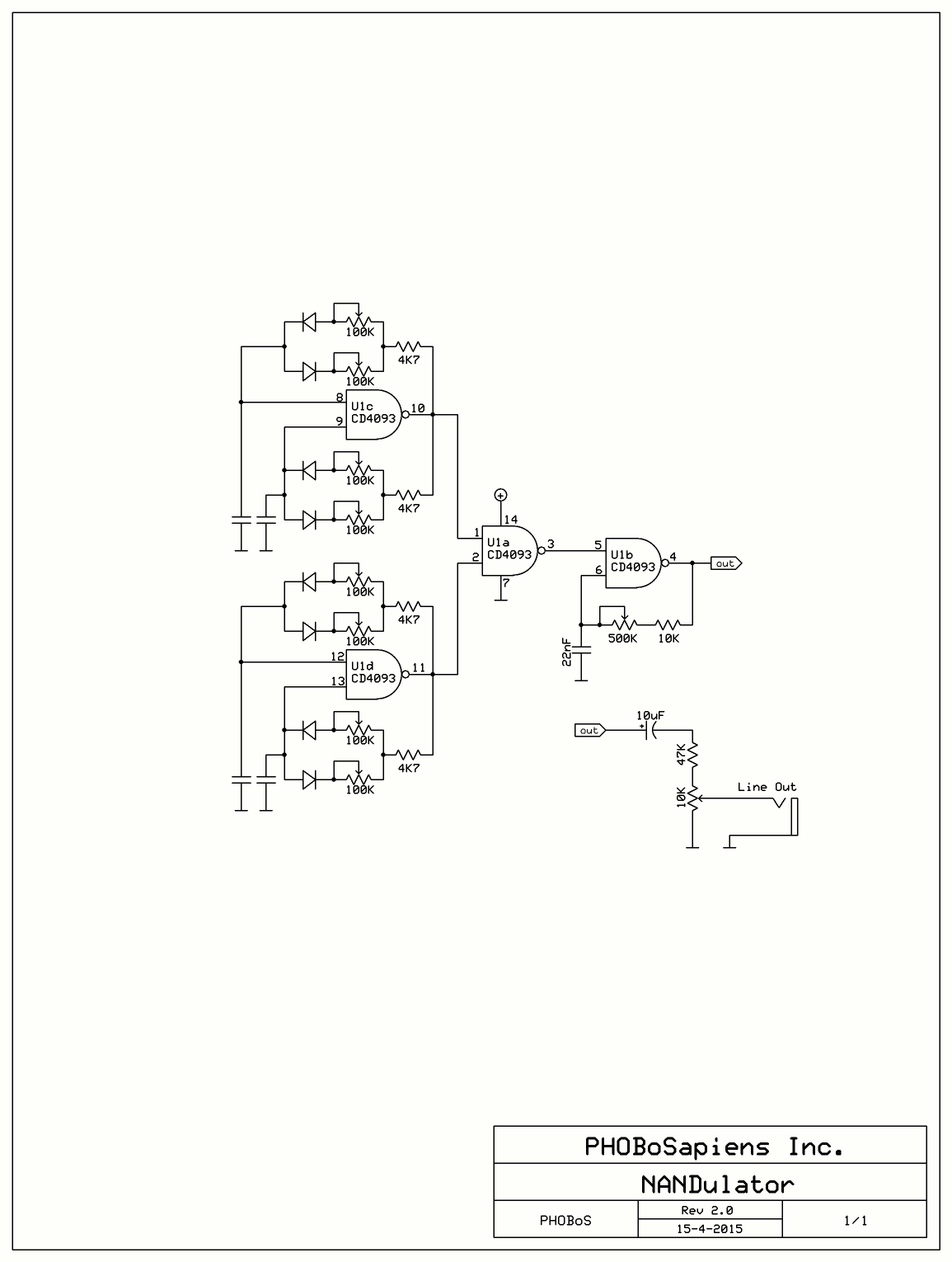

So that got me thinking, instead of combining an oscillator with variable frequency and an oscillator
with variable pulsewidth, combine 2 oscillators that have both variable frequency and pulsewidth.
I haven't tested it so I don't know if it works (it should do something) or what useful capacitor values
are. but here's the schematic for:
The NANDulator V2
now with even more NANDulation!
sorry Robert
NANDulator V2 (untested)
 Filesize:  23.19 KB
 Viewed:  1026 Time(s)

Thank you very much PHOBoS for your clear explanations about how the NANDulator NANDulates. So my guess was not that far off concerning the sub-circuits but i completely missed the proeminence of the chaos factor. What's weird is that the "PW control" mostly dictates frequency while the frequency control affects timbre for the most part. Strange… NANDul, so to say. And the last oscillator sometimes sounds a tad like a filter. i definitely was able at some point to hear harmonics while turning that pot!
Talking 'bout pots, thanks piedwagtail for the input, i'll stay with my backward logs tho!
And yeah, that V.2! Want to hear that!

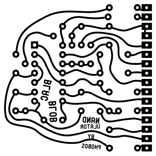

Concerning V.1, i thought improving the layout with: bigger wire pads, putting the pads for the first pot in the correct order, adding an LED, a protection diode (think standalone noisebox). Makes sense? Or not. Stay tüned.
::U::N::S::C::H::N::E::L::L::

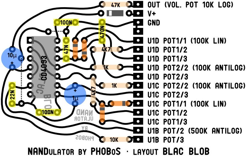

PostPosted: Wed Apr 15, 2015 5:02 pm    Post subject: Reply with quote  Mark this post and the followings unread
Here we go:
(ditched the LED)
Edit 4.20.2015: put the diodes in the right direction according to PHOBoS' schematics.
Now let's etch!
 Filesize:  63.39 KB
 Viewed:  35896 Time(s)
Debugged version with diodes in the korrrrrekt direction.
 Filesize:  88.98 KB
 Viewed:  685 Time(s)

looks good umschmitt! Very Happy
with that layout you could solder a header onto it that you can plug it into a breadboard to do some more experiments.
Robert, a while back I desined a circuit to convert a CV to resistance with a homemade vactrol. I'll see if I can find it
maybe you can get some ideas from that. For a PCB you could add extra solderpads for any NAND output to link them
or maybe hook up some LED's (I should try my 5x5 mini scope with it). A more universal version could be a board that
has an option to choose what you want to make and in what order you connect it. So it would have all the necessary
holes and traces to make 4 of those NANDulator cells (V1 with frequency and PWM control). but you could also make 4
standard oscillators or the original NANDulator and than connect in & outputs as you want (could make it patchable).
Of course this would require a larger PCB. Maybe add an extra space for 4 diodes or resistors connected to the output
to mix signals together.

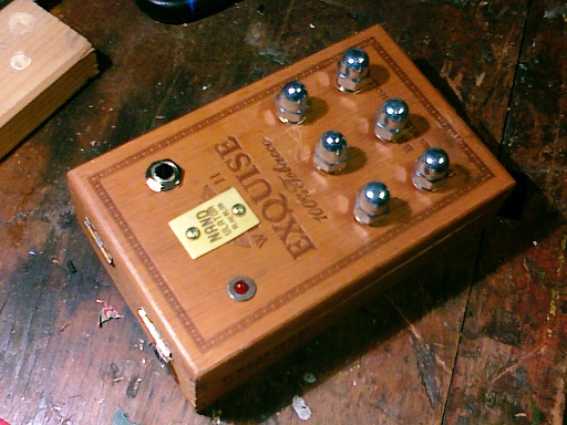

PostPosted: Sun Apr 26, 2015 4:18 am    Post subject: Reply with quote  Mark this post and the followings unread
thumb up Exquisite Edition!
I like the small label.
great the hear the workshop was fun Very Happy
slowly the world will get NANDulated!
