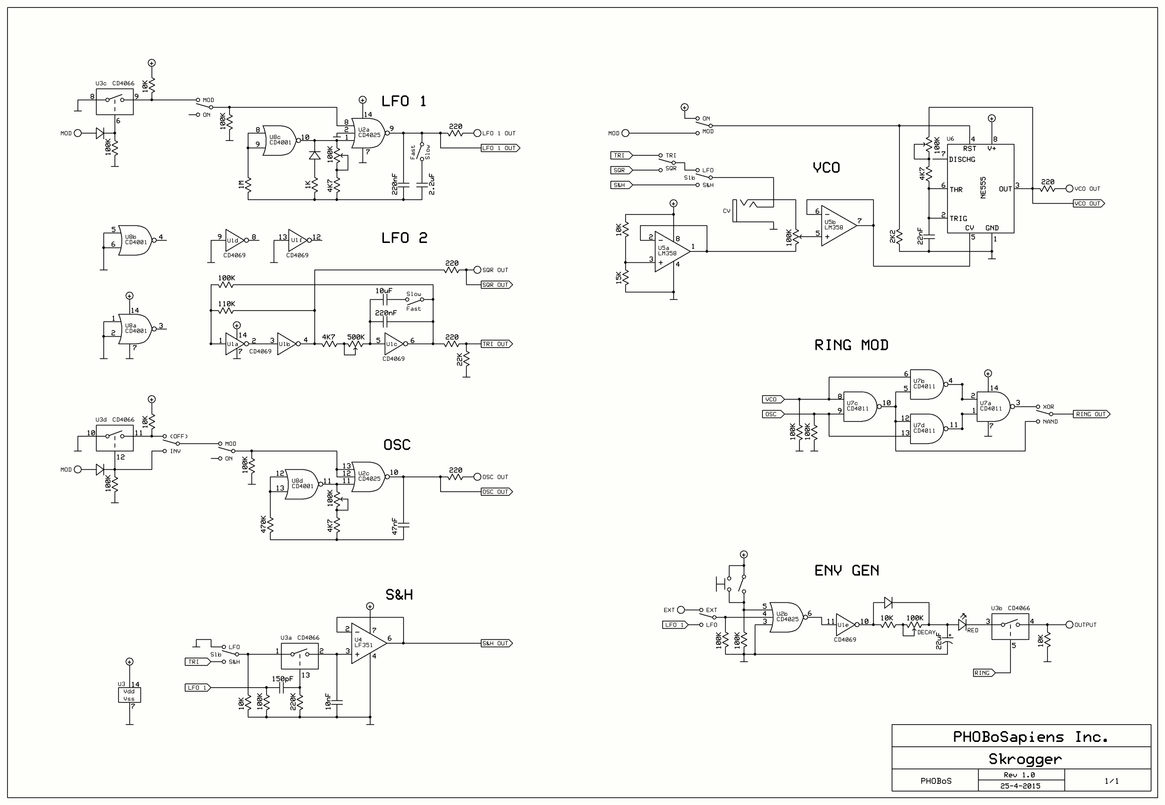

So I'm using them to make a simple (lunetta) synth. I thought about using the 555 for an envelope generator
and the 4069 for a filter but that's not what I did. Instead I'm using the 555 for a VCO and the 4069 (together
with some gates of the 4025) for some (LF-)oscillators. The 4066 + LF351 immmedialy seemed useful for a S&H
but I wasn't sure what to do with the other 3 switches. Eventually I used one for a VCA, which works pretty
much the same as the diode version, and the other 2 as inverters. The 4011 NAND gates are combined
for an XOR-ringmod.
I will post the schematic after it's all hooked up and tested but here's a photo of the frontpanel.

I wired it up about 2 weeks ago,. but I have problem. Apparently making an oscillator out of a 4069 inverter
followed by a 4025 NOR doesn't work Sad. However when I touch the input of the inverter it does. I experimented
a bit on a breadboard to see if I could get it working but whatever worked on the breadboard didn't work when used
in the actual circuit. So I'm a bit stuck, easiest way is probably to just add another NOR chip and replace the 4069 inverters.
(and I need a 3.5 mm socket with a switch contact and some wood for a case)

... easiest way is probably to just add another NOR chip and replace the 4069 inverters.
So that's what I did. It feels a bit like cheating since dave didn't send me that one, but I already added an extra opamp too anyway.
(and I fried the original 555, but don't tell Dave)
I used some stained wood for the case this time instead of the usual MDF. And I wanted to record a demo but when I started playing
around with it yesterday I also added some other stuff (as usual). You can find some excerpts of that Skrogging session posted here. Razz
And you can also here it at the beginning (and throughout) Phytoplankton.
Skrogger schematic
