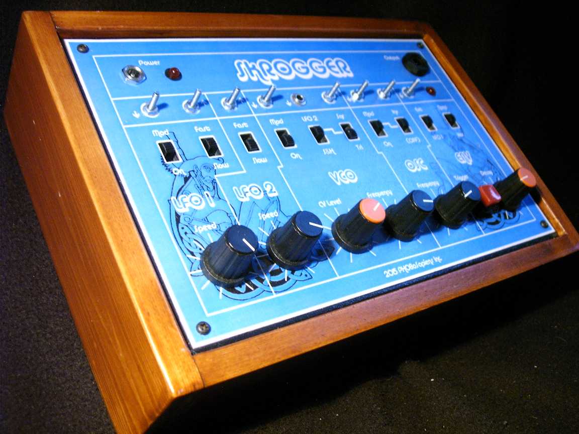

Dave (Skrog Productions) was so kind to send me a couple of chips and some switches. (And nice CDs too)
banana
chiplist:
CD4011 (quad NAND)
CD4025 (triple 3-input NOR)
CD4066 (quad Analog switch)
CD4069 (hex Inverters, unbuffered)
NE555 (you all know what it is)
LF351 (JFET opamp)
and some memory chips
So I'm using them to make a simple (lunetta) synth. I thought about using the 555 for an envelope generator
and the 4069 for a filter but that's not what I did. Instead I'm using the 555 for a VCO and the 4069 (together
with some gates of the 4025) for some (LF-)oscillators. The 4066 + LF351 immmedialy seemed useful for a S&H
but I wasn't sure what to do with the other 3 switches. Eventually I used one for a VCA, which works pretty
much the same as the diode version, and the other 2 as inverters. The 4011 NAND gates are combined
for an XOR-ringmod.
I will post the schematic after it's all hooked up and tested but here's a photo of the frontpanel.

PostPosted: Tue May 12, 2015 7:01 pm    Post subject: Reply with quote  Mark this post and the followings unread
Nice Skrog inspired blue Smile

Posts: 5882
PostPosted: Wed May 13, 2015 2:10 am    Post subject: Reply with quote  Mark this post and the followings unread
I used the exact same shade of blue as the Super Sequencer panel layout he posted here.
Of course it's not done with the same printer so it might be slightly of but it's the idea that counts.

PostPosted: Wed May 13, 2015 10:58 am    Post subject: Reply with quote  Mark this post and the followings unread
WoW , Amazing Smile Smile , fantastic panel , I like the 2 celtic pipers Very Happy and what a lovely shade of blue, good choice Very Happy Very Happy .
Looking forward to hearing it when it's all wired up .
Excellent work & great use for the chips & slide switches too, Phobos .
salut
This is inspiring me to build another module Very Happy Very Happy

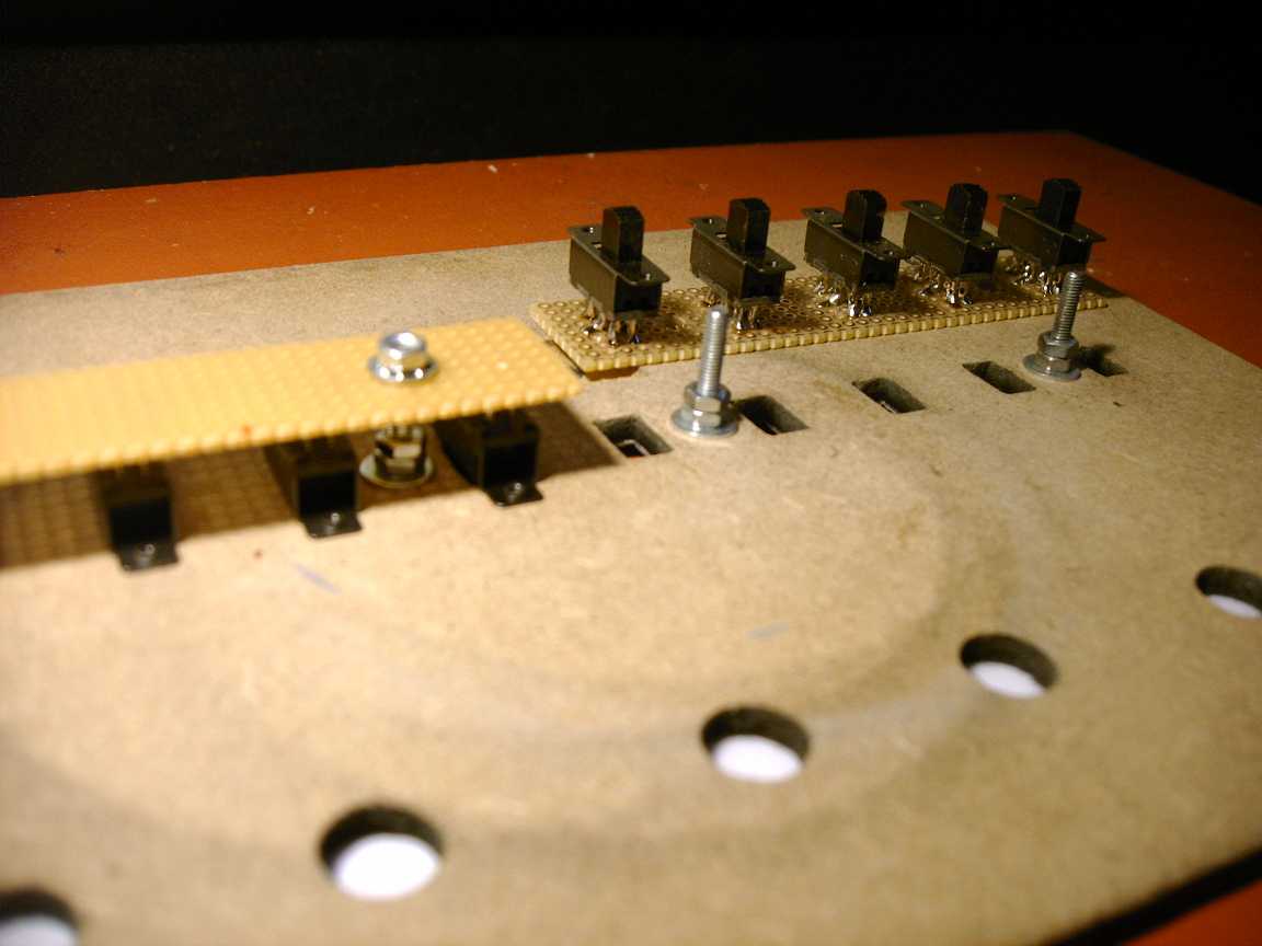

Posts: 5882
PostPosted: Wed May 13, 2015 12:17 pm    Post subject: Reply with quote  Mark this post and the followings unread
Thanks dave smurf
glad you like the pipers, I HAD to put something scottish on there of course. (and haggis just didn't look right).
Here's a photo of how the slide switches are mounted.

Posts: 1223
Audio files: 159
PostPosted: Wed May 13, 2015 12:28 pm    Post subject: Reply with quote  Mark this post and the followings unread
That's a great way to mount the switches , saves having to source 2mm thread screws for the switch tabs, good stuff Phobos.

PostPosted: Mon Jul 20, 2015 12:09 pm    Post subject: Reply with quote  Mark this post and the followings unread
Looks & Sounds Fantastic Smile
compress cool salut
I see the red square push for env , just like I use for my adsrs , cool Smile
Does the Skrogger have it's own power supply or is it run from your Raw DC supply ?
The wood case completes the build Smile Excellent construction Phobos , would it be ok to upload you some yellow drum synth patterns I will programme up , for you to multi track / jam some skrogger sounds along with ? .
Smile Dave Smile
Posts: 5882
PostPosted: Tue Jul 21, 2015 11:57 am    Post subject: Reply with quote  Mark this post and the followings unread
Thanks Dave Very Happy,
Since it's just a simple lunetta synth it works on a DC wallwart and yes I had one of those push buttons I see you using al the time
so I had to put it in the skrogger. It's actually an on/off switch not a momentary but I noticed you can use it as such. So I can
use it as a trigger or just turn it on which basically disables the envelope generator.
Sure go ahead, upload some skrogbeats I jam to it. I can't promise I can stick to just using the skrogger though Wink
