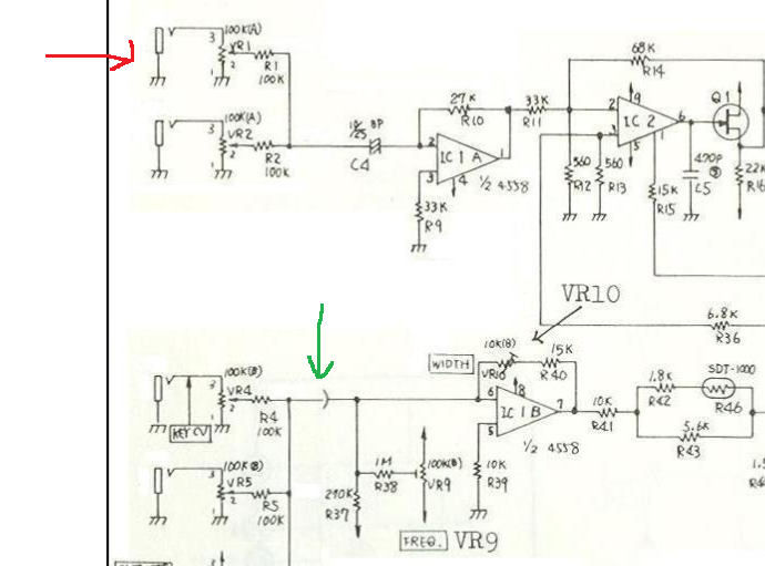

Would it be possible to use an LM13700 for the Transc. op-amps and some kind of transistor pair for the Exponential function converter? I am trying to breadboard this filter but I am stuck on the converter.
Does any one know a simple Anti log function generator circuit?
I found this(see pic) but I am not sure if this one is the correct one to use here. I think the one in the picture is a Lin/log converter. I think I need a log/lin converter. I am not sure how to do that.

Hey not sure if you're on the SDIY facebook group. But I have done it and yes, it is totally possible.
I have some real IR3109s and with advice from guys on the SDIY mailing list I figured out the internal resistor values between the gain cells non-inverting inputs and ground as 432 ohms.
I used one LM13700 to make a 12db version of this filter
For the expo converter I used the standard Thomas Henry current source type. The thing I haven't figured out is the buffers between the gain cells. I used a TL072 in my circuit but next im going to try a FET as it's what Roland preffered to use.

Hi SH-101 lovers,
Is the expo converter from Roland Service Notes working? it's for +15v, that's right?
in this PDF :
http://www.synfo.nl/servicemanuals/Roland/JP-4_SERVICE_NOTES.pdf
and the image above sh-101_vcf_schematic.jpg has diff voltage +5v
I'm not aware of the calculation here, but has anyone a schematic for -/+12v or an explication note?
I want to know how this thing is acting like the IR3109, I must try to breadboard from discreet and LM31700...

PostPosted: Tue Oct 20, 2015 12:48 pm    Post subject: Reply with quote  Mark this post and the followings unread
just finished that above mentioned 121 VCF and hmmm... i'm not so glad with my result... i have used 2xLM13700 and 4x 2SK30 instead of the original parts...
the filter does self oscillate but only in the very low spectrum and the Output is rather a square than a sine... even with no Input at Audio in...
tried playing aroud with the resistors in the Feedback path of resonance...
reducing that 6,8k resistor even lowered the frequency so i thougth ok let's increase it... so i soldered a 4,7k with a 10k trimmer in series and well it's slightly higher and the resonance Output is lower in Amplitude but i only get more of a humming frequency and when i only had 68k in self oscillation disappeared...
any idea how it's original behaviour is?
does it cover a wider range of frequencies in self oscillation?
any Information or Input would be welcome as usual... thank you

something must be wrong with your build. i am getting a very nice sine wave across the whole spectrum:
roglok
Joined: Aug 28, 2010
Posts: 202
Location: uptown
PostPosted: Sun Nov 01, 2015 4:24 am    Post subject: Reply with quote  Mark this post and the followings unread
did you pay attention to the FET pinouts?

PostPosted: Sun Nov 01, 2015 10:31 am    Post subject: Reply with quote  Mark this post and the followings unread
Hi Roglok,
thanks for your reply.
Have soldered the FET according to the SK30 data sheet i found at my suppliers pages.
These are as per front view (where you can read the identifier) from left to right source, gate and drain...
and when i read the original schematic correct, then there is the gate connected to the Output of the OTA the source to +15V and the drain goes to the next stage and -15V via resistor. correct?
Wasn't there something about 2N3819 Fet's where sometimes the Pins where swapped?

PostPosted: Tue Nov 03, 2015 10:31 am    Post subject: Reply with quote  Mark this post and the followings unread
Problem fixed...
Forgot to cut two rails on my stripboard design so that the gates and drains of the FET's between stage 2 and 3 where tied together... luckily nothing blew up and i have now a sine over the whole spectrum with full resonance and the filter sounds like a filter know and not only like an VCA turning tone on and off...
will now tweak and tune it a bit until i'm satisfied...
should consult my doctor and check my eyes as i have checked the layout a few times but always missed that failure... Smile

PostPosted: Wed Aug 02, 2017 4:45 pm    Post subject: Reply with quote  Mark this post and the followings unread
excellent thread !
thanks to Roglok for providing the link to the wonderful Roland SH 101 filter revision by Frequency Central.
My question is, may i subb in any general op-amp in place of the specified lf 351 ? And can i use the lm 13700 in place of the 3080 safely?
i attached a part of the schematics. May i assume that the red arrow is pointing to the audio input?
and what's the symbol the green arrow is pointing to?
Someone tried to stripboard the filter but i havent heard about the results.
Any help?
thanks!
(note added by Blue Hell - also see http://electro-music.com/forum/post-429545.html#429545) - please correct me when I was wrong.
 Filesize:  246.57 KB
 Viewed:  350 Time(s)
