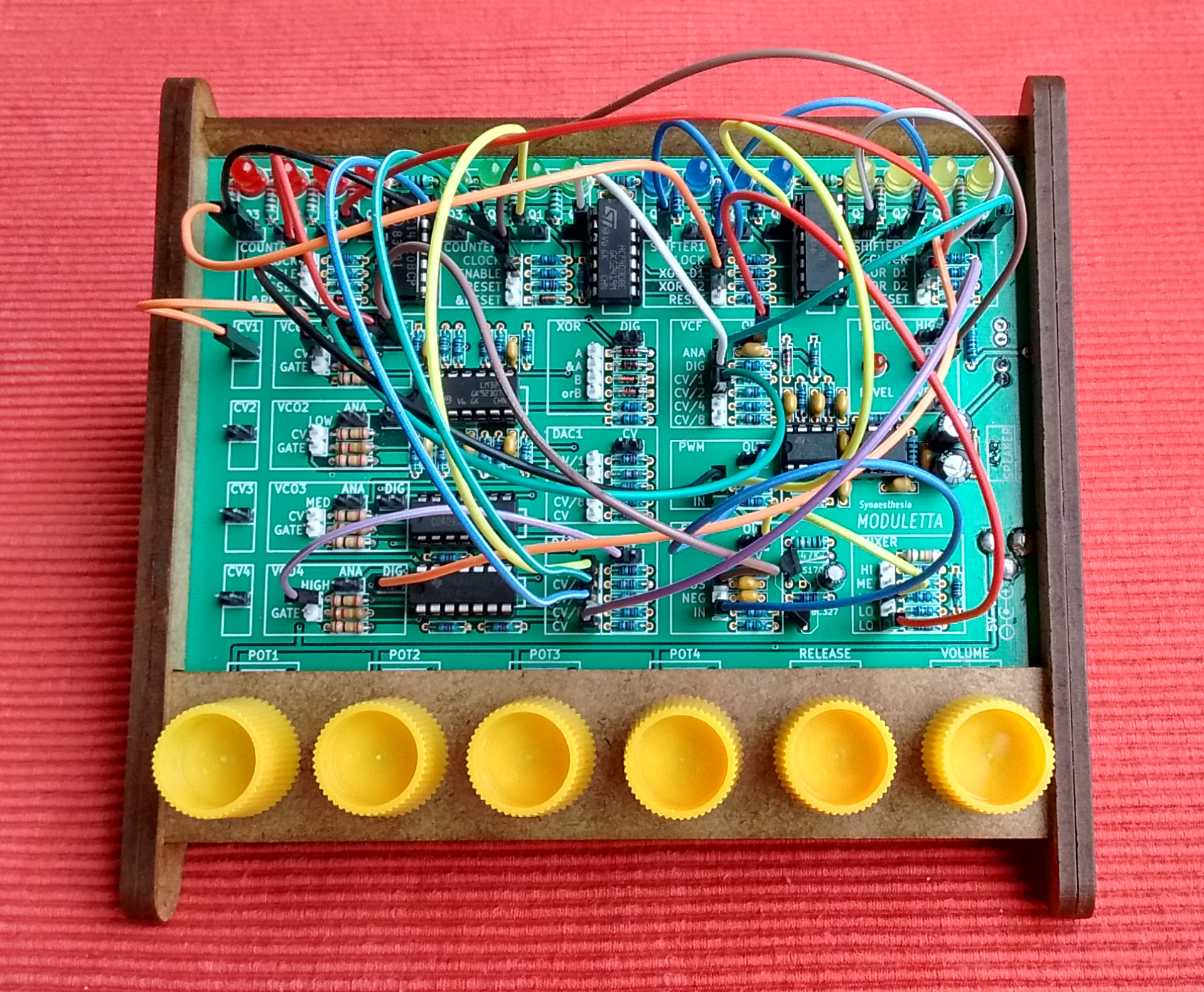

This is the project I am currently working on. I haven't finished the big new Lunetta Lab yet, but decided to build a smaller one first using the triangle VCO and a few other ideas I had recently. It already works fine on breadboard and I wanted to have manufactured PCBs this time. This was a first for me, and of course there were a few small errors. But overall it came out great and I am very happy with the result.
I call this a Moduletta because it is a cross-over between a Lunetta and simple modular synth circuits. The idea was to have a mixture of analog and digital modules that can be patched together via Dupont cables. All analog modules accept control voltages and almost everything can be connected to everything else. The Moduletta is meant to run from a unipolar power supply of 5V to 9V. The chips could stand more, but my current VCO design doesn't work well above 9V.
There will be four pots for control voltages and four VCOs on the board. Two additional pots are hardwired to control the release and the volume. The digital modules include two simple DACs, an XOR/AND/OR gate, two counters, and two shift registers. The analog modules include a PWM, a VCF, a simple envelope generator, and a mixer with amplifier for a builtin speaker. A line output can be used to connect other devices or headphones.
I will post more info as this project continues. The next step is to design a nice case for the Moduletta.

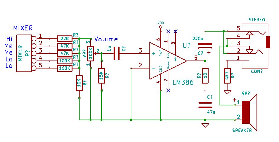

The mixer is a simple resistor network with an LM386 amplifier. The additional 15K resistor makes the response of the linear potentiometer more logarithmic.
This trick is described at http://sound.westhost.com/project01.htm
The line out jack is meant to be used for other devices or headphones, so an additional 4K7 series resistor is added to limit the output volume and save your ears.

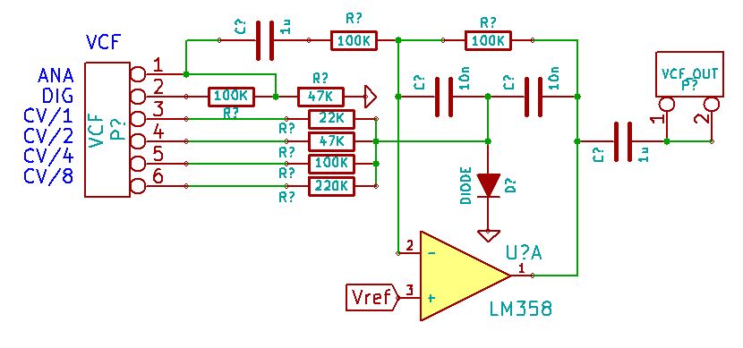

The VCF is a very simple but effective low pass filter design with a bit of resonance, but no self-resonance. The diode current from a control voltage through a resistor network determines the filter response.
This way it is easy to adapt the desired range of the filter response to the available control voltage. Of course another pot could be used here as well. The control voltage used here is typically in a range of 0-3.5 Volts.
There are two signal inputs, one for analog signals (e.g. from the VCOs) and one for stronger digital signals that are scaled down before being fed into the filter.
Mind that this is a unipolar design. Vref is 1.8V here and taken from a red LED. How convenient, this is exactly half of the usable output range for an LM358 at 5 Volts.

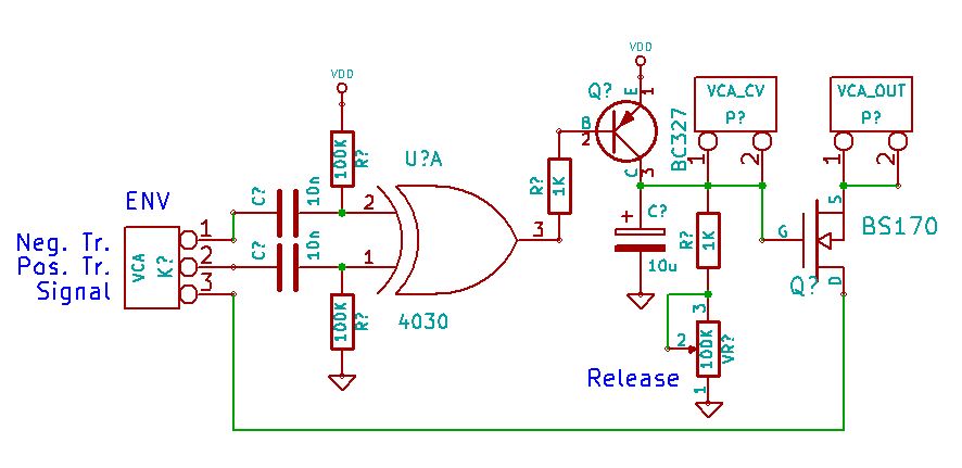

And finally, the envelope generator. I omitted the controls for attack, decay and sustain, and only added a potentiometer for the release time. With the values here you can have a range from short drum-like sounds up to a 2 seconds release time. The envelope curve is taken from the voltage at the 10uF capacitor during discharge.
Two inputs for negative or positive trigger signals are available. They are simply connected via small caps plus pull-up/pull-down resistors, and the internal protection diodes of the CMOS gate handle the rest. The BC327 transistor buffers the output from the CMOS gate and handles the quick charge cycle for the cap.
I have experimented a lot with this circuit and the solution that works best for me is to use the voltage at the cap to control the gate of the FET. The signal is sent straight into the drain of the FET. This works because all other inputs in my circuit are referenced to ground.
