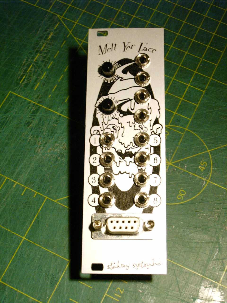

All my other synths use 1/4" jacks so I need something to convert those to 1/8". My initial idea was a panel
with both 1/4" and 1/8" sockets but you can't get a lot of 1/4" on a panel. So instead I made a panel
with 8x 1/8" sockets connected to a 9P sub-D connector. This will plug into a breakout box with 1/4" sockets
which, as an added bonus, I can put next to my synths. when nothing is plugged in on the other side it
also acts as a multiple. It can also be used as a multiple when something is plugged in but than I have to
leave a minimum of 2 sockets unused. Since there was some panel space left I also added 2 attenuators.

Posts: 5947
PostPosted: Fri Feb 19, 2016 2:17 pm    Post subject: toner transfer front panels Reply with quote  Mark this post and the followings unread
I had seen some people having nice results with the toner transfer method to make front panels so I gave that a try myself.
I first tried it with some regular paper but that didn't work very well. So next I tried some pages from a couple of different
magazines. I got much better results but the toner didn't take 100% and I also got some of the print of the magazines itself
on it. But what was transferred looked good and was pretty scratch proof.
So I ordered some photopaper to see if that would work any better. What I only relalized after I got it was that it was
made for inktjet printers. It didn't say that it wasn't suitable for laserprinters though so gave it a try anyway.
Well,.. when it came out of my printer it sounded like unwrapping some candy Shocked The print had cracks in it and the
paper had become all bubbly. So that did NOT work. I looked for a bit more info and actually came across some warnings
against using glossy inktjet paper in a laser printer. Apparently the glossy coating can melt and stick to the fuser,
ruining the printer. Luckely that didn't seem to have happened. However there are people who are getting great results
with it even using the exact paper I tried. So you could try it but be warned!
I read up some more about toner transfer method and somewhere someone mentioned getting great results using cheap transfer
paper from china available on ebay. So I ordered some of that (pretty cheap indeed and no shipping costs!). That was all
about a month ago and I had almost given up on receiving the paper when it arrived yesterday Laughing
So I could get back to testing. It came out of my printer looking great, but while cutting it to size I did notice that the
toner didn't stick very well to it. Of course that's exactly what you need to make good transfers but you also have to be
very careful when handeling it. The first tranfer I made looked horrible and much worse than the ones I had made using the
magazine paper. Confused So I gave it another try. Sofar I had been emerging the (very HOT!) aluminium in water after the transfer
to rub of the paper. But the scrap piece I was testing on didn't really fit in my sink so only a small part got emerged this
time. Now, when I pulled of the paper (you don't have to rub this transfer paper of) the part that was emerged looked bad
again but the part that wasn't looked great Very Happy So on the next try I just let it cool of by itself and that seem to do the trick.
I made 4 panels sofar. the 'Melt Yer face', EZChaos for which I got the PCBs from AlanP and two WaveWipers. I had some trouble
getting the large black area of the WaveWiper panels to tranfer 100% but after a couple of tries it worked. Here are some photos.

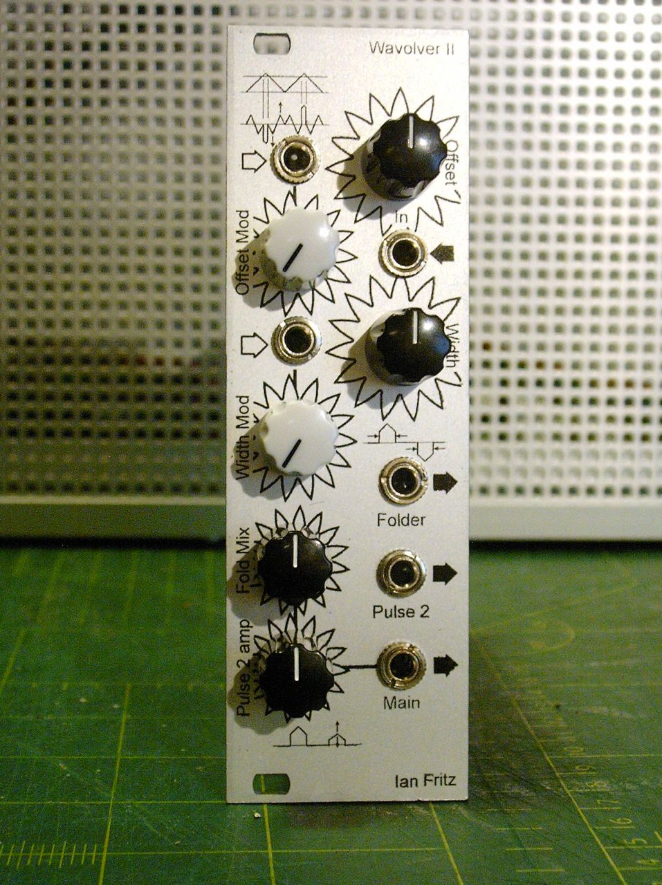

And the last one for now: The Wavolver II (with an extra Pulse 2 output).
 Filesize:  248 KB
 Viewed:  607 Time(s)
 Filesize:  245.09 KB
 Viewed:  652 Time(s)

Nice work -as usual! Smile. Your graphics are coming out really well...I've had no success so far. Pretty much decided to pursue engraving.
www.davesneed.com
