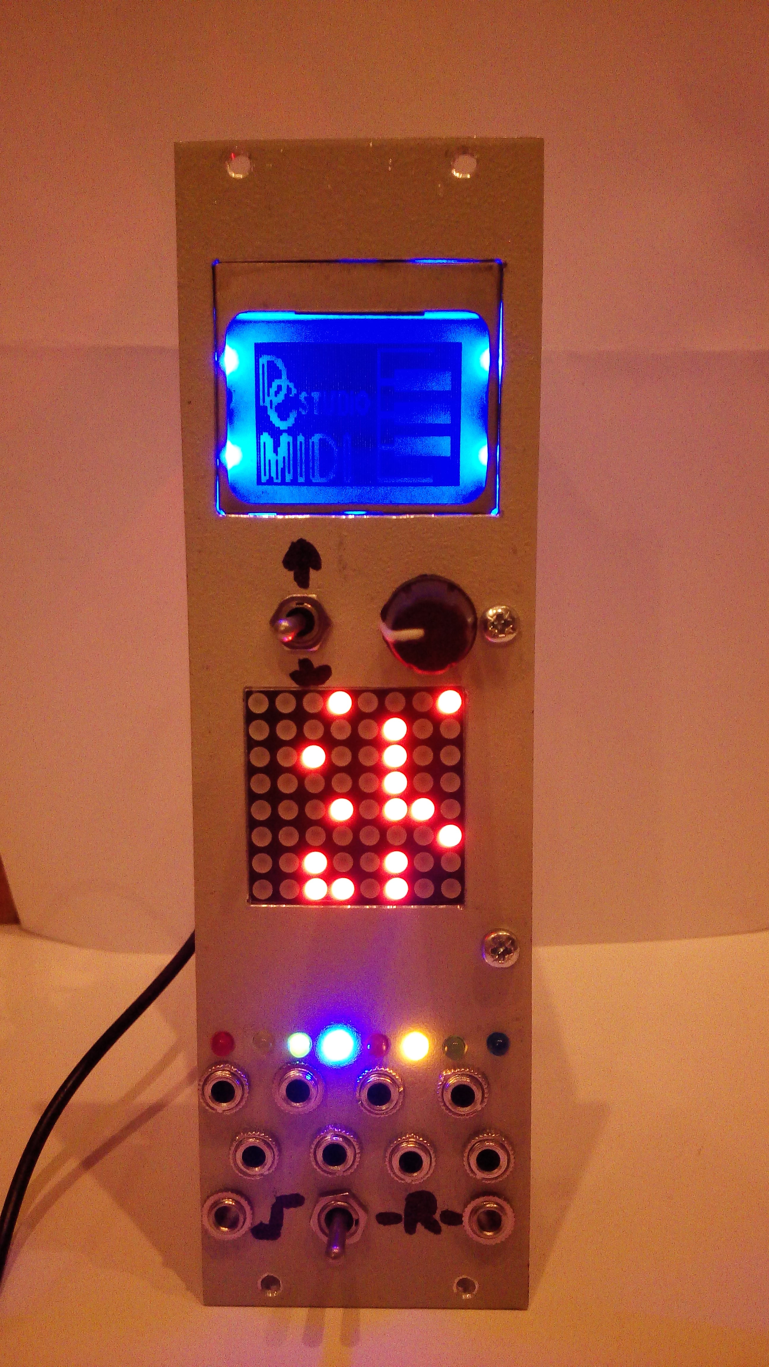

Here a preliminary result of my new project, a drum sequencer.
The plan is to have it pre built rhythms but it must also be programmable on the fly.
I'm just exited...
The white leds show the triggers and in the matrix you will see the running sequence.

Posts: 1319
PostPosted: Sat May 21, 2016 2:32 pm    Post subject: Reply with quote  Mark this post and the followings unread
I'm a bit further in programming this module.
At this moment I have a clock division, 8 channels individual settable going from 0 (no triggers) to 255 (once every 512 input pulses at the trigger input).
Max output frequency is 2.5 kHz (5kHz input freq.)
Choose between internal or external clock (ext clock also triggers when internal clock is chosen). Additional to this I have a switch, when toggled to left it acts as a trigger button to advance one step and toggle to the other side it acts as a reset button which makes the rhythm counter reset to 0.
When internal clock is chosen, tempo can be set from 50 mSec (1200BPM) to 9990 mSec (6 something BPM) in 10 mSec steps.
Rhythm creation, max 255 step, 8 channel, on the fly. I must admit, it's kinda hard to create a nice rhythm Rolling Eyes
To test this I have made a drum synth, very much like the one described a few posts up.
DRUM <<klik (sorry for the background noise...)
