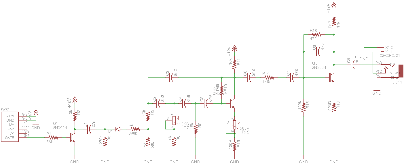

Not sure what is going on with this circuit. It's on a breadboard supplied 12V (not 15 like the original). I built the TTL to trigger circuit so the "C" input pictured is normally at 12V with 2ms pulses down to 0V. The left side of C502 sees about a -10V bump. But the right side of C502 remains silent. I am using a cheapo 3u3H film inductor but have tried numerous different types. What should I try next?

Close to L1 it says 3R, is that the DC impedance? If so, the value of L1 can never be 3.3 uH because they all have DC impedance lower than 0.02 ohm.

PostPosted: Thu Jun 02, 2016 4:42 am    Post subject: Reply with quote  Mark this post and the followings unread
Could that be it? Reading about inductors, it seems that R indicates the decimal point in a microHenry label. If that were the resistance, what would be the inductance? I'll go back and read the service manual.
Posts: 1320
PostPosted: Thu Jun 02, 2016 5:28 am    Post subject: Reply with quote  Mark this post and the followings unread
maybe check THIS out?

Here is a confusing bit from the service manual.
 Filesize:  76.97 KB
 Viewed:  753 Time(s)
Posts: 1320
PostPosted: Thu Jun 02, 2016 6:28 am    Post subject: Reply with quote  Mark this post and the followings unread
My guess is that if the R was a substitute for a decimal point, the value would be 3.7mH (milli Henry).

PostPosted: Sun Jun 05, 2016 6:33 pm    Post subject: Reply with quote  Mark this post and the followings unread
I haven't solved the inductor value question for 1R and 3R700mH yet, but I get the idea that these are rare old parts that might be found in old organs. They might be 1 Henry and 3.7 Henry...
Here is what I'm thinking for the MIDI interface:

regarding the inductor values... i opened my CR78 and had a look on the voice board...
there are 7 greater inductors visible...
4 of them with coloured dots yellow green red... all the same colours...
2 having 3R EB printed onto them (one of them beeing in the claves section and the same value i guess as in the rimshot section, judging by it's descripiton in the Service Manual and what's printed on those coils) those coils in the rhythm77 are 700mH by the way...
and 1 having 1R EC (or EG) printed on it...
just thought what about to compare it with the Rhythm 77 Manual, but it seems they have different values used and some minor differences in their schematics even with the same voices...
But in the Rhythm 77 service manuals a bit more information is given on the values of the coils ....
www.burnkit2600.com/manuals/ROLAND_TR-77-SRV.pdf
i would also like to remind you, if this your only voice you "cloned" and it wouldn't start in the rhythm77 i have the triggers are -12V spikes... don't know what the cr78 acutally uses...

PostPosted: Mon Jun 06, 2016 12:32 pm    Post subject: Reply with quote  Mark this post and the followings unread
@wackelpeter Thanks very much for the info and manual! 3R must also be 700mH and maybe 1R is 40mH. Do you have any idea why they call the 45mH out as a "Choke Coil"?
My triggers should be okay because I copied the TTL->trigger circuit and my high bongo works great. You can see the trigger converter (input) and the output amp from stereoping in this schemo:

Is the LC circuit at the TB output a resonant filter? Looking at a known sample on a spectrograph, I see a peak near 4700hz. Since C538 is 33nF, that would imply that L5 is around 35mH. But I have tried a variety of inductors including 27mH and 47mH and I get no output. Maybe something is wrong with my schematic or build Sad
 Filesize:  21.04 KB
 Viewed:  572 Time(s)
Posts: 1320
PostPosted: Mon Jun 13, 2016 11:41 pm    Post subject: Reply with quote  Mark this post and the followings unread
I use this website a lot when working on analog circuits.
The LC circuit is a resonant filter (4.38 kHz @ 33nF//40mH), make sure you have quality components to get the best selectivity (quality factor) of the filter.
This means: for the capacitor the lowest possible parallel resistance and for the coil the minimum series resistor.
Check if you have a pulse between R14 and R16 (maybe change the position of the runner of R15.

The voltage across R14 is about 0.1 volt max, and is later devided by R570 and R548 to about 3/4 of the 0.1 volt.
Thats not nearly enough to change anything to the voltage at the base of Q510.
I think you should loose R14.
