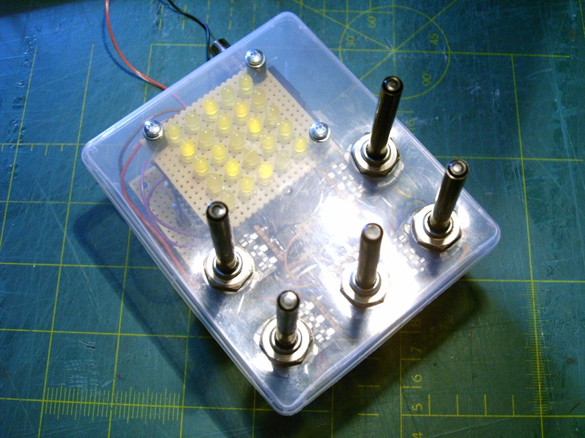

PostPosted: Thu Jul 14, 2016 10:30 am    Post subject: Reply with quote  Mark this post and the followings unread
hey Ryk! good to see you back banana
Looking forward to hearing and seeing (in the form of those entertaining videos) your progress on the next deathlehem machine.
yeah the NANDulator has some nice sonic capabilities for such a simple single chip circuit, I was quite surprised by it myself Shocked
I just put it in a new box over the weekend so the easter edition is no more. But I did get some nice use out of it when I played
my set during the June Solstice event. However one pot got pushed through the cardboard so I had to rehouse it. One thing I had
been curious about was if it be useful in combination with my mini 5x5 LED scope. So I did a test and they work quite well together
so I put them both in a (rather flimsy) plastic box. I don't have any DC connectors left so at the moment it just has 2 wires sticking
out from the bottom. Also the boards are just ' floating' in there so there is a potential for shorts.
But the new box with both the NANDulator and the mini scope in combination with a pm I got from Robert got me started on the
development of some PCBs. It will have both the NANDulator and a mini 8x8 LED scope and I am planning on making those available
as full kits (PCB + parts). But I will post more about that later. Cool
 Filesize:  160.41 KB
 Viewed:  661 Time(s)

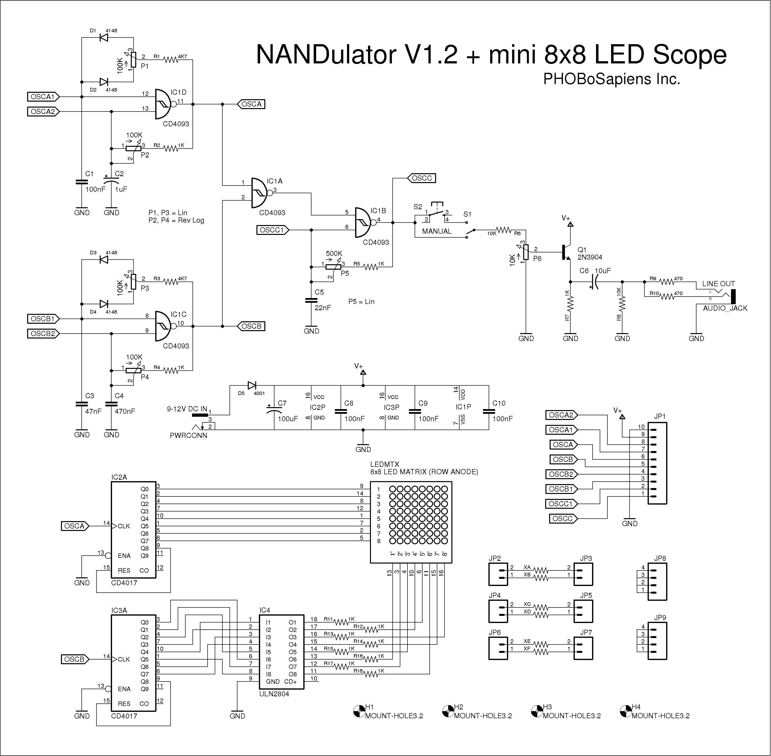

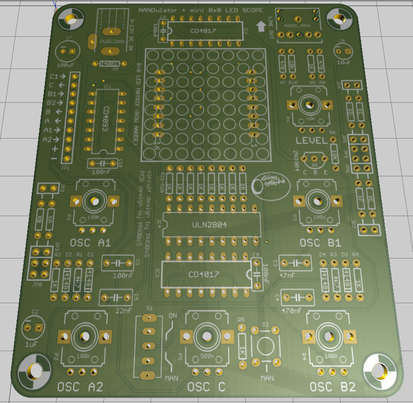

PostPosted: Fri Jul 15, 2016 2:55 pm    Post subject: Reply with quote  Mark this post and the followings unread
So here's what I have at the moment.
The NANDulator is the original configuration but with an improved buffered line out (inspired by Robert). It has a stereo 1/8" output
connector although the NANDulator itself is of course mono. This makes it easier to connect to stereo gear without having to use stacked
connectors or use a mono to stereo cable. A mono jack can still be used which will just short the right output to GND, this is the
reason there are 2x 470 ohm resistors in series connected to the outputs.
I also added a switch to mute the output and when muted a momentary button can be used to unmute. so you can trigger the sound
for short audio bursts.
For experimentation and extending purposes I added a header connected to pins 4,6,8,9,10,11,12,13 of the CD4093 and the power supply.
This way you could easily connect it to a breadboard and experiment with additional logic, or use it to patch multiple NANDulator together.
There are also some extra headers on the board with room for additional components. Most obvious components would be diodes but you
could also add extra timing capacitors or LDR's or maybe even vactrols to control the frequency of the oscillators. There are also 2 (shorted)
4pin connectors to use as a passive multiple.
The mini 8x8 LED scope is almost the same as the 5x5 version but with an ULN2804 instead of the CD40106 and of course it
has 64 LEDs instead of 25. It uses a standard 8x8 LED matrix.
Here's the schematic and a 3D render of the current PCB design.
edit: changed some of the resistor names in the schematic
PCB
 Filesize:  510.85 KB
 Viewed:  610 Time(s)
circuit diagram
 Filesize:  56.37 KB
 Viewed:  1060 Time(s)

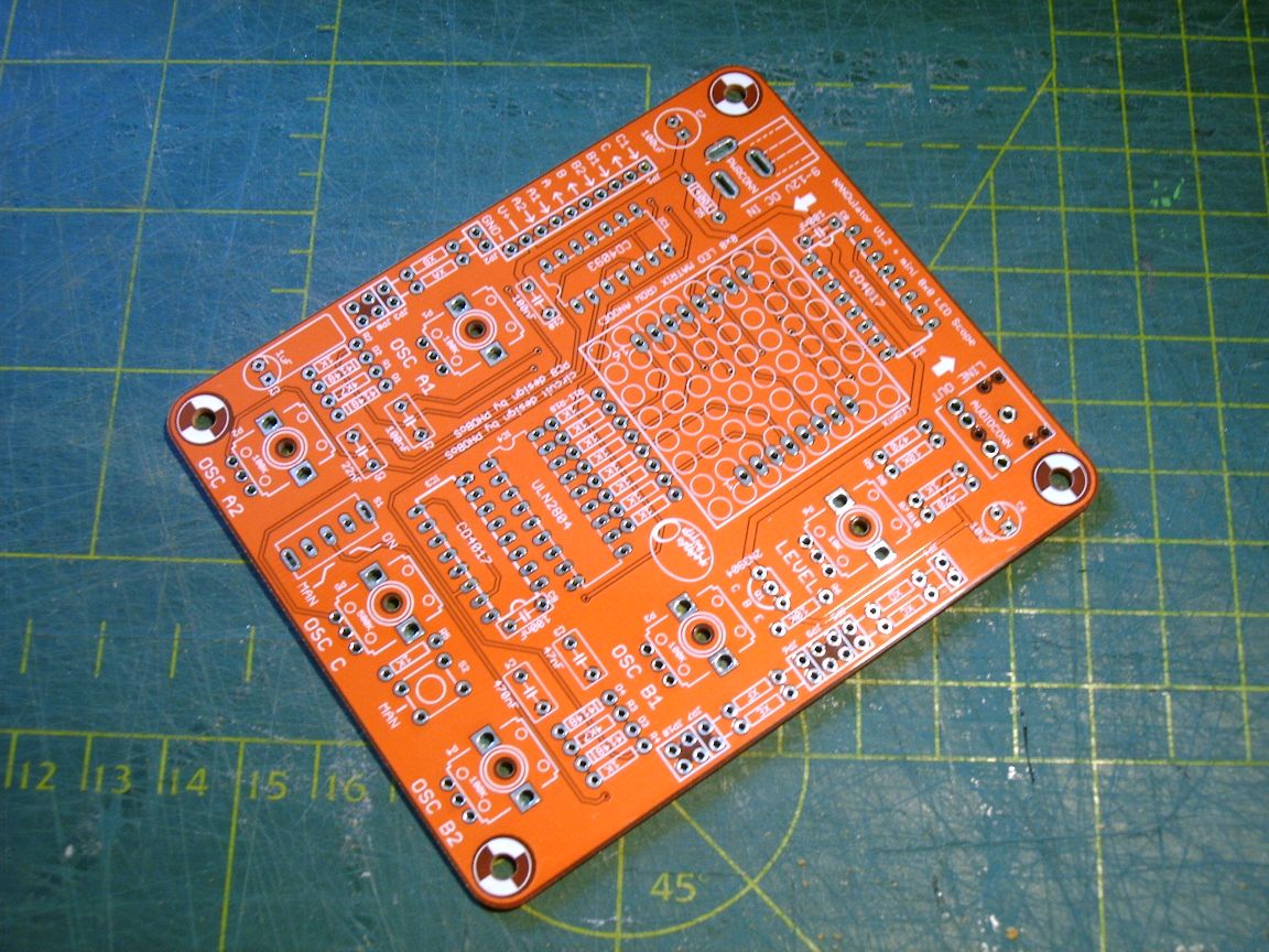

PostPosted: Sat Jul 30, 2016 4:55 am    Post subject: Reply with quote  Mark this post and the followings unread
just received the PCBs very cool
 Filesize:  215.01 KB
 Viewed:  565 Time(s)

PostPosted: Sat Jul 30, 2016 11:09 am    Post subject: Reply with quote  Mark this post and the followings unread
I'll see if I can make a video, I don't really have a good camera though and I am not sure how well it shows up on video because the LEDs
are basically multiplexed.
ok, so I just put one together and it works Razz
however,.. when I powered it up and twisted the pots I immediately noticed the same behaviour on the LED scope as I had noticed previously
with the 'faulty' chip: (diagonal) lines but no chaotic patterns.
I replaced the chip with the one I had recently placed in my other NANDulator and that indeed made a difference. So I just did some more
experiments with some other 4093 chips I have and here are my findings.
tested ok are: HEF4093BP (PHILIPS), TC4093BP (TOSHIBA)
tested not ok are: CD4093BE (TEXAS INSTRUMENTS), HCF4093BE (SGS THOMSON).
now it could be a coincidence and I would need more different types to test with but from those 4 chips both the BP ones work and
both the BE ones don't. Robert mentionend that the MC14093BCP (ON SEMICONDUCTOR) also works, but I have not tested that one
myself. However it does have a BCP suffix.
I recorded a short audio example to show the difference between an ok (HEF4093BP) and not ok (CD4017BE) chip. Both start with
pots P1, P3 full clockwise and P2, P4 fully counter clockwise and I twist P2 clockwise. I also made two (blurry) photos but because of the
multiplexing it doesn't show the lines very well. You can see a big difference though.
Basically the difference in the range of sounds produced by a NANDulator that doesn't properly NANDulate and one that does is this:
Laughing
So now I need to figure out where I can order some different 4093 chips to replace the ones I had ordered for the NANDulator kits.
edit: Just found some and with a bit of luck I might already have them next week
oh and I also discovered a mistake in the PCB design, nothing major but on the silkscreen for the pin header oscillator C has the in- and output
swapped. Embarassed
NANDulator with a HEF4093BP - OK
 Filesize:  169.38 KB
 Viewed:  580 Time(s)
NANDulator with a CD4093BE - not OK
 Filesize:  166.54 KB
 Viewed:  529 Time(s)
NANDulator chiptest.mp3

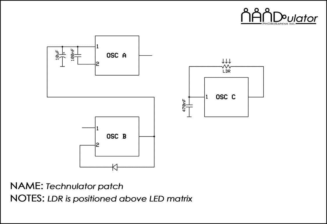

One of the things I did to create the track that I linked to in the previous post is use an LDR. It was connected across the frequency pot. of oscillator
C and positioned above the LED matrix. I did a couple of test with an LDR in combination with the matrix and in some cases it created a feedback loop
where if you moved the LDR the LED pattern would actually follow it Shocked.
This might be interesting for future circuits where a LED matrix is controlled by other logic. A binary counter instead of a 4017 would be worth testing,
but also just different outputs from a circuit directly connected to the rows/collumns. I also wonder what is going to happen when I'll test with multiple
LDRs and use them to cross-link NANDulators. Anyway it is nice that the LED scope already adds more to it than just some eye-candy.
Here is the patch I used for the NANDulator that does the rhythmic part.
