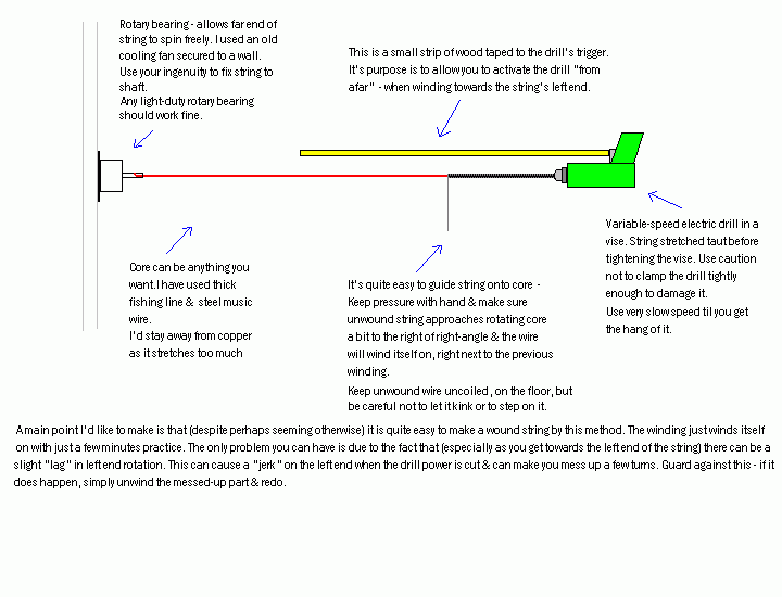

Coincidently Jurgen emailed me back from Trautonik's Trautonium about the trautonium strings. He is cutting back on his business and the strings he has in stock he is keeping as spares for his customers.
However gooooogling how to make your own wire wound strings I found this:
http://www.dennishavlena.com/make-stg.htm
which looks a bit scarey but apparently works. I think you would have to control the speed of the drill very carefully and I would make a speed controller but you can get lacquered constantan of various resistances. I would use lacquer to ensure the string didn't unravel and then use very fine grit emery cloth to remove the surface lacquer. This would maintain the insulation between wraps of wire but allow the surface to be conductive. (This is from http://www.analog-synth.de/synths/trautonium/traut.htm )
However, at the moment I don't have room to build a jig like this and four cats to get covered in lacquer!! A future project then.
