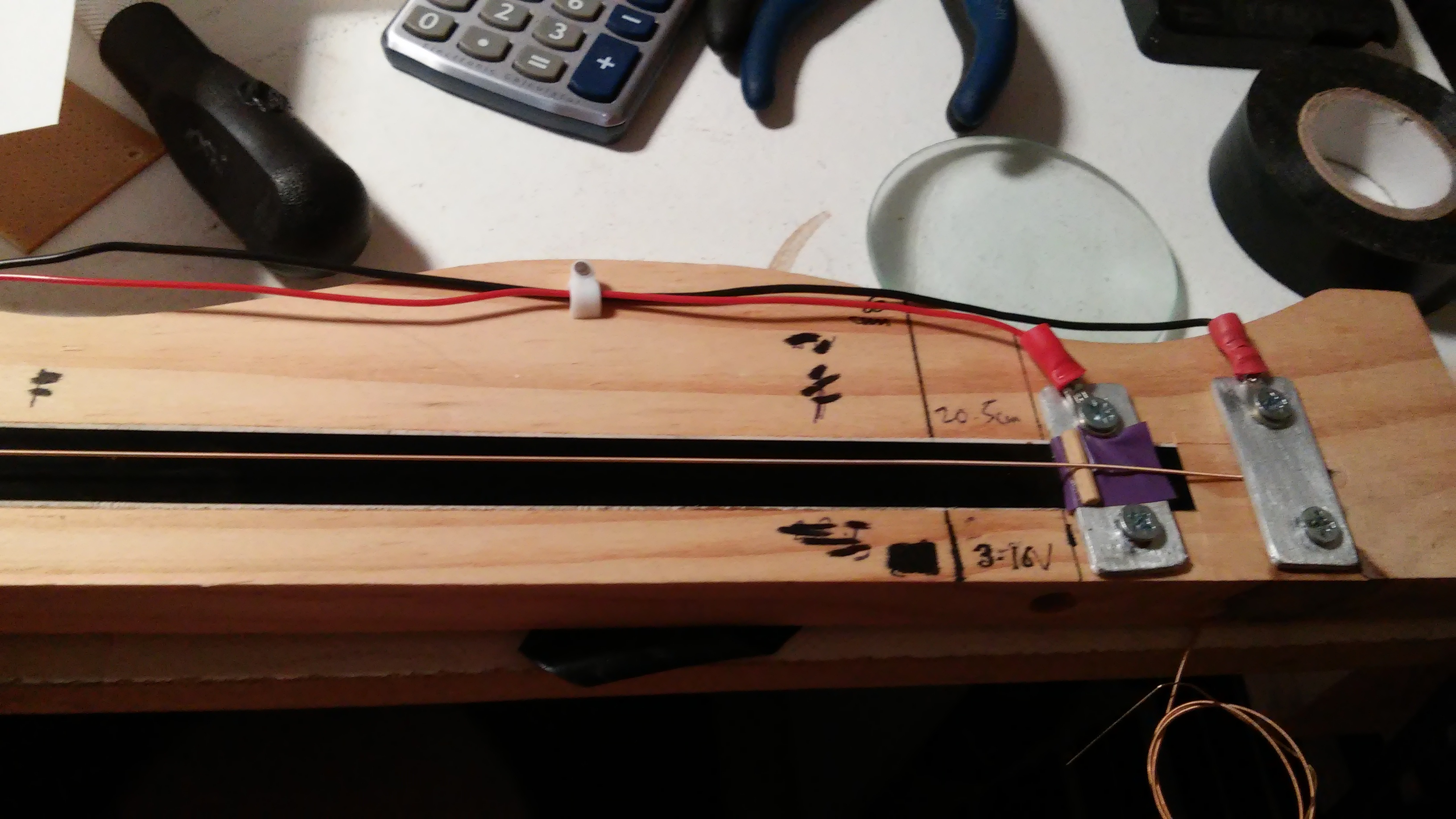

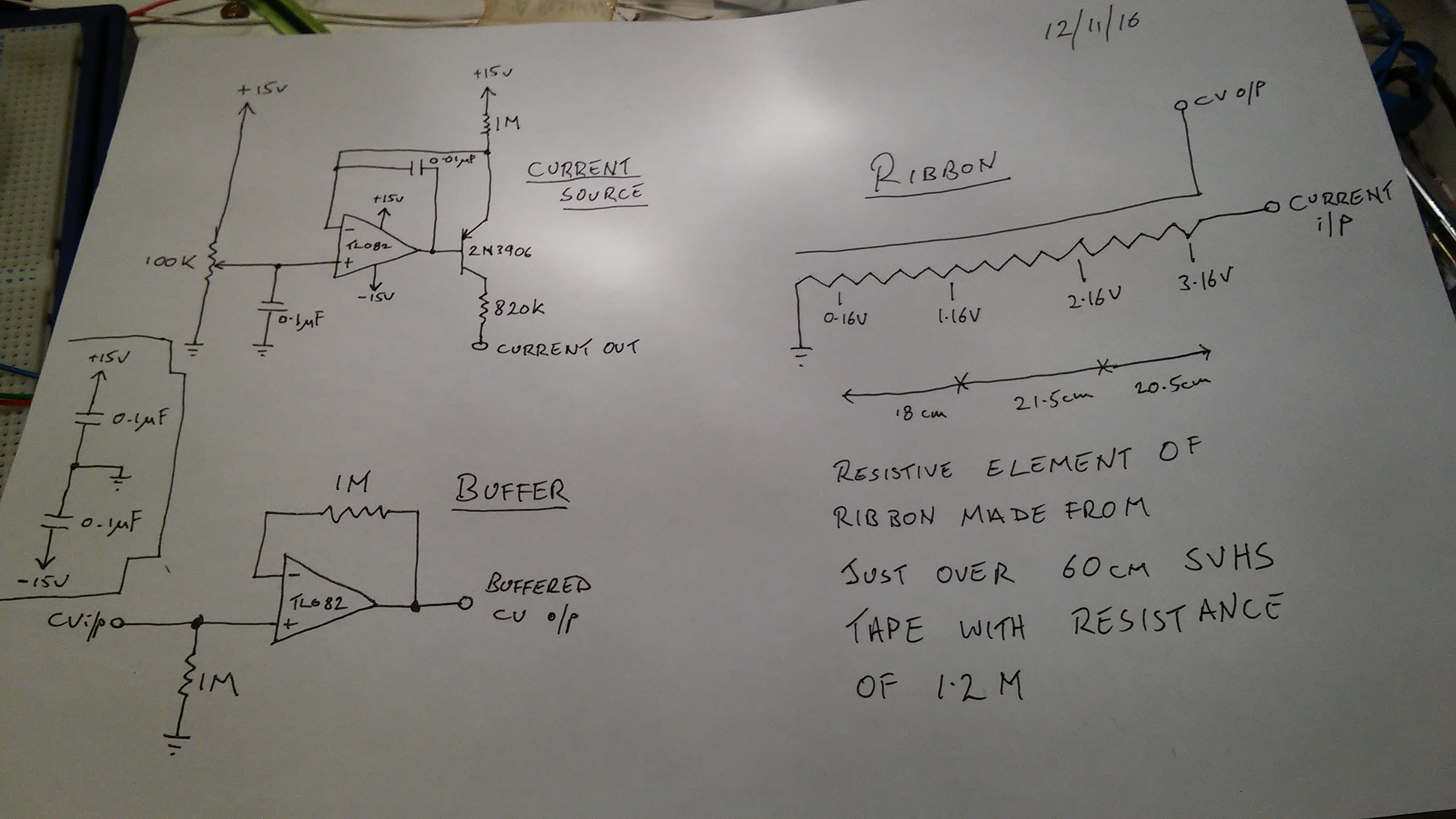

Hi All
hope this is still the right place to post potential stupidity.
Ok - been working on a ribbon controller using SVHS video tape with a resistance of approx 200K per 10cm. Using just over 60cm (1.2M resistance) of tape with a constant current source - 741 with a 2N3906 - to give 3V(ish). My lowest voltage is 0.16V - I can't get to exact zero as I have fat finger syndrome - with 1V increases at 17cm, 21cm and 22cm. Not quite a linear scale but better than I expected with such a high resistance ribbon. I'm very happy with the results - so far. I added the 820K resistor to smooth out the linearity a bit.
However, I want to buffer the output and that's where it gets weird. An op amp buffer, input to non-inverting input, link inverting input to output and voila! voltage follower. Except no. The output is way above the input. It tracks with the input but not in a linear way and outputs voltage even when the input is at 0V. I've used a TL082 and a TL071 and I've added caps and resistors in all the places searches suggest but it won't behave.
Some things:
Could it be down to the impedance of the ribbon material plus the 820K resistor? Is this too high to expect such a buffer to work?;
The mechanical construction of the ribbon - the ribbon material is electrically connected by sections of aluminium screwed down onto it. Could this be producing weird capacitances?
I will try with other op amps when I get the chance and also try a dual amp for the current source and the buffer. There is also a gate circuit and a sample and hold circuit to come.
Has anyone else ever had such a problem and how did you rectify it?
Thanks
Da Bear

First question is why have a resistor in series with a current source? A current source is high impedance, so no need for this resistor. Besides that:using this resistor will lower the span voltage of your current source.
Second is how did you measure the tracking? I can't figure out what the impedance of the ribbon controller is, but if its high ( several 100k's) and you are measuring with a scope probe of 1meg (or something similar) that is in parallel with the ribbon controller, it is obvious that this will f#ck up your linearity...

I don't have a scope so forget about 1M probes. I have a DMM and all measurements are from that - not ideal but you work with what you've got.
I did the maths, Iout = (Vsupply - Vref)/R2, after I had a think about what I wanted from the ribbon, which is three octaves with as linear a response as possible which I new would be difficult with such high resistive material. I measured the resistance of my ribbon at about 1.2M, from that calculated the current needed at 3V. I put that into the current source equation and solved for R2 which came out at 1M. I initially had a 2K trim in series with it but when I breadboarded it it did little if nothing. I tried this with the ribbon and got a squashed non-linear response with 0V to 1V at 9cm as opposed to something like 20cm on a 60cm ribbon. I remembered reading about adding resistance to pots to condition their response so tried it here and found by having the 820K in series with the ribbon it gave a more linear response with 0V to 1V now at 17cm - if you look at the drawing I made of the ribbon itself it will show the distance between the 1V increases. Ideally the response would be 0V - 1V covers 20cm of ribbon, 1V - 2V the next 20cm and 2v - 3V the final 20cm. I hope this makes sense!!!
As I said I'm happy with the results I got though a little unsure how I got them but my big problem is buffering the resulting CV. I've tried a couple of different op amps with the same results on each. When there is 0V on the non-inverting input the output is at 4V. When I touch the low end of the ribbon this drops to something closer to what I would expect, but as I move my finger up the ribbon the voltage increases but does not track the input, putting out much more than the input. I've used TL081 and an 071 with the same results.
I'm away this weekend so won't be able to play with it until next week but I intend to rebuild it using a dual amp and then using the second amp in the package to buffer the CV.
Thanks
Bear

At these impedances you would be picking up a lot of hum from your finger - which probably makes for some messy results.
Also with these impedances .. what is the input resistance of your DMM?
Your positional info seems off (roughly) by about 10% so my guess is that it is a 10 MOhm input on the DMM ...

PostPosted: Sat Nov 12, 2016 9:43 am    Post subject: Reply with quote  Mark this post and the followings unread
Hi
had a chance today to get back to this after a lot of googling and I think I've got it to work and work a little bit better. I read up a lot on op amp buffers and looked at other designs of ribbon controllers.
The first thing I found and hadn't thought about before is that when not touched the wiper is floating. Other designs have a resistor to ground for the wiper so I experimented there and found a 1M resistor does the job.
Secondly I read about op amp buffers sometimes needing a resistor in the feedback path to stabilise them and so I placed a resistor in the feedback path of my buffer. I also ditched the lm741 and used a tl084 in the vague hope that two amps in the same package might behave.
The result is that voltage out of the buffer is the same as voltage into the buffer. The current source is the same as I started with with the 820K in series with the ribbon.
Grumble - that resistance in series with the ribbon improves the linearity of the ribbon and including the 1M to ground on the wiper has also helped things along a bit. See the new drawing for positional info. Without the 820K the response was very non-linear.
Blue Hell - not sure what you mean by 10% off? The bottom/left hand end of the ribbon is at ground but because of the mechanical construction of the ribbon it will never read 0V so I chose a low voltage of 0.16V - which is the closest I can get to 0V with my fat fingers and the tension on the string - and then looked at where the 1V increases where on the length of the ribbon. Look at the drawing and the photos to see this. As for the noise, yeah it's there. I actually do own a toy oscilloscope (DSO 138 - kit £13 off ebay) and the trace is not smooth. I hope some sort of insulator over the entire string/tape ensemble will help that.
So next will be a simple sample and hold which will take up the two remaining op amps in my tl 084.
Perhaps cart before horse but I don't currently have an oscillator to put this to and of course the whole thing will be moot when my Spectra Symbol 50cm 10K softpot arrives after being on back order forever. However I've learned a lot through this process.
Thank you for your input.

Just wanted to say it was nice to see someone else post a hand drawn schematic. Thought I might be the only one who did that.
Nice looking project

Hi Cfish
yep I'm that old but I suppose that I will have to learn the software at some point.
At this stage it's hardly a project but more a learning exercise in current source design and ribbon controllers. I began with the SVHS tape because that's what I had and that's what I've used in the past for Tim Escobedos synth sticks. I know it's not the ideal material but I've kinda got something that I can make work for now. In fact yesterday I turfed out a load of rubbish and found a VHSC tape which is slightly lower resistance than the SVHS so I going to try that and see what I get.
Plus I like the look and feel of the guitar string arrangement which I stole from John Simonton's ribbon controller design (from which I will also steal the gate generator and sample and hold) as it feels a bit trautonium. I've even emailed Trautonics Trautonium to ask about the strings they supply - I assume something like a cello string wound with constantan. All I'd need then is a metal strip to press the wire onto and I'm away. Though I bet they're not cheap.
