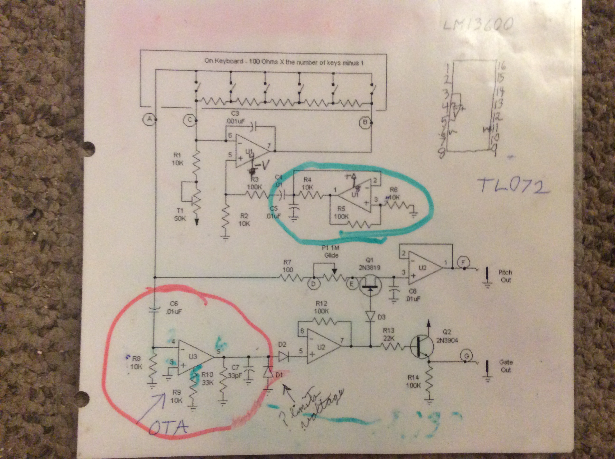

i finally managed to breadboard the CV GATE TRIGGER circuit we've been talking about.
It does work,although some tweaking may be needed.I'll now describe fast the procedure.
I used a CD4016 in place of the CD4066 the schematics calls for.I also used the TL084 instead of the TL074,That aside,no other modification took place.
Used 47 ohm resistor chain,one percent tollerance or better. for most of them i had a reading of 46.8 ohm or thereabouts. So,reasonably matched.
I got a CV output span from 1.1 V to 4.05 V, adjustable with the 10 K trimmer. The gate was around 11.6 V. Close to the values the schematics referres to.
I hope i got t right.How about yours? Smile

Hi Alanwilder81
Mine is working well. I'm running on 15v+- and using 100 ohm resistor chain. It has not taken a lot to make it work for my system. I am working with the top section and sample and hold section at the moment. Am really looking forward to the final gate and trigger circuits. I'm unfermilior with how the trigger is functioning. I hope I can understand it when I'm done.

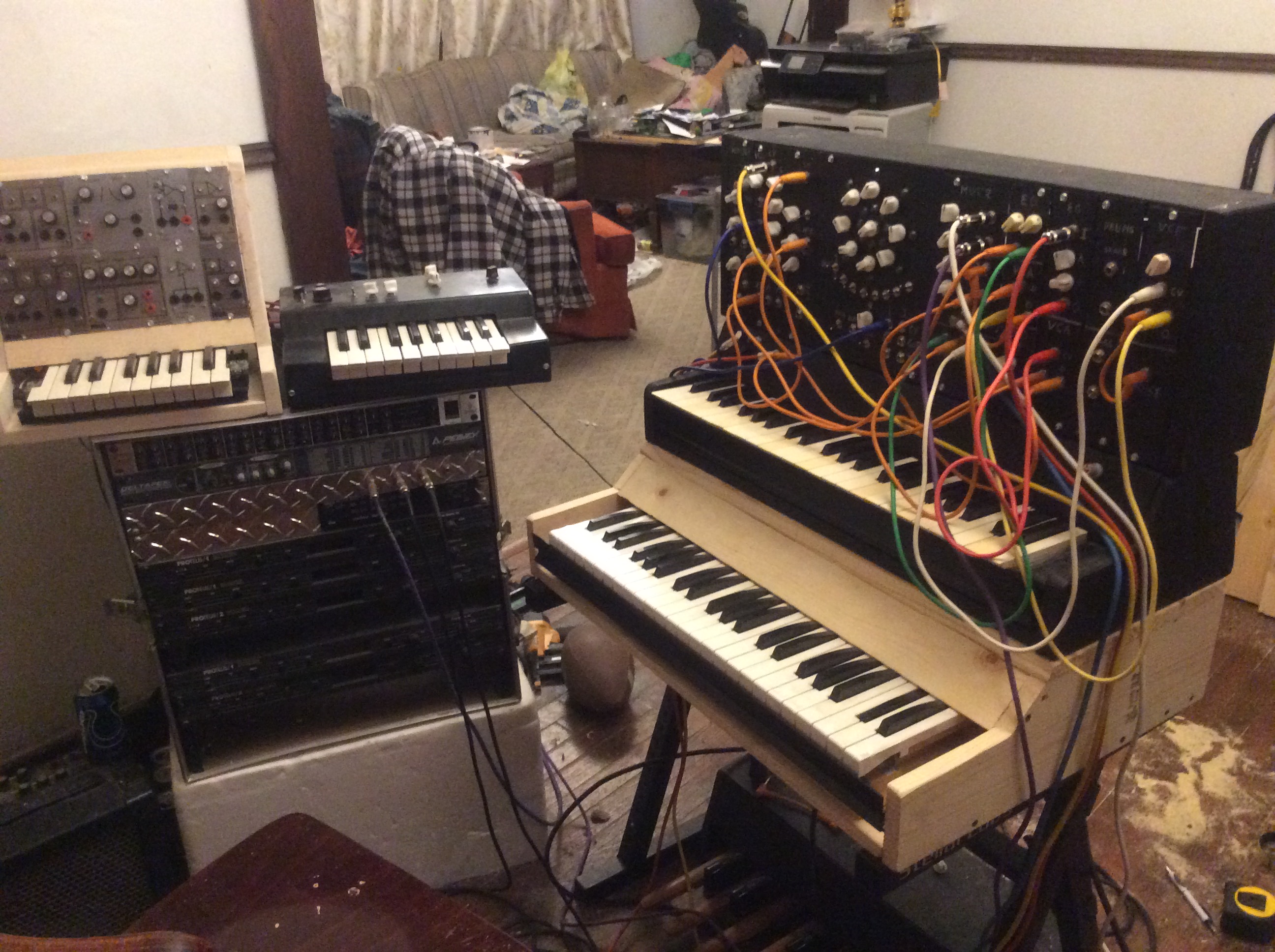

I intend on using this circuit in the keyboard I roughed together today. The top deck is the circuit I had worked with for a while, it has no trigger. Didn't realize how much I wanted trigger untill things progressed.
Figured if I roughed the case together, it might get me motivated to finish this project up.

hey Cfish Smile Smile
congratulation on the keyboards and especially the the bottom one bare wood.I think it looks awesome! Are you a carpenter if i may ask?
I also plan to build myself a case like that.Or even a small cabinet,dont know yet. i am still struggling with the electronics.
My keyboard circuit, as i said, outputs both GATE and TRIGGER as well as CV to drive the VCO's. Trouble is, i dont have the CMOS 7555 to build my VCO to test the keyb circuit rigth away. Only have ne555's at hand , but they are totally worthless for that matter.
as far as your setup, how do VCO's responde to the CV output? you able to get proper frequencies and scales? Did it take you some trimming?
i now have my circuit sitting on the bench ready to be tested with a vco, i may be better ordering next week the missing component to realize it

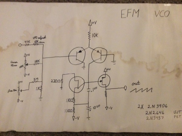

Here is a video link. Still have a small problem with my sample and hold circuit. It shows in the video. I have everything adjusted pretty well.
https://youtu.be/aR4tU0q65DA

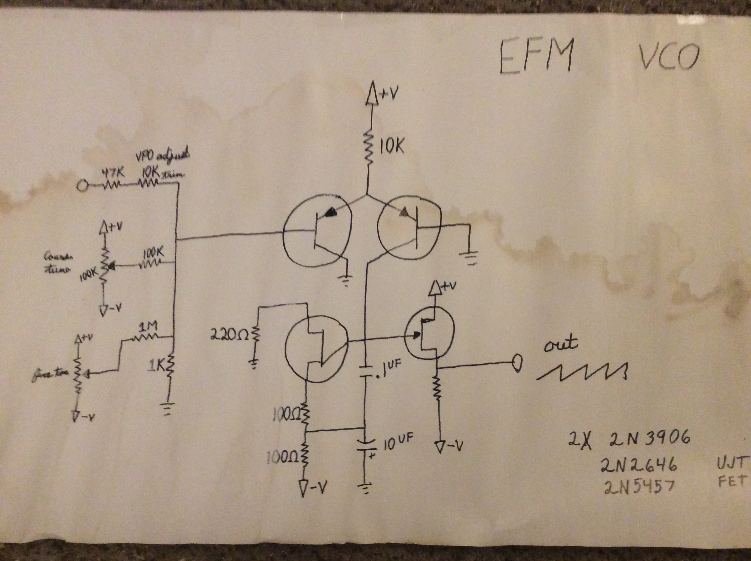

If you happen to have access to a 2n2646 UJT, you could build this quick VCO to test things with. It only tunes correct for a little over 2 octaves. It's what I use in the bass pedals in the video

To alanwilder81. Yes that is my circuit I had been working on in the video. Not the yusynth circuit.
Not really my circuit. Started out with an old EFM circuit that I could never make work. However the initial opamp with the resistor chain in the feedback loop seemed to track CV really well. So I just kept trying to build on it.
I will note that the bass pedals in the video are passing the VCO through a passive low pass filter. And a PT2399 delay circuit. There is a thread about that project on here. Think it's titled easy analog synth project.
2n2646 UJTs are available on eBay in the US. Normally come from the U.K. Not sure why that is.
I do have several extras if someone needs a couple. PM me

This is the EFM circuit that I could never get to work.
I want to figure out why?
What does the opamp circled in green do? Experimented a lot, makes no notable difference without it.
Never could get the OTA circled in red to do anything. This is the only project I have used the Chinese 13600s I bought in. They could be fakes.
Looks funny to me. The cap .01 blocks all but changes in voltage to the OTA. Which makes since for retrigering the gate. I just don't see how it can actually work, so I sort of gave up when it didn't.

yes Chris,
i remember you mentioning a project you couldnt get to work both GATE and TRIGGER of,hence giving up on it.is that really the case of a suspect counterfeit chinese chip lot?
Well, the only reason i haven't yet bought those CA 3080 or LM13700 off ebay is because of fear of scams Sad Sad .They are ridicolously cheap compared to the US or EU market but i definitely didnt feel like running the risk. I'm about to shell out the cash and get the bloody LM13700 off an italian seller,for around 1.50 dollars each. Not bad i guess Smile
Posts: 5947
PostPosted: Tue Nov 15, 2016 6:07 pm    Post subject: Reply with quote  Mark this post and the followings unread
ow that's easy, it's an ehm wait, what ?! scratch
The 0.1uF capacitor does indeed make some sense in triggering the S&H everytime a key is pressed, I don't know why an OTA is being
used there though especially in the way it is connected. And I would say the GATE out is actually a TRIGGER out. But the opamp you circled
in green ?, I can't make sense of it. Almost looks like a connection is missing but it is probably just a connection in my brain. Would be nice if
someone could explain it (the circuit, not my brain).
