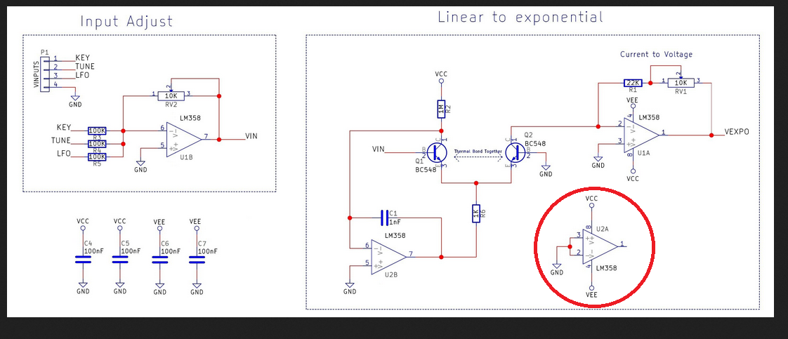

hey Chris,
i'd like to ask you another question regarding the third op amp used in the VCO schematic,that i circled in red. It's not quite clear to me how its connected.
Seems it has both inverting and non inverting input shorted and tied to ground scratch scratch
it's confusing me a bit

alanwilder81 wrote:
hey Chris,
That's just a way to 'disable' an unused opamp so it doesn't cause any noise. I usually just connect it as a voltage follower
(inverting input to output) and connect the non-inverting input to GND.

PostPosted: Tue Nov 15, 2016 6:49 pm    Post subject: Reply with quote  Mark this post and the followings unread
Thanks PhoBos
That's what I thought. Was.nice they threw in a diod or 2 to make it look useful. Ugh.

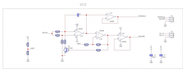

hello chaps,here the second half of the VCO schematic!
sorry but i cant seem to screenshot and paste more than one picture at a time ! Smile
so,it's a way to terminate an uncommitted op amp? good to learn! i would never have thought ! Embarassed Cool
thanks Phobos, thats priceless

PostPosted: Tue Nov 15, 2016 6:59 pm    Post subject: Reply with quote  Mark this post and the followings unread
My personal respons would be, that is a lot of parts for a VCO that isnt temperature compensated and is no more than it is. Almost as many parts as a Thomas HenreynVCO1 without the bang for your buck.

PostPosted: Tue Nov 15, 2016 7:06 pm    Post subject: Reply with quote  Mark this post and the followings unread
yes cfish,
it's very high parts count,almost ridicolous compared to other VCOs that are more minimal yet offer some means of temperature compensation.
But i want to get this together just to do a quick and dirty test of the Yves Usson keyboard circuit.
That aside, as soon as i make sure the keyboard is working right,i can disassemble the VCO. It's not meant to be definitve nor to go on my synth whatsoever !! Very Happy Very Happy

hello chaps,
update !
The above VCO works correctly,it outputs a wide triangle and square waves signals over a resonable frequency range. sounds ok.
i employed TL082 in place of the LM358 specified.
The schematics suggests to power the circuit with +- 5 V dual supply,but i wonder if i can power it with the regular +- 12 V i use for all my modules ! Smile
it'd save me the bother to hook up another extra supply just for this testing VCO Cool
Cheers !
Posts: 5917
PostPosted: Wed Nov 16, 2016 12:17 pm    Post subject: Reply with quote  Mark this post and the followings unread
I was going to say it should work fine on -/+ 12V since it doesn't have any reference to the supply (except for that fake GND) but if you use
a dual supply GND becomes V- and it does have the transistor and R10 attached to it. So allthough it will probably work you might have to
adjust some values. There is a way to find out of course Wink

great news is that today i was able to test the Yusynth keyboard circuit with the VCO we discussed earlier. Designed to cover 3 octaves, it did an ok job from what i see.I cant wait for others to get the same circuit done and compare the results Smile
As for that simple VCO, another noob question, so please bear with me help help
i am already driving the VCO with a dual +-5 V supply,so i dont get the point where you state ""but if you use a dual supply GND becomes V- ""
i wonder why the original design specifies only that low voltage when all synth modules get at least 12 v or more Shocked
Posts: 5917
PostPosted: Wed Nov 16, 2016 2:01 pm    Post subject: Reply with quote  Mark this post and the followings unread
The only place I see a negative voltage is on P3 which I assume is a connector. I don't see it used anywhere in the circuit itself.
So if you would power it with a dual supply you connect V- to what is GND now, and you connect GND to what is Vref now (you can leave
out those resistors). As for the low voltage, I don't know. Maybe a second set of regulators is used to create a more stable isolated supply
just for the VCO.
