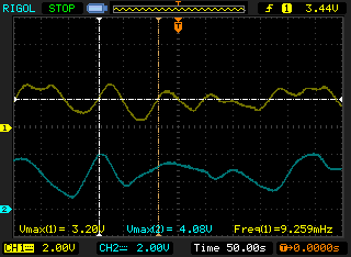

Bodged some 1uF MLCC caps onto the FRV board. I'm only missing those, and the vactrols.
The FRV board also works, tentatively. The right output is coming out, at any rate -- although so slowly, without the vactrols, that I had to set the oscilloscope to 50sec/div to get a display close to what you'd expect at 500ms/div. It isn't entirely verified yet, though, not until I get those vactrols.

It took quite awhile to get each of these screenshots -- look at the time division down the bottom.
