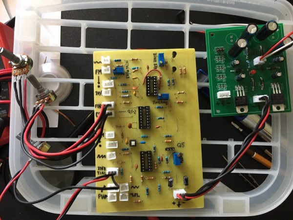

Subject description: It won't work, just silence. Has a voice when touching pins 5 and 7 of the LM13700
Hi everyone!
Has anyone any experience with the Thomas Henry LM VCO?
I breadboarded one after purchasing a copy of An Analogue Synthesizer for the 21st Century.
I double checked all soldering connections, ground and power as well. Everything seems proper. But it won't work, just silence. Confused
I couldn’t find LF444, so I replaced it with TL074, I also used 2N5457 instead of the MPF102. Maybe the LF444 and MPF102 is critical for the layout?
I also noticed that if I touch pins 5 and 7 of the LM13700 I can hear a signal out - for sine out is a sine, for ramp out is a ramp … etc… Fine and Coarse control pots do nothing.
Is anyone familiar with this, or has any idea why I'm getting these results?
Thanks in advance!

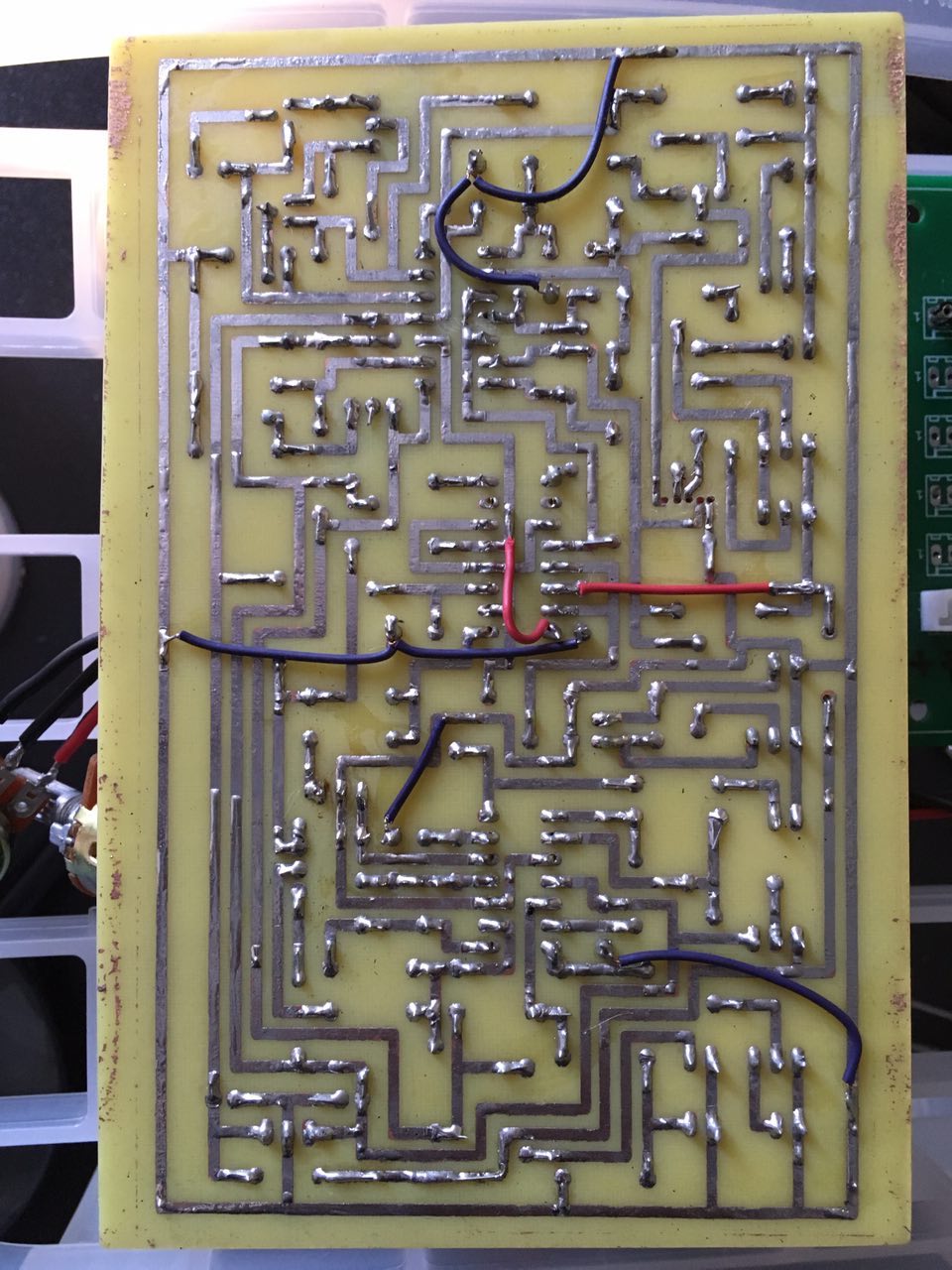

PostPosted: Sat Mar 25, 2017 6:16 am    Post subject: Reply with quote  Mark this post and the followings unread
And the PCB... it is without ICs, Q1/Q2 and Q5 Confused

PostPosted: Sat Mar 25, 2017 8:27 am    Post subject: Reply with quote  Mark this post and the followings unread
I found 2 problems with your layout, neither of which I'd expect to have anything to do with the issue you've reported Smile
1) you reversed the designators for R7 & R45. I think you have the right values rather than reversing them in your build, but there's not enough resolution on the top-side photo to be sure.
2) The sine round trimmer, R37, is supposed to have the wiper connected to one of the two sides of the trimmer. The symbol with the cross arrow indicates a trimmer that is wired as a rheostat, and it is common to tie the side and the wiper together on one side or the other. I don't think it matters a whole lot which side, it just determines which direction the adjust goes CW vs CCW.
Even if you swapped R7 & R45, neither of these should prevent all outputs.
I think the next thing I'd do is lift one side of R1 and see if adjusting the pots *then* will make that voltage go up and down. That completely disconnects the input section from the expo converter. If the problem is with the input then you still won't get any change, if the problem is with the expo converter or downstream it will start working at pin 1.
