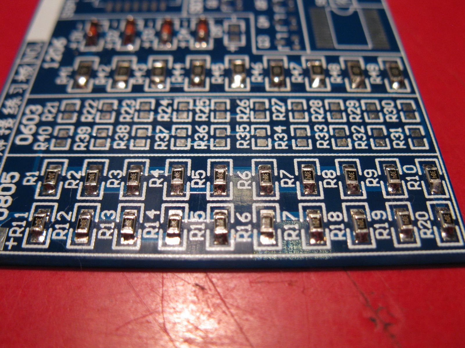

I think the 0805 resistors came out pretty nice. I am using the maginfier in my desklamp now which definitely helps
but also soldering slighly different. I first add a bit of solder to one pad position the component and tag it on then
solder the other pad. But what I've done different this time is that for the other pad I add flux and add a minute
amount of solder to my iron instead of to the pad directly. Sometimes the solder on the plated pads is even enough.
The 0603 resistors are going to be a bigger (or is that smaller) challenge of course.
(yes the resistors are upside down as I initialy thought it said 10E instead of 304)

I just tried the 0603 resistors and these are too small for what I would say is comfortable. Not that it is impossible it actually
went pretty well I think, but 0805 are a nice size for manual handling and soldering. With the 0603 it gets so small that
you quickly have too much solder and positioning is a lot harder. I am pretty sure the Braids PCB uses 0603 but they aren't
really designed for DIY. I also soldered on the LED which was actually a lot harder than I had expected and I really don't
like the solder joints on it. It looks like it is just sitting in the solder, but it works.

The final components have been soldered on too Very Happy These were actually rather easy to do, a lot easier
than the resistor arrays. I did one with the regular soldering tip and for the other one I used the knife
shaped tip. The knife shape works perfect if you apply just the right amount of solder but even if you
add too much and wick it away it works really fast so I can recommend it for these kind of chips.
Yes, I bodged the orientation on one, better be careful I don't do any of that stupid stuff on the Braids PCB.
 Filesize:  270.84 KB
 Viewed:  571 Time(s)
This side was soldered using the knife shaped tip with just the right amount of solder.
 Filesize:  247.19 KB
 Viewed:  579 Time(s)
