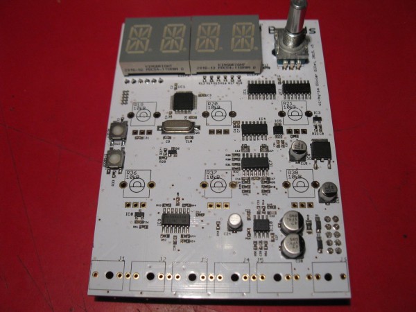

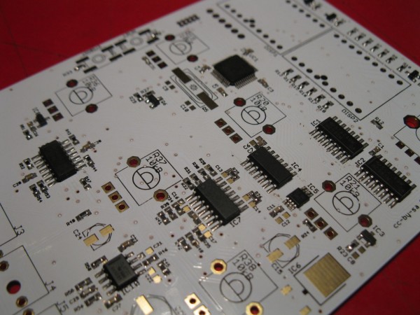

I have soldered on some more components. The solder pads are rather large so it's not too difficult.
11 small capacitors left and then some larger things. But I think it's time for tea.

PostPosted: Fri Sep 08, 2017 7:13 am    Post subject: Reply with quote  Mark this post and the followings unread
I finished putting the rest on the components (except pots/jacks) on monday night. Tuesday I spend a lot of time reading
through threads on muffwiggler again trying to understand the whole firmware flashing progress. I am pretty sure
I don't have the right device for it (yet) and while trying to install the virtual environment I ran into some problems, probably
because my computers are too old. However I don't think I need it as the .hex files are available which I should be able to
use directly. I just hope it'll work with winXP. In the mean time I ordered all the parts for Clouds and Rings which arrived
yesterday so I can do some more soldering if I want to.

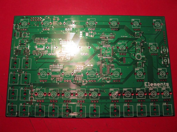

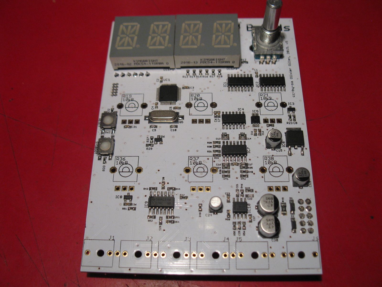

Another member of the Mutable Instruments family has been added because Alanp was so kind to send me an Elements PCB. Razz
Thanks Alan!
I noticed it has a lot of components placed close together which could be a bit of challenge. With Braids I already ran into the
problem that I couldn't get my tweezers between them which made placement rather tricky.
 Filesize:  334.91 KB
 Viewed:  582 Time(s)
Posts: 24613
Audio files: 316
PostPosted: Wed Sep 20, 2017 11:39 am    Post subject: Reply with quote  Mark this post and the followings unread
Pick & place machines use vacuum to pick up components, maybe that is an idea.
Posts: 5930
PostPosted: Wed Sep 20, 2017 12:53 pm    Post subject: Reply with quote  Mark this post and the followings unread
I actually have used a manual vacuum pick and place machine in the past (in school) which does indeed work nice. However,
that was with using solder paste. I don't know how well it would hold when you jam a soldering iron against the component.
It seems like there are some DIY options though so I'll look into it.
PostPosted: Wed Sep 20, 2017 11:41 pm    Post subject: Reply with quote  Mark this post and the followings unread
My usual tweezers worked fine with Elements -- I have a really cheap pair of eyebrow tweezers from the ladies section of the supermarket.
The only real trouble I have with the tweezers is when I start to get self-conscious and nervous, and my hands resultingly start to shake.

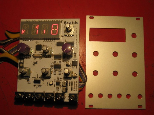

PostPosted: Wed Sep 27, 2017 8:05 am    Post subject: It's alive, ALIVE! Reply with quote  Mark this post and the followings unread
I received my ST-Link device today. It's a cheap one from ebay which according to a post on muffwiggler should work.
They are available in a variety of colors (which you can't choose) and I was hoping for a pink one which I got Laughing
I soldered up a cable and then realized that I had to reverse the connections because the connector is on the backside
of the board. So after doing that I connected the ST-Link device to my PC, which had no problem installing the drivers.
so far so good. I connected the cable to the Braids module and powered it up (no smoke, yes!) and ran the ST-Link utility
software. I was expecting some problems at this point as I kept getting errors when installing it, most likely because it is
not designed for winXP. But it started ok and 'connect to target' worked too. I flashed the bootloader and verified it (OK),
followed by the actuall firmware and after doing that I was greeted by the letter CSAW appearing on the LED displays. Shocked
jackson dancing
I don't know yet if it is actually fully functioning untill I solder the pots and connectors and I first need to make a frontpanel,
but it looks VERY promising.

PostPosted: Thu Sep 28, 2017 5:12 am    Post subject: Reply with quote  Mark this post and the followings unread
Thank you, I'll check it out Smile
I was already planning to search for a manual since there are some submenu settings besides the wave form selection.
edit: I noticed the order of the waveforms is slightly different and I don't have a HARM setting. Shocked I guess I have
a different firmware version, don't know if it's an older one. If I remember correctly it also needs to be calibrated.
(or was that a different MI module ?)
edit2: yep, it looks like I have v1.7. since the bootloader is installed updating should be pretty easy though.

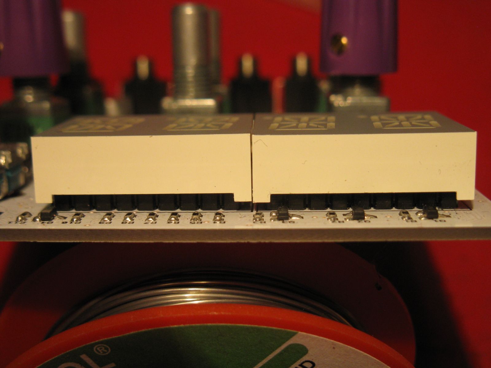

maybe a useful tip:
To raise the displays so they are closer to the panel I used
some pin headers, from which I removed the pins, as spacers.
 Filesize:  148.79 KB
 Viewed:  512 Time(s)

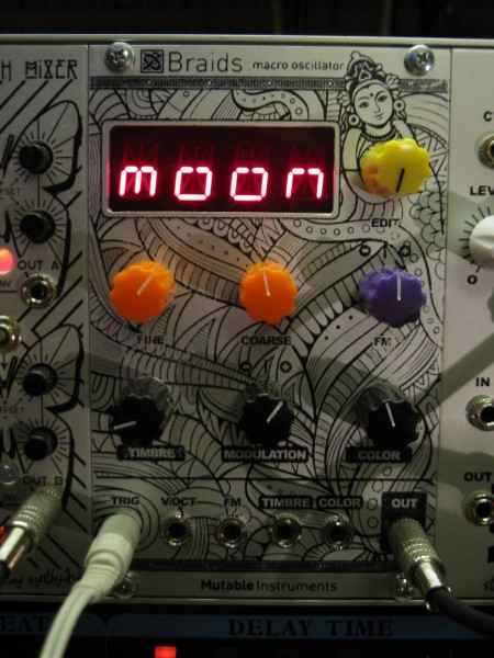

I just finished the toner transfer.
It might not be perfect but I think it looks pretty good. Cool
 Filesize:  312.78 KB
 Viewed:  530 Time(s)

Posts: 5930
PostPosted: Sun Oct 01, 2017 11:42 am    Post subject: Reply with quote  Mark this post and the followings unread
Here's a photo of the finished module with temporary colored knobs.
I've posted 2 recordings for which I used it:
Brain drops, keep falling out my head
PseudoRapidity
 Filesize:  261.98 KB
 Viewed:  508 Time(s)
